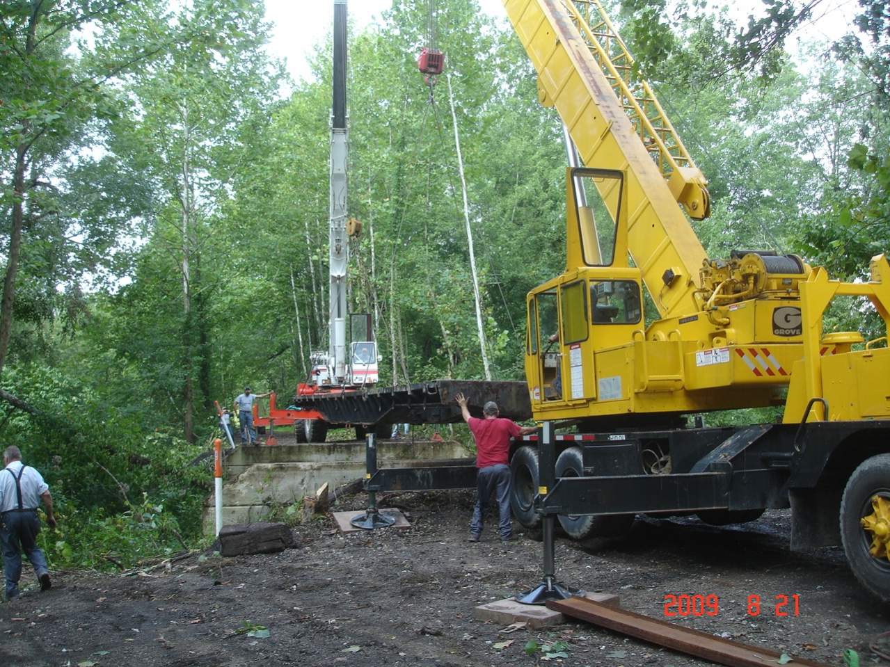

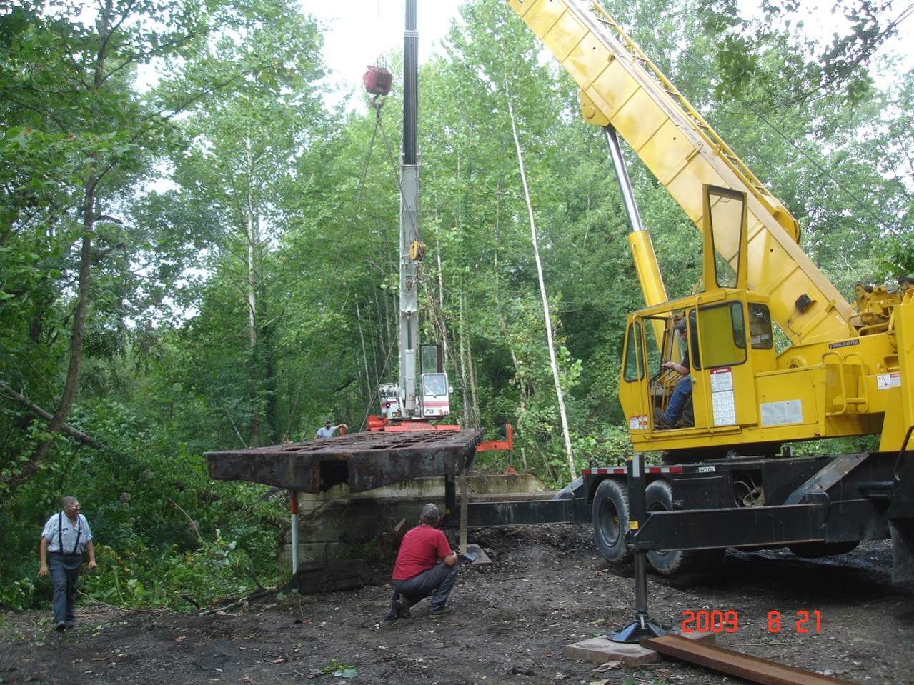

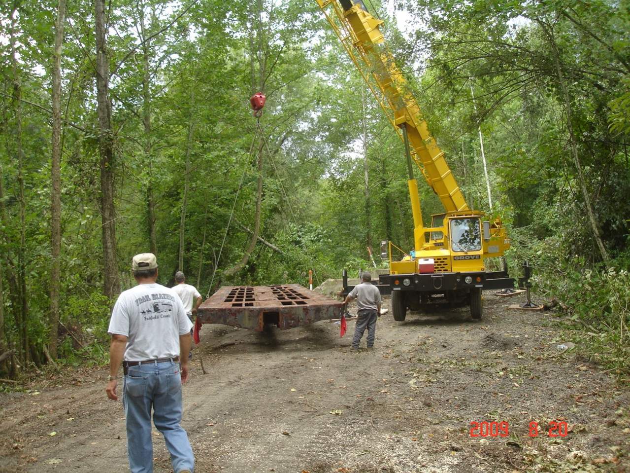

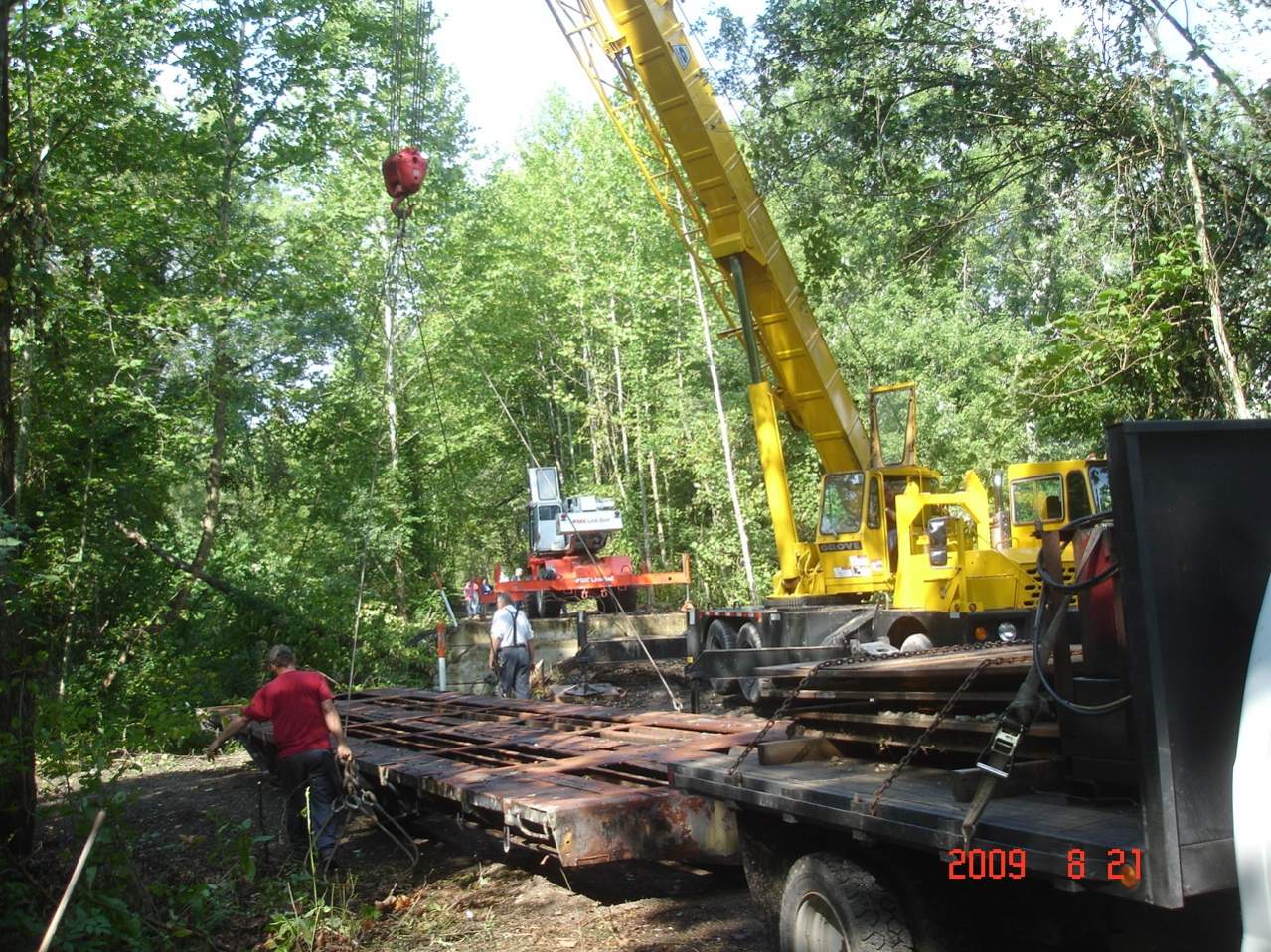

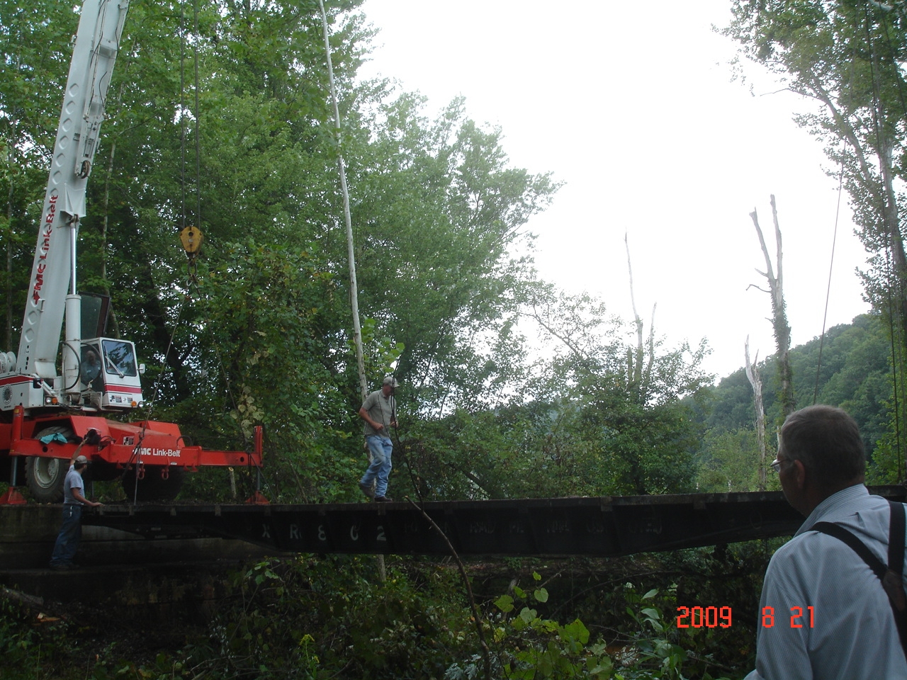

Here are a few shots of our first rail car arriving, and working on getting it in postion to set.

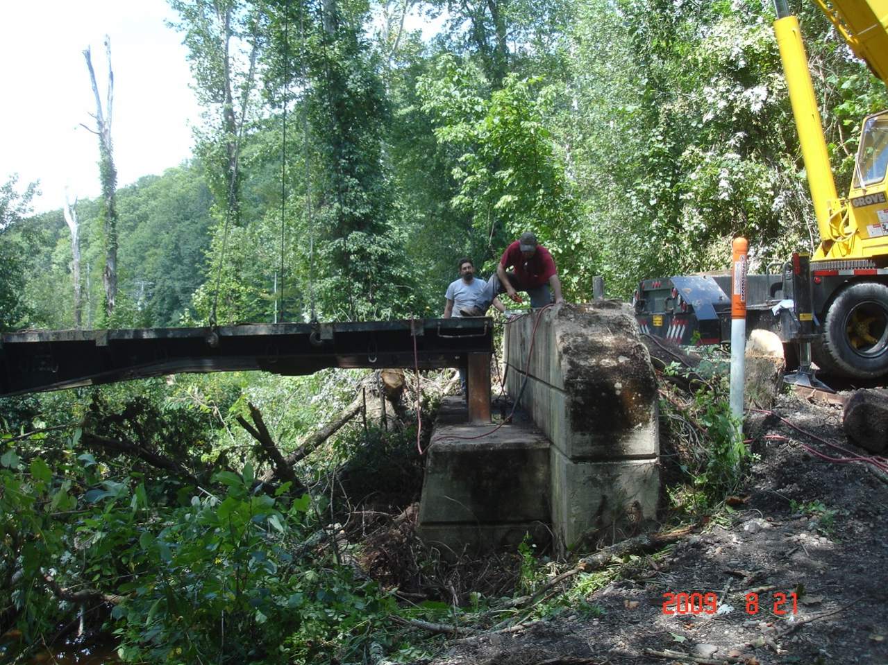

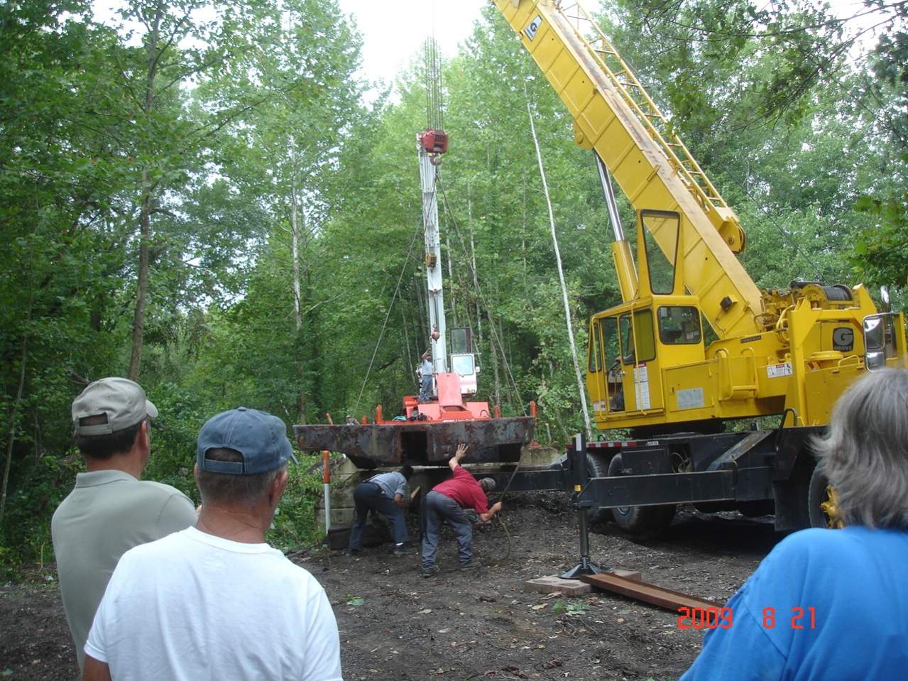

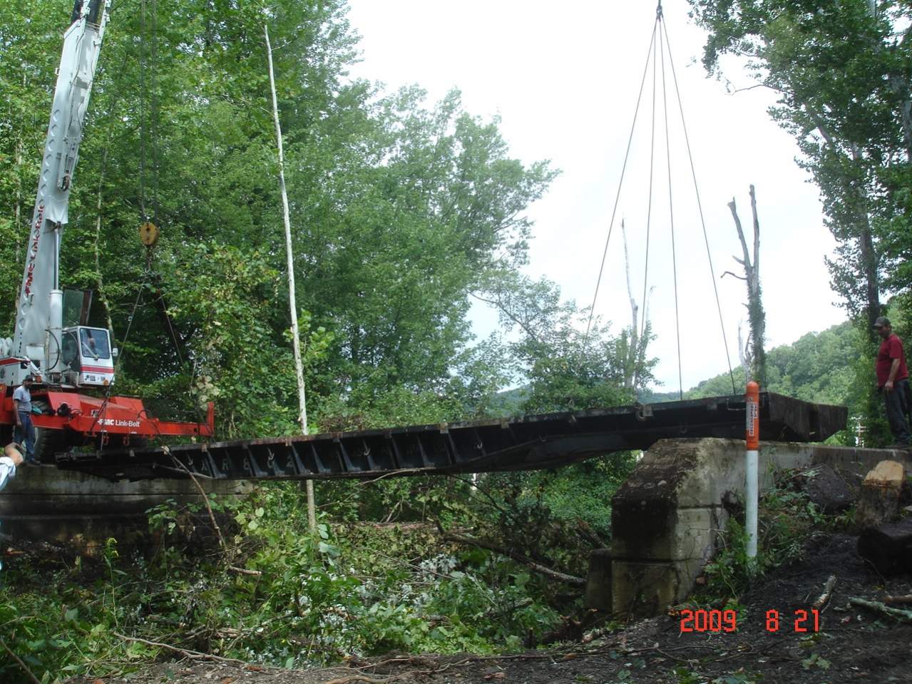

Here are some shots of swinging it in to position. The fellow walking across the car is measuring the distance on each end to the abutment, so as to get it centered.
We set it 2" below the top of the abutment, so as to allow for the 2" rough decking we will be installing, hopefully soon..!!

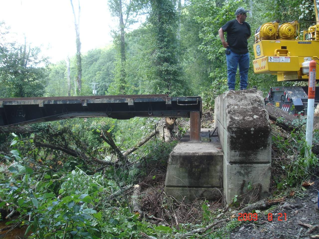

Then had to measure down to the seats on the abutment, for the length of the legs to be attached.
Luckily, the contractor had a piece of 8"X8"X5/8" wall square tubing laying around in the yard, to make the legs out of.

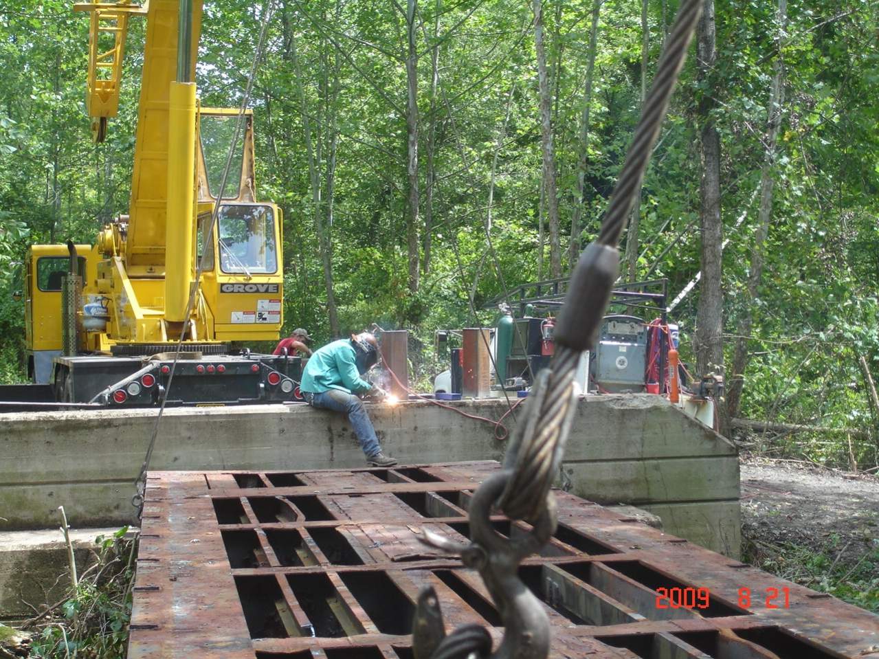

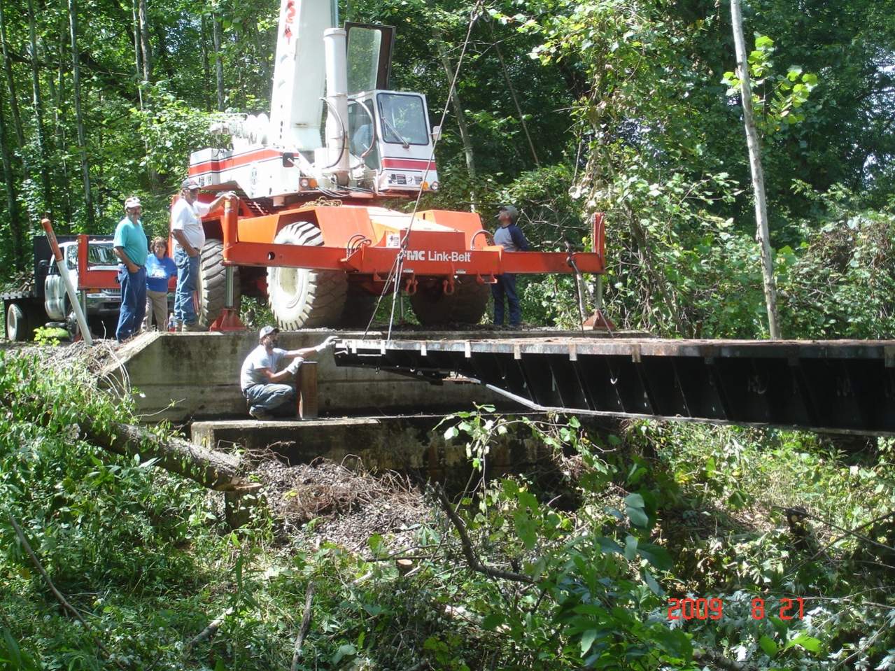

Here's some shots of the welder getting one of the legs in postion, and welding it in...
Wish now I'd have backed up, and got a picture of the complete job...
Oh well..., maybe when we put the fresh coat of paint on, and decking & side rails...
They did install another one about a mile from this one. They utilized 1 1/2 cars for this one. Haven't seen it yet....
We also have two more bridges donated to us from highway projects, as soon as they are replaced by the new ones...

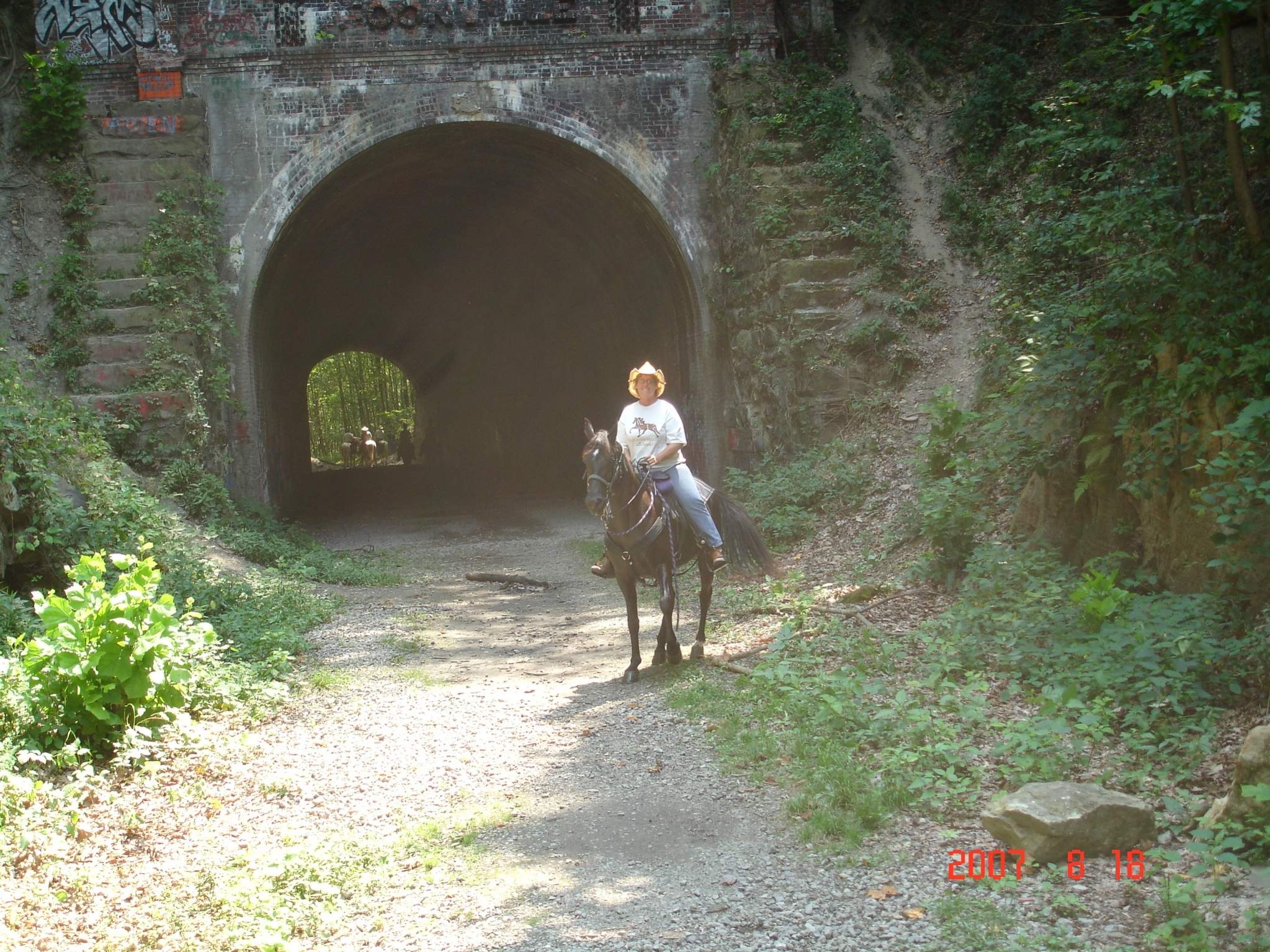

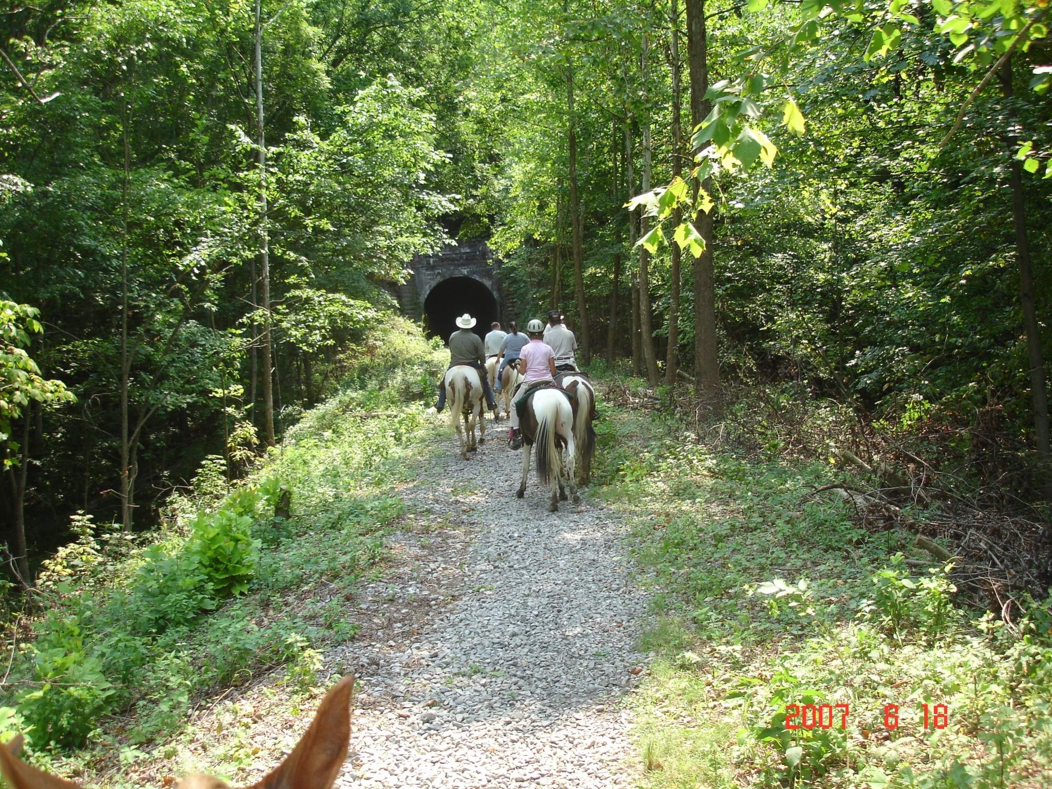

Here are a few pictures of the Moonville Tunnel. We make it a point to ride out to the tunnel at least one time, while horsecamping at Zaleski State Forest. It's an approx. 8 1/2 mile ride from the horseman's camp.
Note in the one picture, you can see "Moonville" laid in the brick face of the tunnel.
The one picture is of me, and my trusty steed enjoying a "cookie break" at the far end of the tunnel... We both love our Oatmeal Raisin cookies..!!
Local legend has it, that the brakeman in the above song lyrics had a tad too much to drink, and got caught in the tunnel when a passing train went through...
Other stories of people being struck by a train, on the nearby railroad trestle over Racoon Creek...
While riding there, or doing trail maintenance.. I have seen cars from as far away as N.Y. State, and N.J. along the Twp. road nearby, to take pictures of the tunnel.
