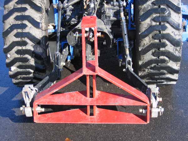

The following pictures show how the Pallet Lifter is installed in 3 parts.
Step #1 is the installation of the Howse Frame, see the attached picture. The frame is actually installed backwards when using the pallet forks so that the flat side faces away from the tractor. Normally the frame would be reversed so that the sub soiler blade and other attachements can be installed.

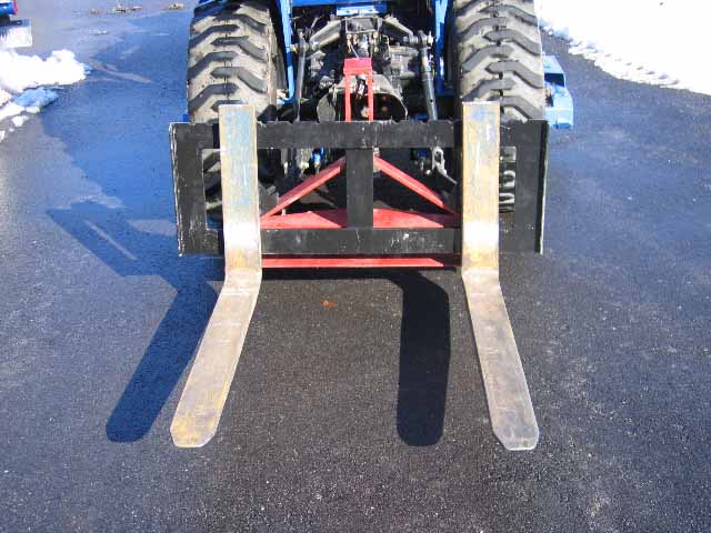

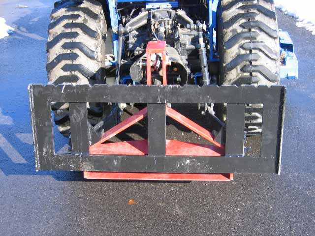

Step #2 is the installation of the newly welded sub-frame assembly that mounts on top of Howse frame. It is held secure by means of a top link pin.
   / Modular: Hitch, pallet fork, sub soiler, plow, etc
#13
Step #3 is the installation of the pallet forks. The sub-frame is built to accept standard pallet forks.
   / Modular: Hitch, pallet fork, sub soiler, plow, etc #14
Bob,
Nice job on the pallet forks. I'm sure they'll come in handy.

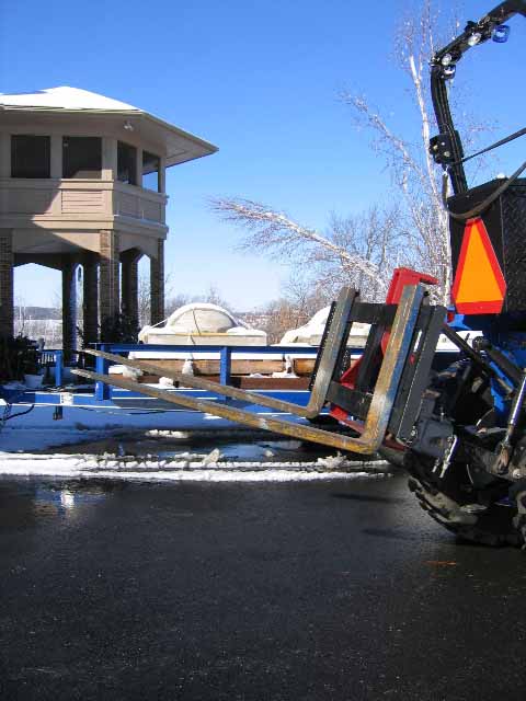

This photo shows the forks lifted in the full height position. While level at ground height, the forks tip up when lifted. A hydraulic top link would certainly make life much easier when using pallet forks on a 3pt.
I hope Santa is listening /forums/images/graemlins/grin.gif
The concrete planters on the trailer in the background are the first test for the pallet forks. They weigh a few hundred pounds and need to be placed on the porch in the far background.

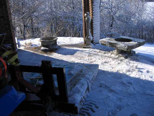

The planters come in 3 parts. A base unit. A bowl that sits in the base unit. And a very heavy flat top piece that sits on the bowl.
This photo shows the tractor parked on the porch with 2 of the 4 planters. The one on the left has the base piece and the bowl installed in it. The planter on the right is complete. I used the pallet forks to hold the flat concrete piece level with the top of the bowl and dragged the top piece into place. When it dropped down into the bowl I only crushed 11 of my fingers (a couple of them twice) /forums/images/graemlins/frown.gif
#17
Gene, thanks for the kind words. They sure are coming in handy today. I simply can't figure out how I would have accomplished this project without them!
The final picture shows the finished planter (now called the finger crusher) in its final position, with the tractor in the background. I will also say that I am happy to have a small tractor that has plenty of power. I can't imagine moving a larger machine around inside the confines of the porch! To put some scale to the photo, the planters are just over 38" across.

Nice job! A similar item just popped up on ebay. It incorporates a receiver hitch, pallet forks and a boom pole. Pallet forks are fixed, I think your design is better.
What carrys the weight on the forks? Is it just the pin or do the tabs on the sub-frame transfer some weight to the middle buster frame?
Rodger
