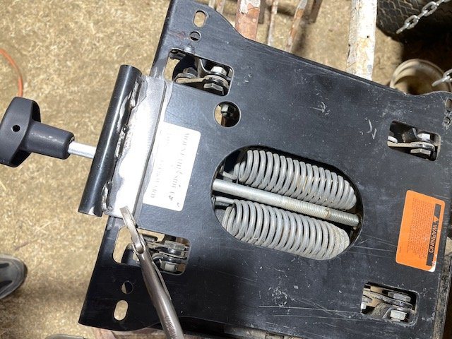

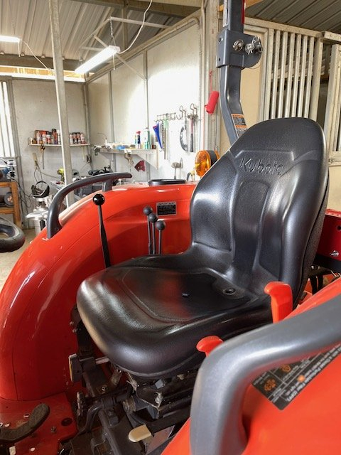

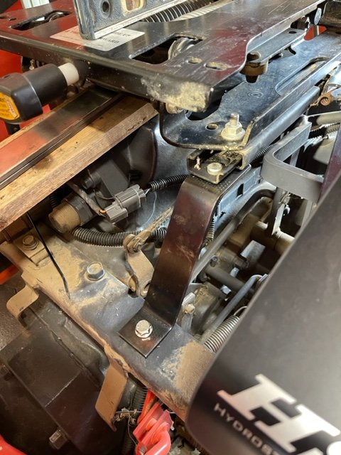

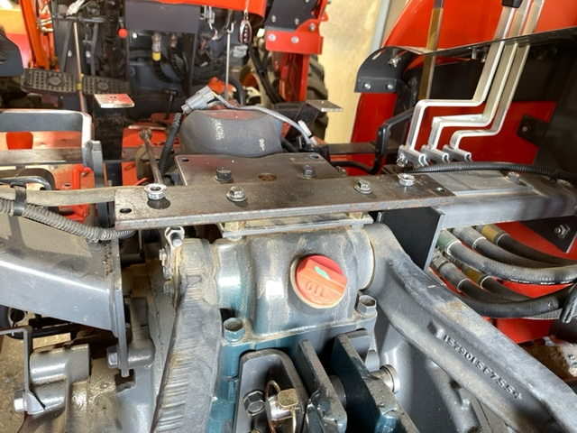

It sounds like my MX has the same seat. I used an aftermarket suspension unit. Which increased the height 1-1.5 inch and offered a true adjustable spring setting.
It was more work than I thought Because I tossed out the OEM seat mount and basically started from scratch. It was not that difficult but the front mount (2 bolts) was lower than the rear 2 bolts. Which made the mount not easy to figure.
But I like it, I got a seat that is further back, more adjustable, and higher. Oddly but not completely surprising the new seat position made reaching the controls and steering wheel more difficult. But that was another topic.
