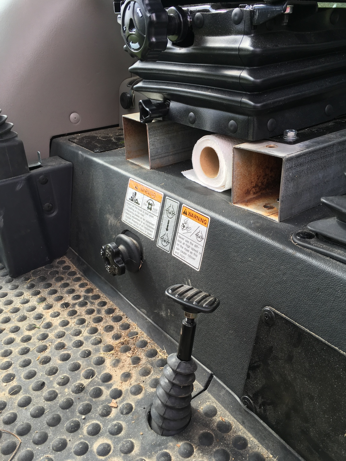

This worked for me. Up 3”and back 2”.
/ modifying the M comfort seat? #5
yes i'm thinking that 3" would be about right the 5100 series has more room behind the steering wheel. how did you modify your seat? Photos?
what air seat did you get? I really like the new M comfort seat with the arm rests but do need more weight adjustability (or lose a lot of weight)
Modifying the seat was easy. Took two 2" rails running front to back, drilled them in the same bolt pattern and inserted them under the seat.
When I got the suspension seat, it was already 2"+ taller than the old one, so I removed the old rails. The suspension seat you get will be determined by how much clearance you have between the lever controls on the sides of your seat. I have levers on both sides, so I had to find a seat that would fit in-between. Probably narrower than what you have available to you.

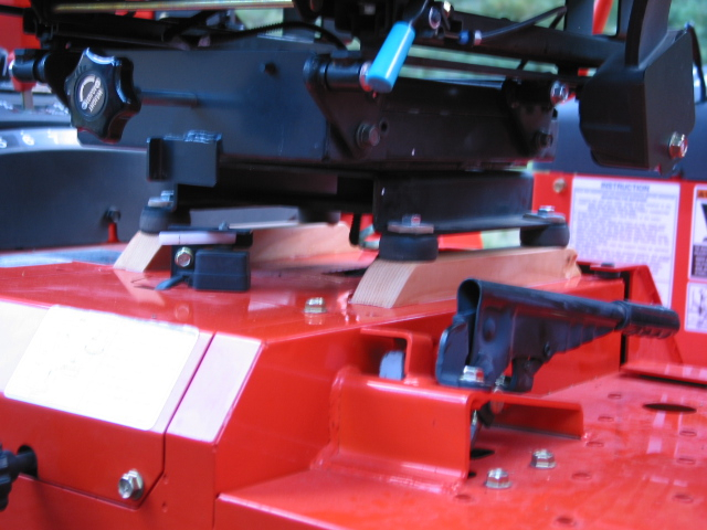

Here's what I did. To keep the seat from bottoming out I simply adjusted the knob at the front of the seat to pre-load the spring. I'm a six feet tall and weigh 190 lbs.

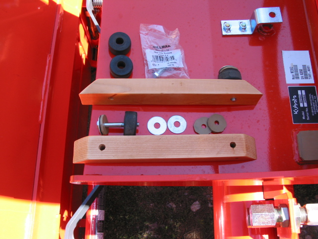

rScotty
