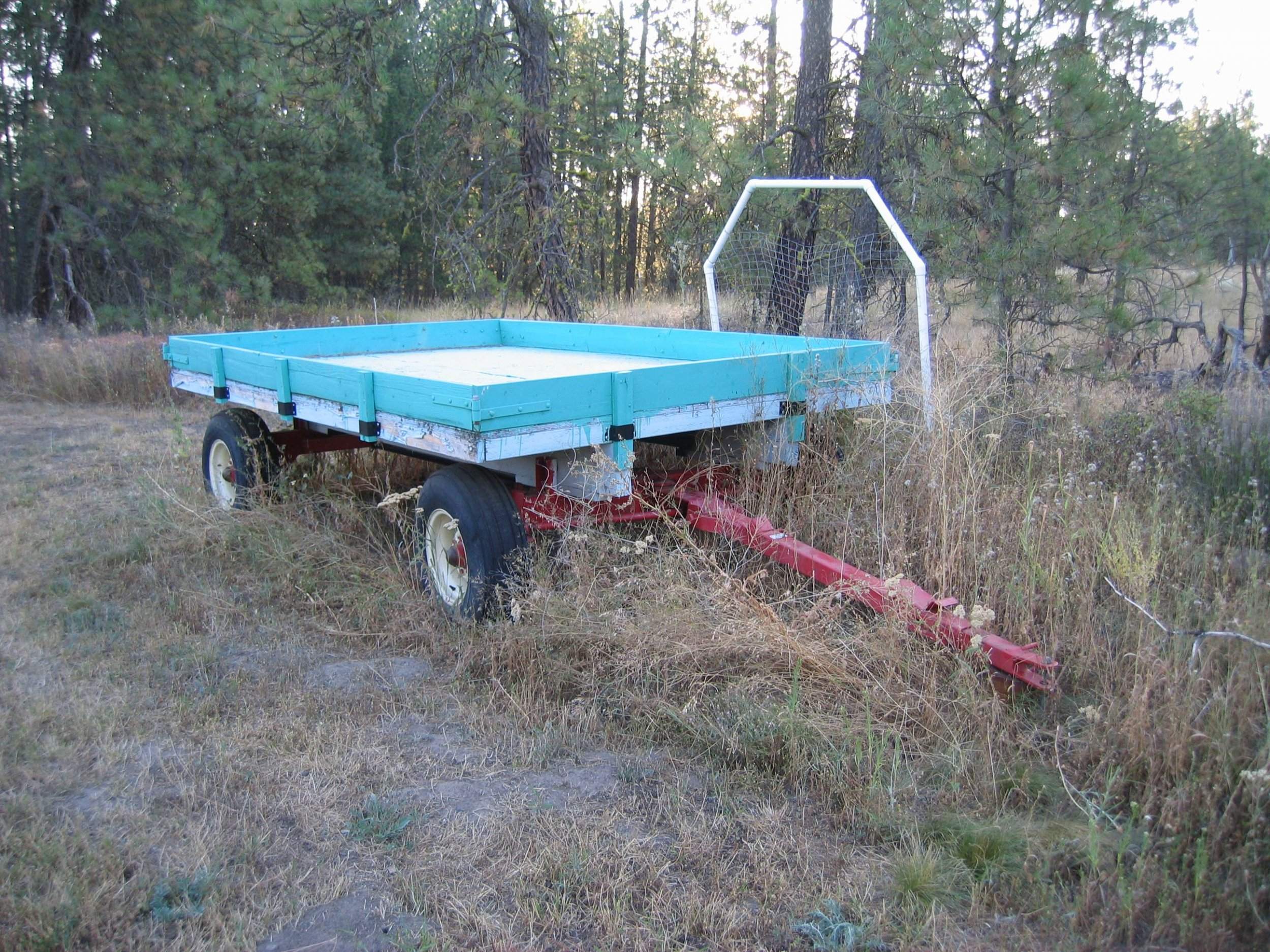

I rebuilt an old David Bradley 4T hay wagon running gear. Wheel bearings, painted wheels and frame, added all new wood.
It has the original tongue which is OK but has the large hole for hitching which is too large for use of most drawbar pins and too sloppy using a clevis.
My wagon will be used mostly to move lumber and wall logs to a remote, cabin self-build site from my sawmill and I need a better coupler setup. I have both a straight pull drawbar and a 3pt hitch drawbar, but 2" balls on my straight pull bar.
As we speak, my thoughts are focused on welding a 2" trailer ball coupler onto the tongue end.
What say you for this situation?

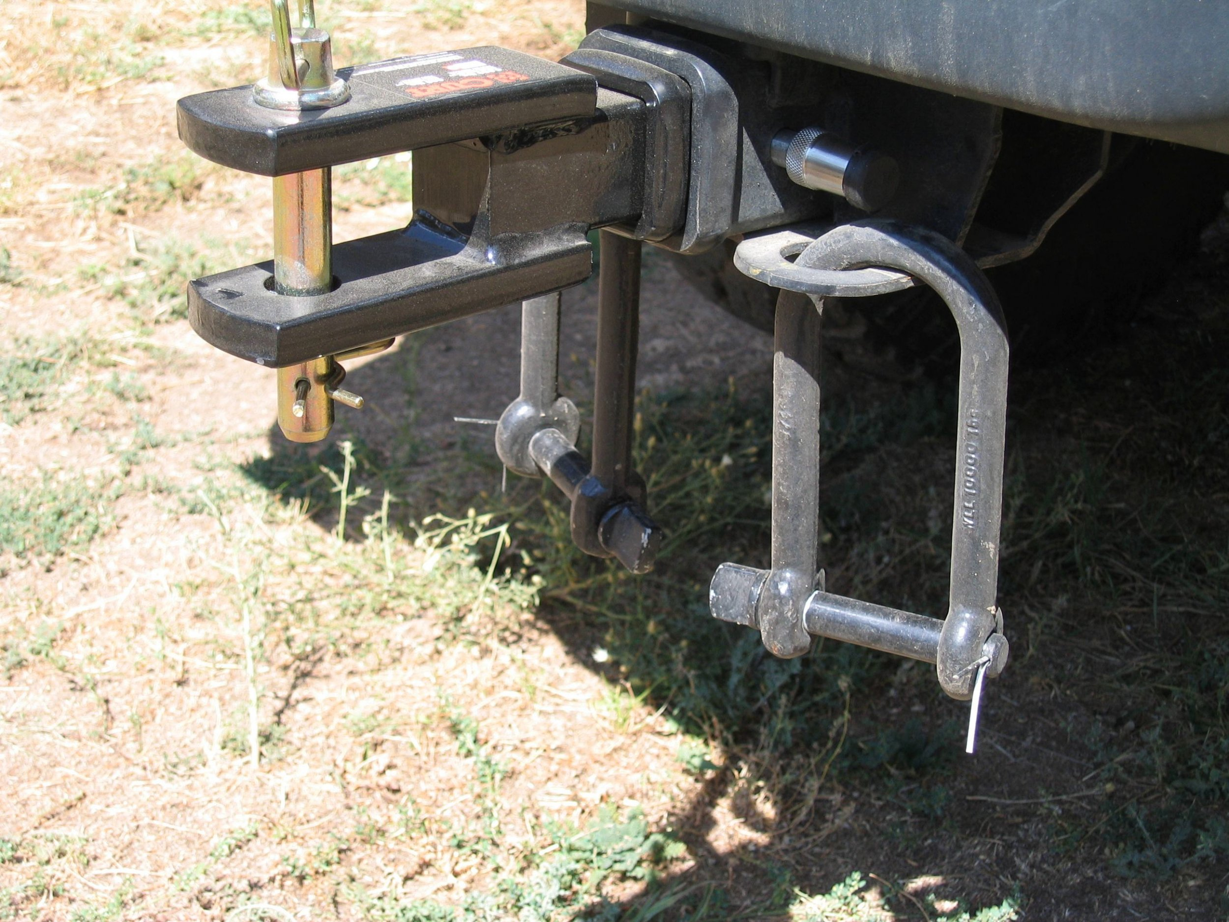

I built my farm wagon from brand new Horst running gear. It's their ten ton model. You can just barely see the hitch on the end of the farm wagon tongue. So - I show you the hitch on the end of my pickup. It's exactly like the hitch on the farm wagon.
I considered a ball hitch but decided on what you see. Dragging my farm wagon around my property means a whole lot of - up/down and twisting. The hitch I have works a whole lot better in my situation. I pull the wagon with the straight pull drawbar on my tractor.

I wouldn’t go to a ball hitch, they really don’t like the types I’ve movement you get with non-suspension vehicles. Pintal would be the best bet if you want to go to a hitch system IMHO.

I'll be towing with some angles involved, but not such that a ball doesn't work as my Gatormade utility trailers been everywhere this wagon will be going. The issue is the wagon has an undamaged OE tongue end which has a very large hole such that as I stated, no pins large enough to not jiggle around so much as to make back even harder than it should be. I'm experienced and don't need instruction on backing one either.
I know pintles as I'm 10 plus army years & a motor sgt last time around.
Thanks for the responses but I'll stick with a ball coupler.

it's Pintle hitch but I know what you meant. I have them and ball hitches as well With a Pintle, you still need a Lunette eye to complete it.

I'm buying a $15 2" ball coupler x 3" wide which has bolt holes in two directions so a cheap, easy adaption that can be reversed back to original. I've already got too many various hitch gizmos all ready.
