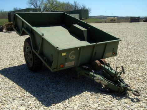

Hi all. Ive lurked here off and on for a few years, Lots of great info.
Ive searched for a few hours now and cant find the answers Im looking for. Im getting a m105a2 military surplus trailer in a few weeks and need to modifiy it into a dump trailer. The questions I have are: 1. Ive seen to different ways of mounting the cylinder, one way with the cylinder from the frame to the box and one with the cylinder mounted to a sissor (spelling?) type frame inbetween the frame and box. Its not a big trailer and I dont intend on loading it heaping over with dirt or gravel, Is mounting the cylinder from the frame to the box strong enough? Is there a way to figure out how far forward or back the cylinder can be mounted?
The pics are of the trailer like I want to build and of the trailer Ill be using.

I would say a lot depends on how the trailer is assembled. It is far better to design a dump trailer from the beginning as such. A dump trailer is a dump box on a strong trailer frame. Most trailers not designed to dump, incorporate the box as part of the frame to save weight and materials. Converting one of these to dump can require a LOT of work and re-design of the frame and box to accomplish this.
The scisors framework lift design allows you to use a shorter stroke cylinder, and less hydraulic fluid, so a smaller resovoir is required. The scisors framework also more precisely controls the travel of the box and the forces applied to the cylinder. Fully extended cylinders can be damaged by uncontrolled side forces. The trailers that use a single cylinder and no scisors framework require a very long cylinder. Any flex in the box from uneven loading can put large side loads on this cylinder, so a very stiff box and pivot point are needed to keep from damaging the cylinder.
When converting something to serve another purpose, I always find it best to either draw the original into my CAD program, or build an Exact scale model. The CAD program is of course much less work, and easier to modify. You have to know where you are, before you can decide where you need to go... Once I have the original mocked up, Then I can experiment with different ways to achieve my end result, and get my brain around all the variables involved with the project.
Good luck with your project.

I agree it's much easier to design and build a dump trailer from scratch. Although modifying an existing trailer to function as a dump trailer can be equally rewarding.
Personally, I would go with a straight hydraulic cylinder lift mechanism vs a scissor lift due to simplicity. "Will mounting the cylinder from the frame to the box be strong enough?" I seriously doubt it. The cylinder mounting points will need to be beefed up where it will withstand the maximum force available from the cylinder for a safety / failure factor of at least 2-3X the force of the cylinder. Additionally, the cargo box will most likely need to be stiffened up so as to support the weight of the load between the rear pivot hinges and where it gets lifted by the hydraulic cylinder (so it doesn't fold in half when being lifted).
"Is there a way to figure out cylinder placement?" -It depends on the weight being lifted, total angle of lift, bore and stroke of the cylinder, vs the available hydraulic pressure, unless your a genius at trigonometry and calculating mechanical force, it's basically more or less trial and error. First determine what angle dump you want, (45* is a good rule of thumb for a dump trailer). Then find out how much space you have to work with to determine the retracted length, stroke and bore of the cylinder. Hint - over kill is the rule of thumb here. The lower and more forward the cylinder is away from the rear pivot hinges will give the best mechanical advantage. I used two 2.5" dia 16" stroke cylinders - one on each side, or it could have been done with one 4" cylinder in the center. I opted for two cylinders to spread the load and forces over a wider area.
If you need help determining exact cylinder placement, bore and stroke....Post some pics and dimensions when you get your surplus trailer taken completely apart, then we can all take a look at it for a better assessment.

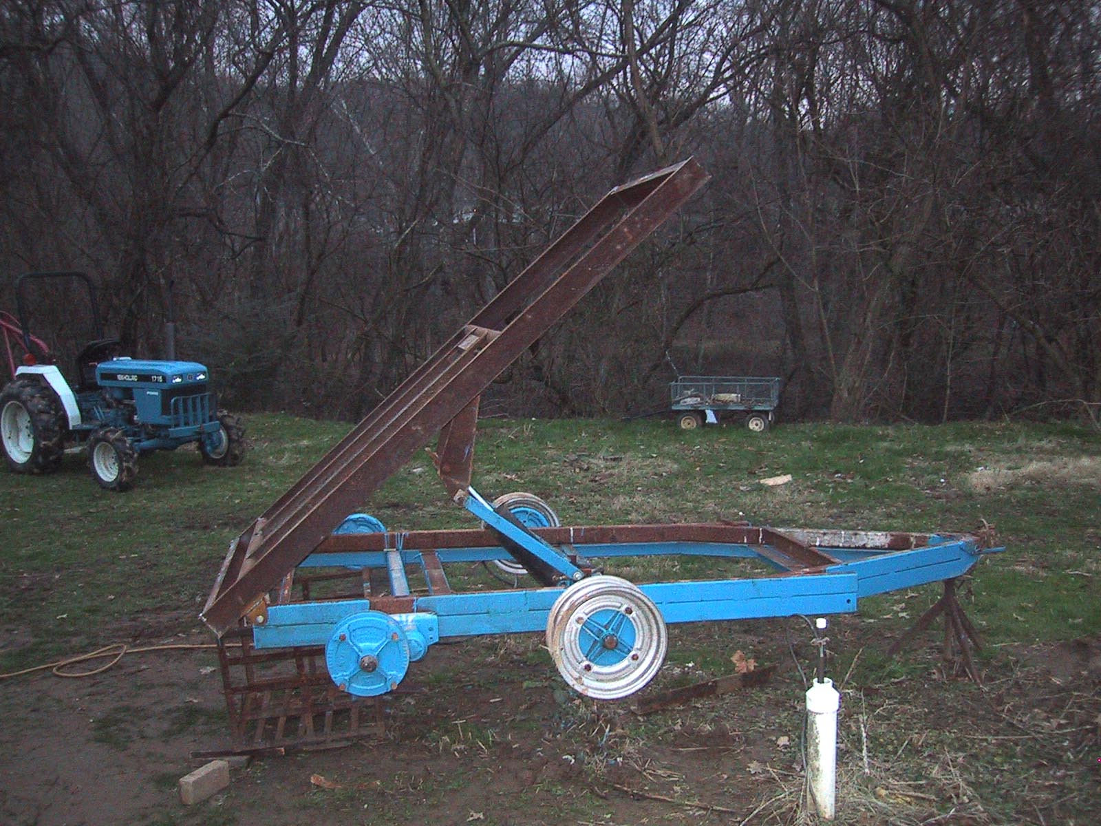

This is an ongoing project of mine.
/ modifiying trailer for dump action? #12
This is an ongoing project of mine. If intersted I can send measurments of mine.
