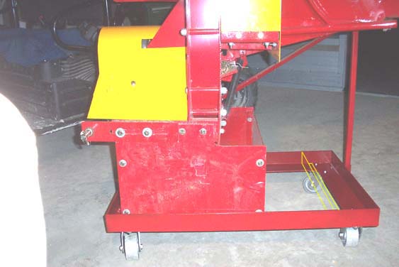

Great ideas for mods! I too have added a small toolbox and just today I added some skull protection. Seems like every time I walk by the chipper, I hit my head on the discharge chute. So I slit some heater hose and screwed it onto the chute.

I like it! Although I've never personally smacked my noggin on the discharge chute, I can think of a bunch places where heater hose would provide some protection.

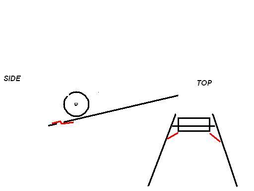

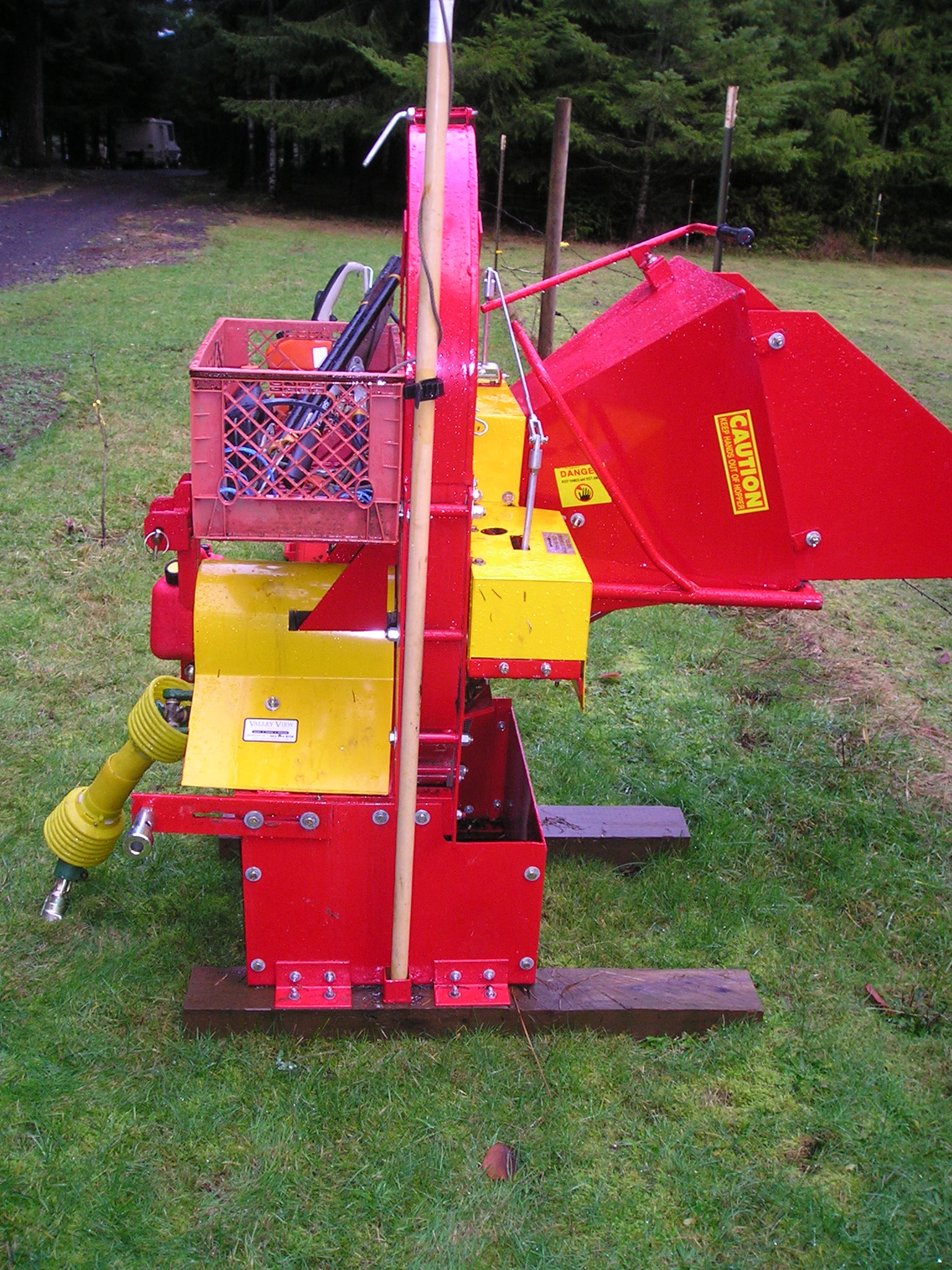

srjones said:
Yes, very much so. In addition, it raises the height by 3.5" and keeps it off of the dirt. Additionally, I can use it to haul/store stuff in the back.
I used pressure treated 4x6s, but I suppose a 2x6 could be used as long as it doesn't extend too far.

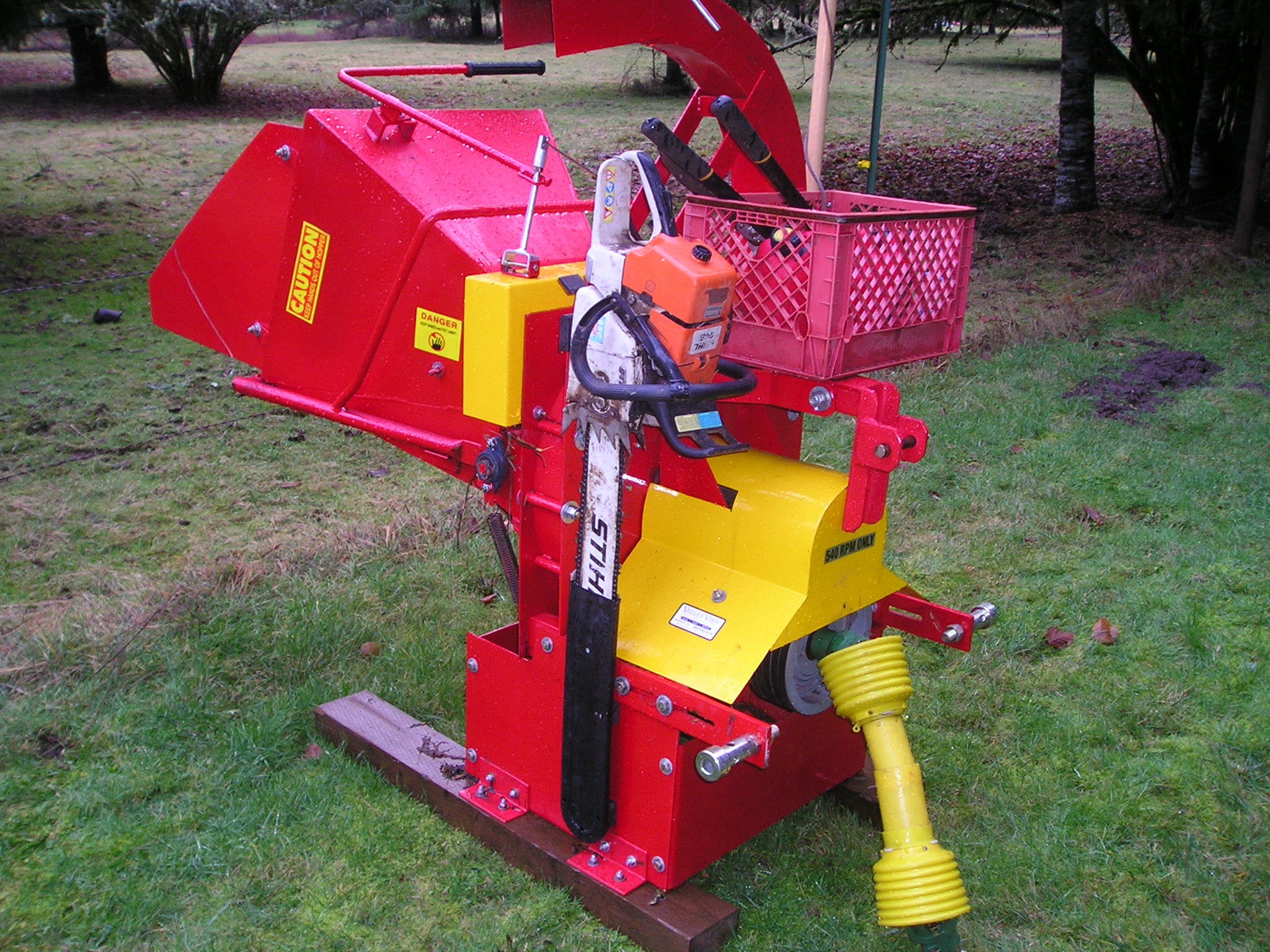

The 'lip' that I was thinking about was to counter the effect where the sheet metal flexes and larger stickes with square ends get stopped by the anvil (see the side view, and the lip in red)
I like the idea that Kays Supply mentions. On each side of the roller, there are places were small brush & vines and miss the roller and get wrapped around the shaft. I've tried to draw my understanding of this in the top view.
I think mine actually came with those lips welded in. I will try and snap a picture this weekend.

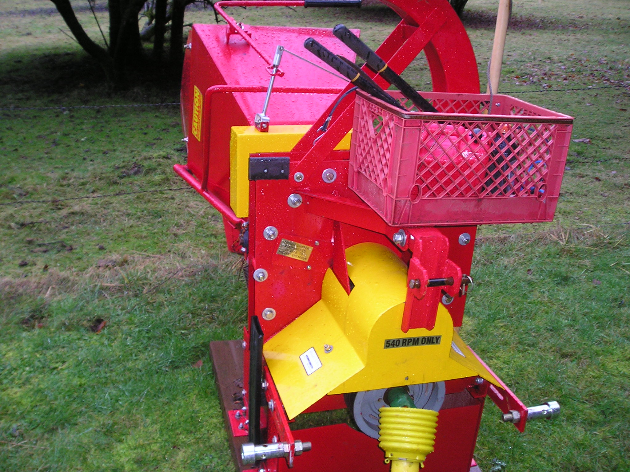

New features! :)
When you take pictures, could I request you get a close-up of the 'spring-lever' as seen here:
/ Modifications to a Jinma chipper #32
srjones said:
New features! :)
Sure, which is the "spring lever" the black on the right, or the yellow on the left?
I think they added that yellow on a 45 degree angle to help with the "tippy" problem others have adressed here.
As I look in my feed chute, it has some additional pieces welded in, that put the axle of the feed roller behind them, I will grab some pictures, but I think that is what was described before.
/ Modifications to a Jinma chipper #33
The black lever on the right, thanks.
In addition to the 'kickstand', it looks like the chute extends farther than the basic model. With all the extra distance from the rollers, there's no way anybody is going to lose a hand or arm unless they dive in head first:eek:

Just bought mine a few weeks ago from Gorilla here in Puget Sound. Pretty fair pricing & no BS attitude! His price is going up on the next truckload (at least that's what he told me, maybe to get it sold). Heck, I was sold already!
These new Jinmas have a bunch of the mods talked about on this forum-already done. That "Kickstand" only partially addresses the problem & if you're on flat ground all is well. It is fully adjustable, BUT..I live in fear I'll hop on the tractor & drive away with it down, bending it or worse, tearing it off completely. I think I'll cut some 6" Channel & weld to the bottom of the box, extending it out back like another guy did with the treated 4X6.
Hey, what's not to like on these things. I have not yet done anything too heavy but it has digested eveything so far & you're right about that extended chute. You'd have to jump in pretty far to even get your arm close to the feed rollers. I'm 6'2" & I can't get close enuf to worry...Unless something snagged the sleeve & dragged you in. Another mod, tho: There's a "Belly Bar" around the back of the chute to stop everything if that happens! Check it out in the photos.
