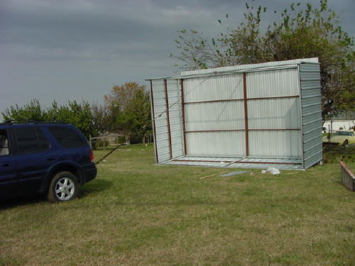

Last night I got a call that the mobile shed had blown over. We'd put the roof on quick like the other evening and hadn't got around to putting it in place or even ordering the trim for the rake and corners. Bud is up there in Wisconsin visiting family and getting his head straight about why he lives in Texas. /forums/images/graemlins/tongue.gif
This is what I found this morning.

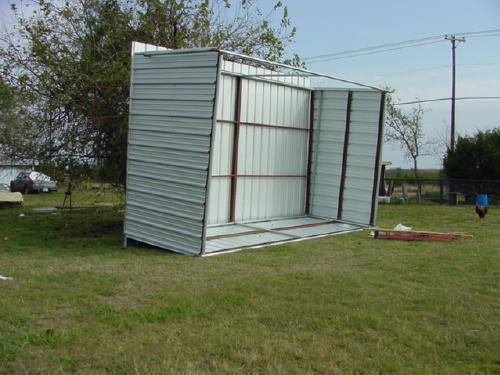

another view

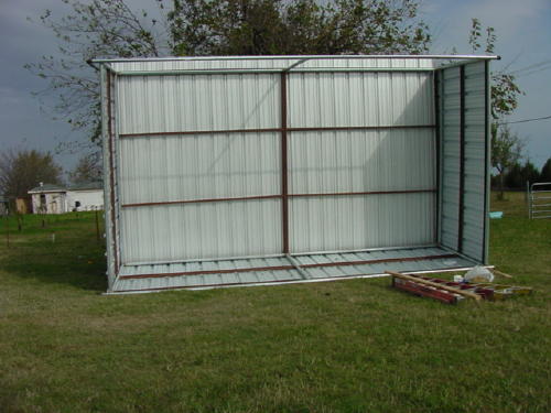

#31
Nuttin' to it. Outside of some mud on the back overhang you'd never know it's went bottom's up.

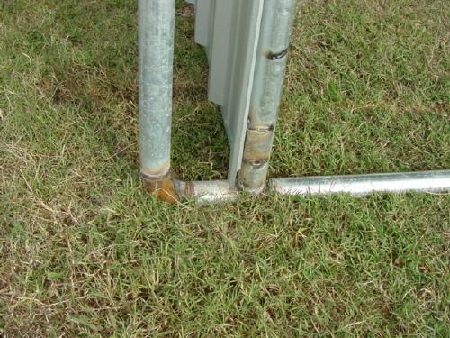

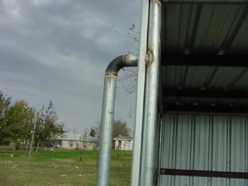

This is what I'm doing for the corners.

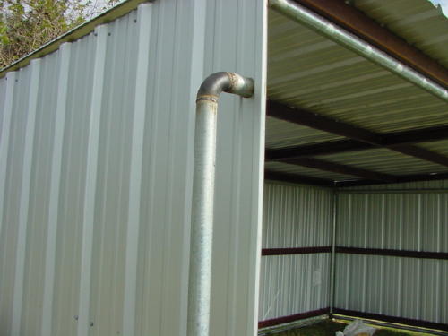

#32
from the inside

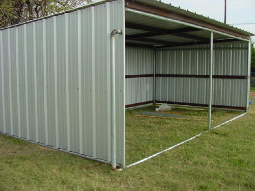

#34
Here's the bottom. You can see how it's designed to be moved easily.
Again, this is without the trim and rake pieces which will make it look a lot better.

One of the things I like about it is if later bud wants to convert it over to a two stall barn it's easily adaptable.
What some folks don't realize is standard two inch by one inch by eighth inch channel you can find at your local steel supply is a perfect match for two by lumber.
Let's say bud wants a wood divider so the horses can't see each other and is resistant to their kicking. A piece of pipe cut in between the bottom skids. Then he takes a piece of channel and removes a section of side that allows his choice of two by to fit. Say he's using two by sixes. He cuts out a section of one leg of the channel six inches.
He welds the modified channel to one vertical and another piece of channel to the other vertical. He can then slide in two by sixes one at a time and slide them down, one on top of the other until he's got a wall.
The same thing can be done to the existing walls.
