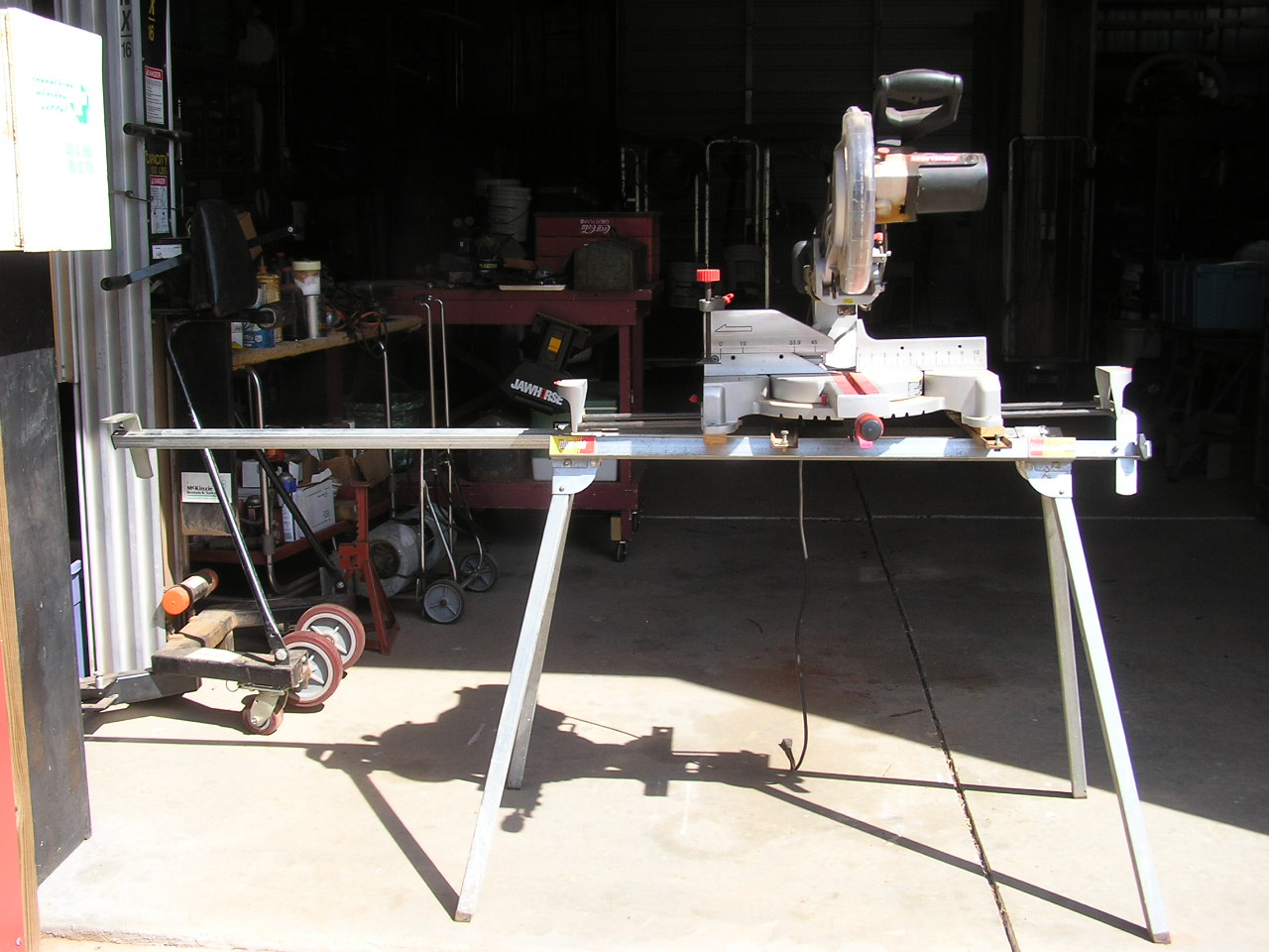

Is this your own creation or did you find the plans somewhere?
I like the flexibility and storage!
No plans, just built it. One thing I like about it but didn't realize it until after I begin using it is the area on the back side of the fence to lay cut off pieces, tape measure, yard stick or whatever. It's a little shy of 8' so I can stand it in my 8 ft. shop for storage.

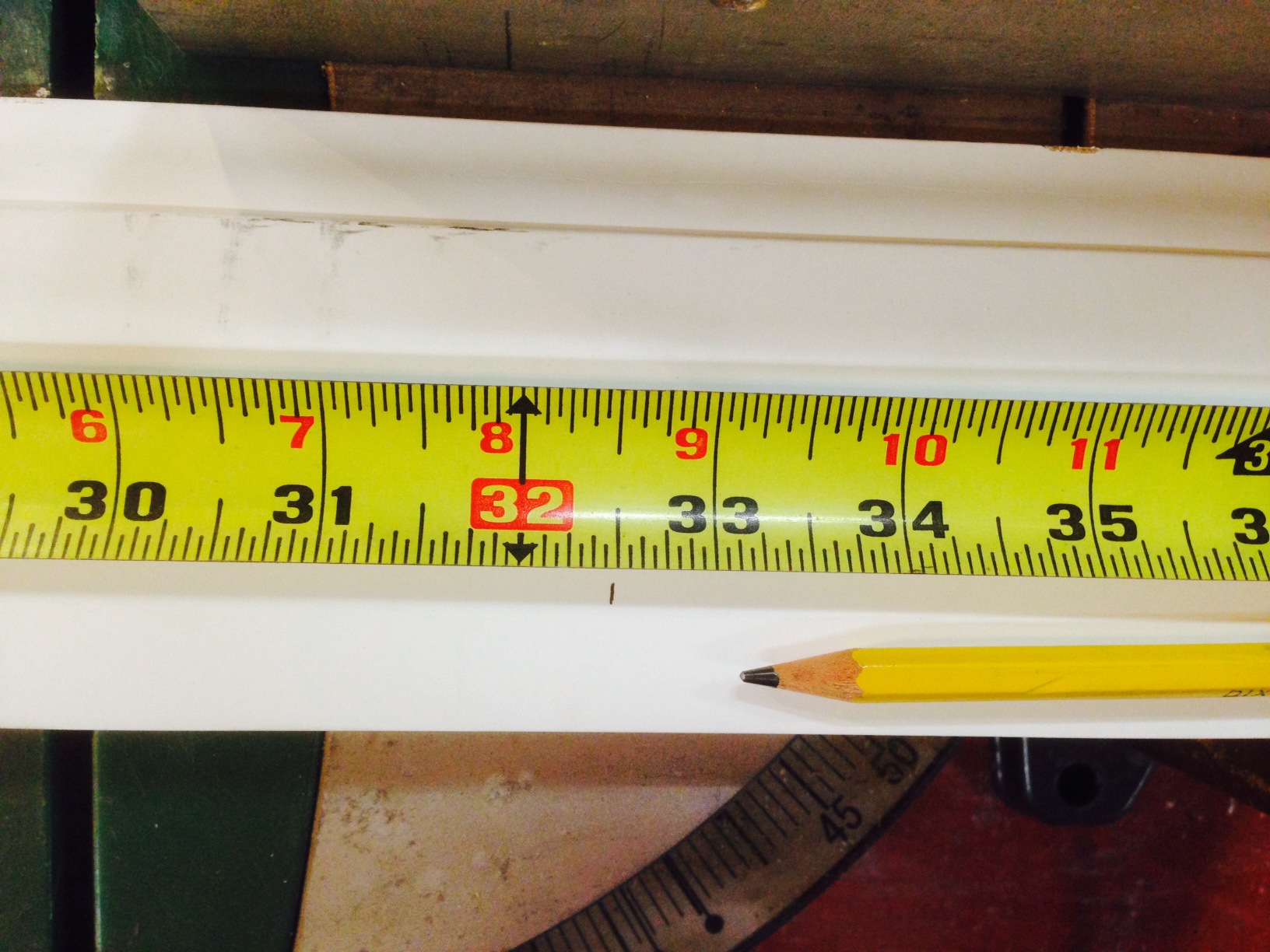

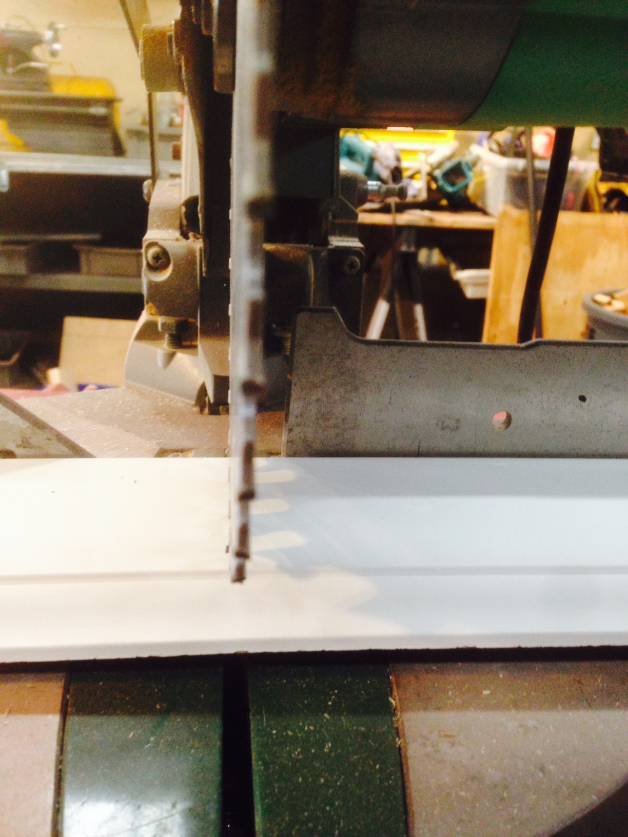

Never had a laser miter saw. I use a regular pencil that leaves a mark about 1/64" wide. Then align a left leaning tooth with the mark. Depending on fit needed I leave the mark or take the mark. Important with hardwoods and fir and stained trim, not so important with softwood and paint/caulk.
