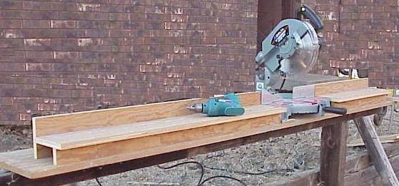

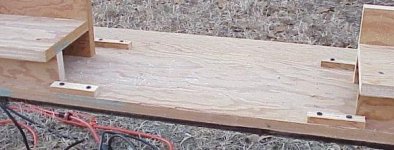

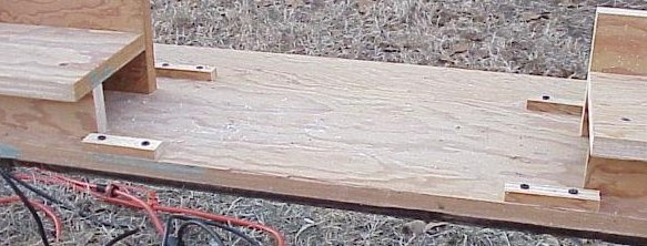

Which ever saw you purchase build it a portable table with a half sheet of 3/4" plywood. You'll be glad you did. This one is better than any purchased stand ever built. To use lay it across a couple of saw horses or across the PU tail gate. Doesn't need wheels and stores standing against a wall taking up far less room.

Is this your own creation or did you find the plans somewhere?
I like the flexibility and storage!
/ Miter saws #17
I don't know about Sandbur's version, but Norm built one that looks nice.
