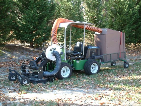

This would be great if you had to vacuum leaves off the road:
Unfortunately, it looks like it would be a pain to actually use it anywhere you had to turn a corner or maneuver around a tree. LOOK! There goes the leaf train!

It works.
