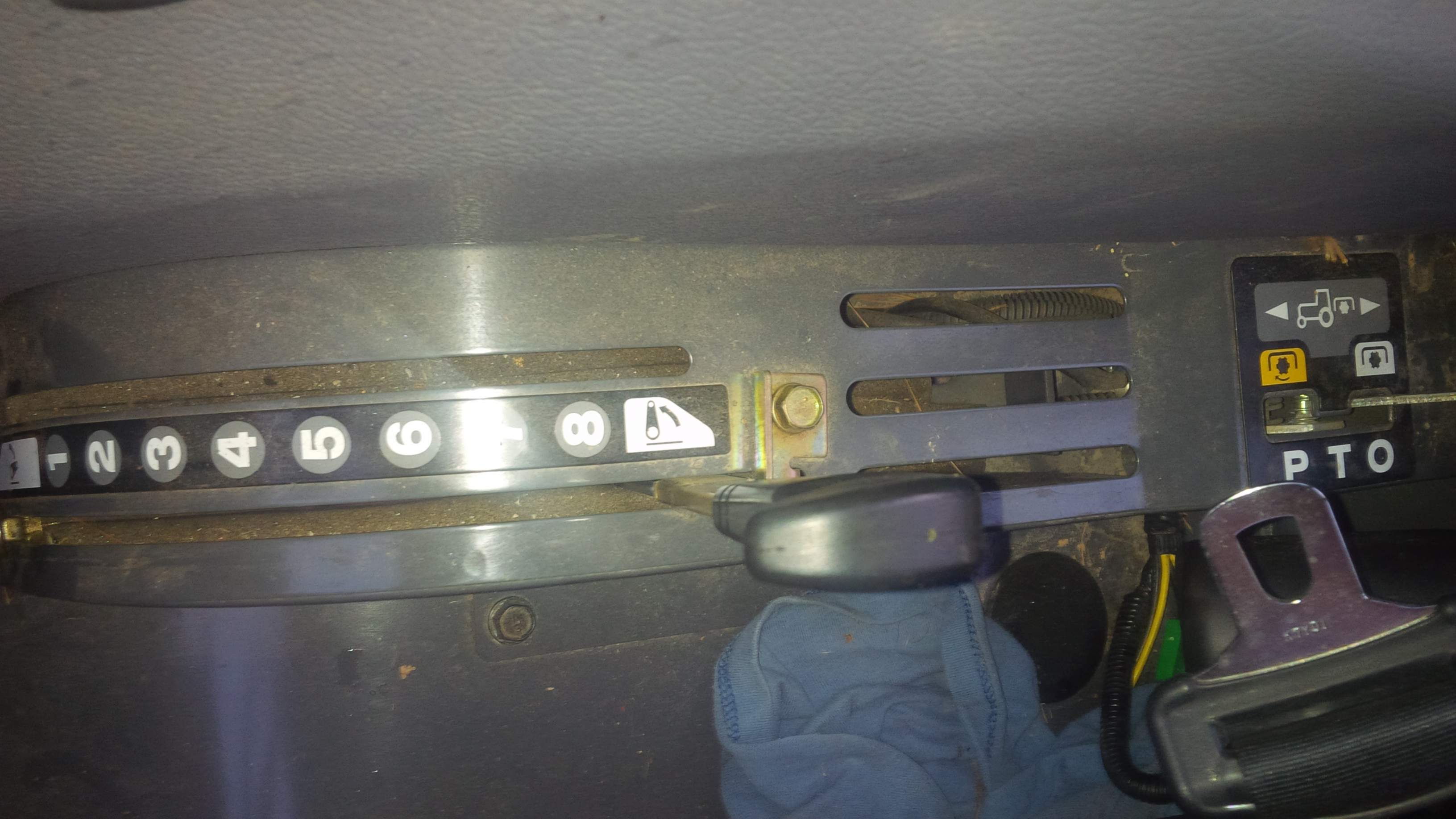

I had my neighbor point out the missing parts (some pins were missing).. After running to the tractor store and starting attaching the three point arms, I started looking at my controls... and at my manual.. manual says I should have 3 point controls, but I don't appear to have them.. However, the cyliders are there, so something must operate them.. what am I missing?

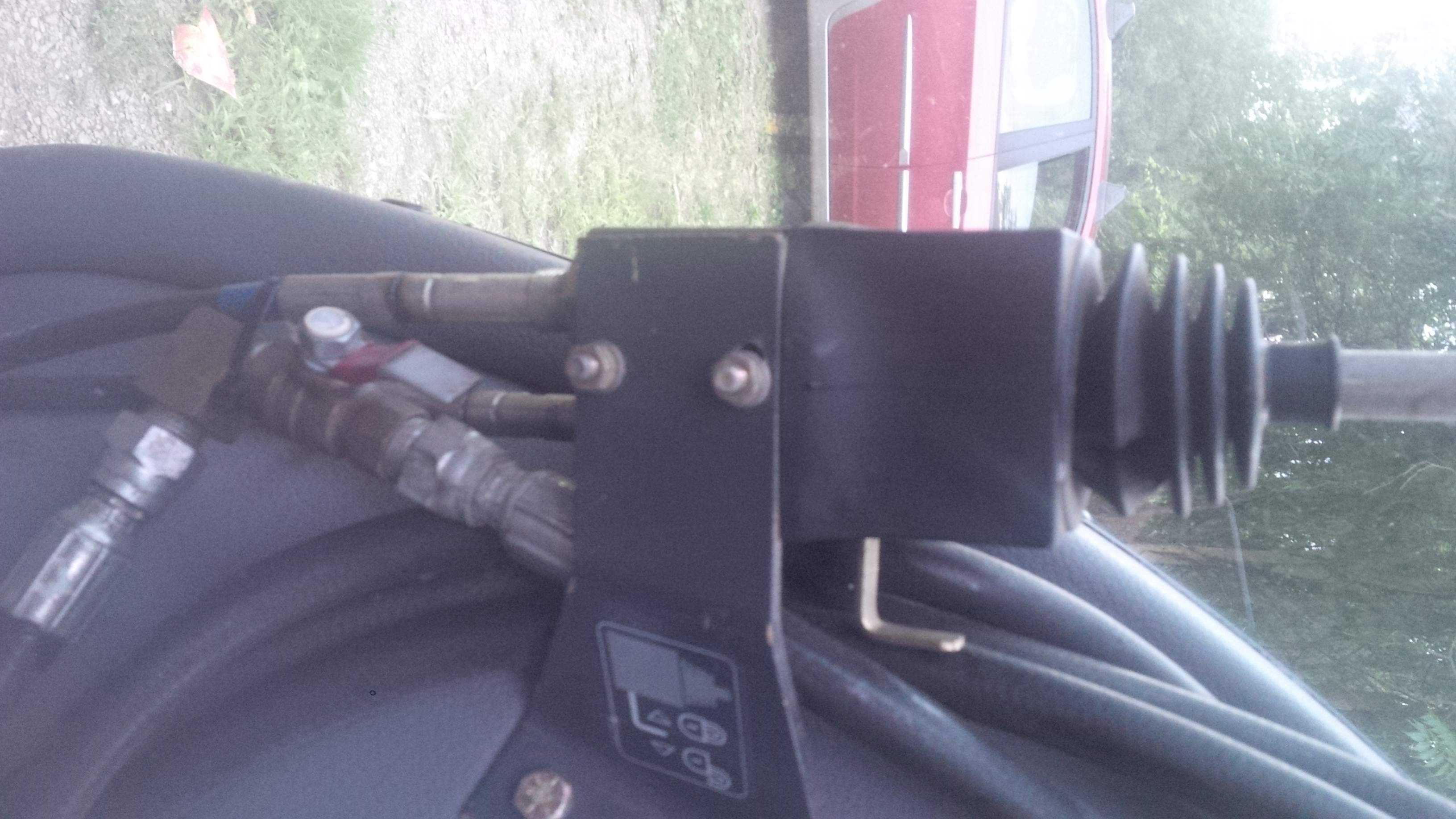

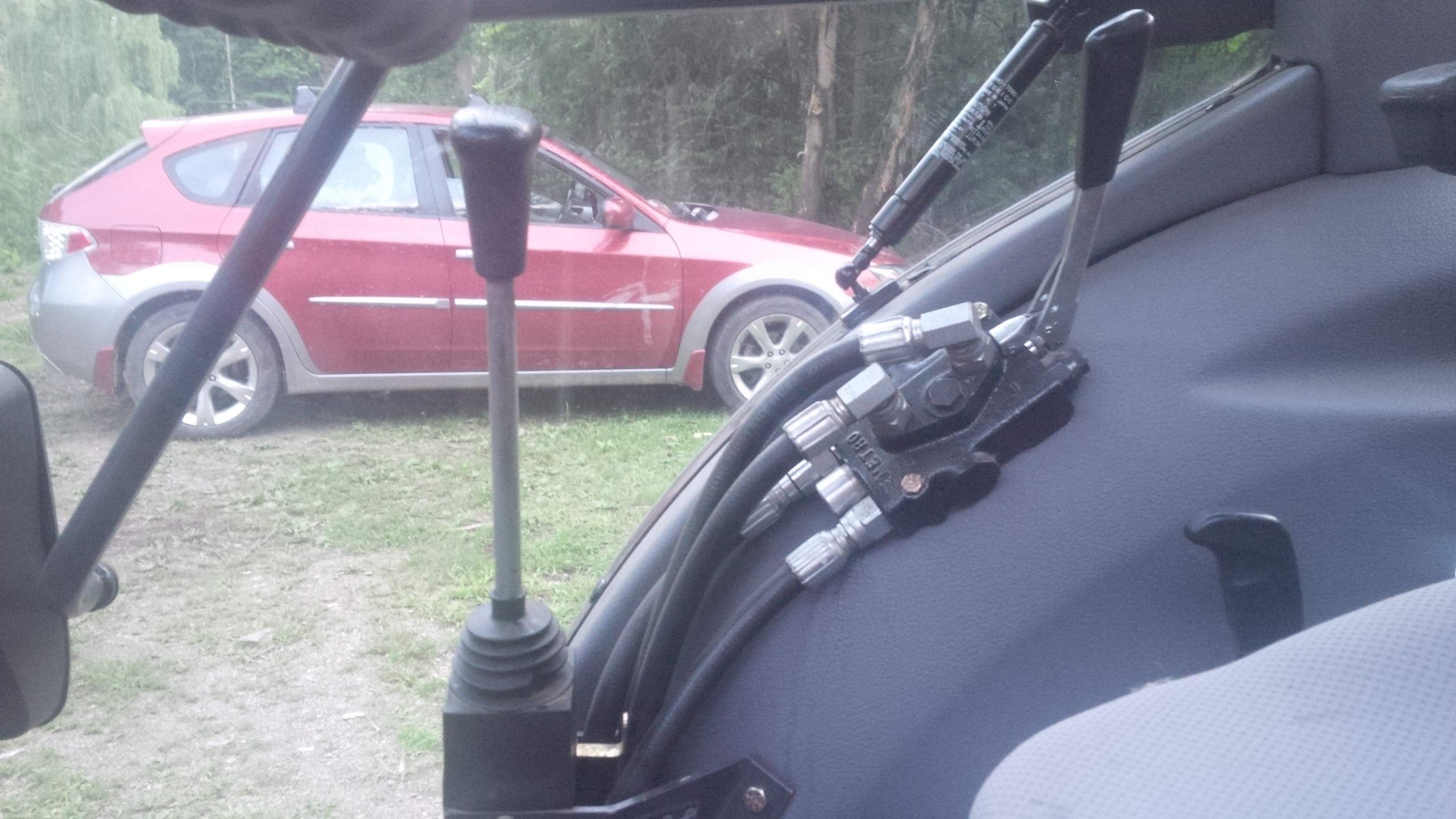

1st: Front Bucket and "Remote" control (operates snow plow)
2nd: Shows the lever is switched towards the "Remote" control (you can either use the backhoe, or "Remote")
3rd: 3point pitch and PTO controls are supposed to be here

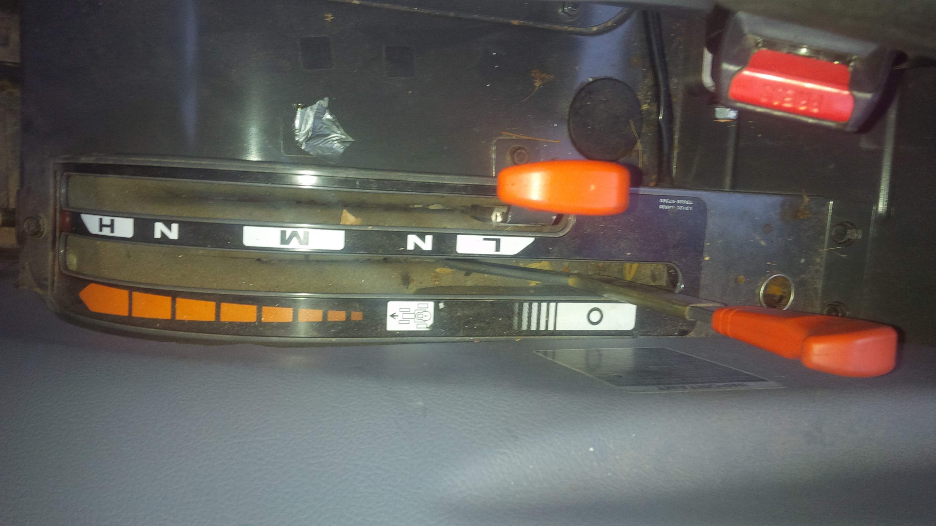

4th: gears and speed control (never used the latter)
5th: 3 point hitch related (controls speed, per manual)

I don't know your tractor, but the lever in the third picture looks like the 3PH position control lever to me.
Steve
   / Missing 3-Point Hitch Controls? #4
It's the big lever to the right of the seat with numbers/positions 0-8 on the scale.
It seems to do nothing. Almost if something needs to be switched on to let it engage.

Is it a factory backhoe? You may need to connect the two backhoe hoses together in order to complete the power beyond (PB) loop that goes to the 3-pt hitch. That is always last in the PB loop on Kubotas.
I do see some non-factory valves in your pictures, so it's possible you don't have a standard PB setup anymore, if someone modified the loop thinking the backhoe was permanent....
The backhoe is Woods 9000.
The backhoe hoses were connected.
Where do you see non-factory valves.. could they be for the snow plow?

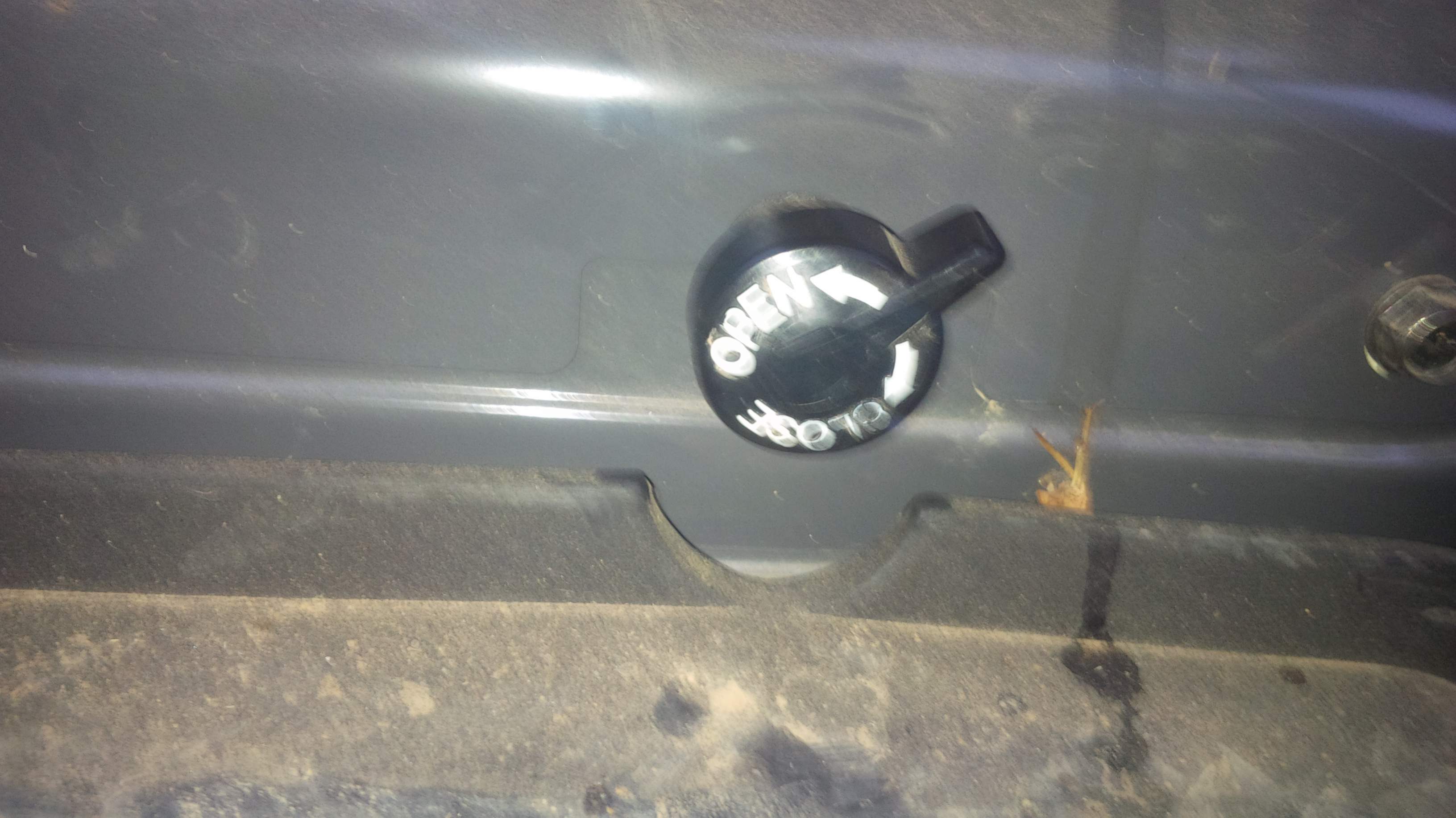

Going to go check if 3point speed knob is all the way "open" (thought I tried it.)
   / Missing 3-Point Hitch Controls? #8
The exposed valve on the fender is definitely not factory.
Question -- what is on the hose that runs from that valve and goes under the loader valve mount -- looks almost like a bronze or brass ball valve with the lever cut off? I hope it's not a bronze or brass ball valve on a hydraulic system, as they aren't normally able to handle pressure that high.
#9
That valve controls if I can use the backhoe or the snow plow. I do not know what it is made from.
The issue was with the 3point speed knob. Once I put it to open things started to work.
