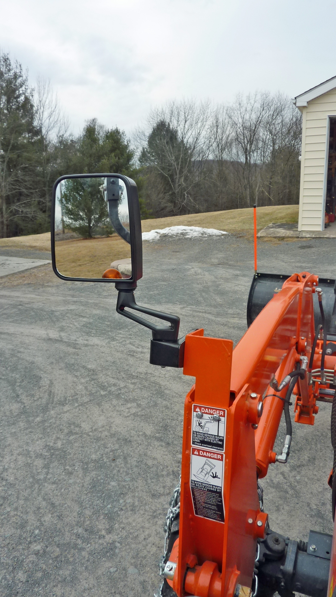

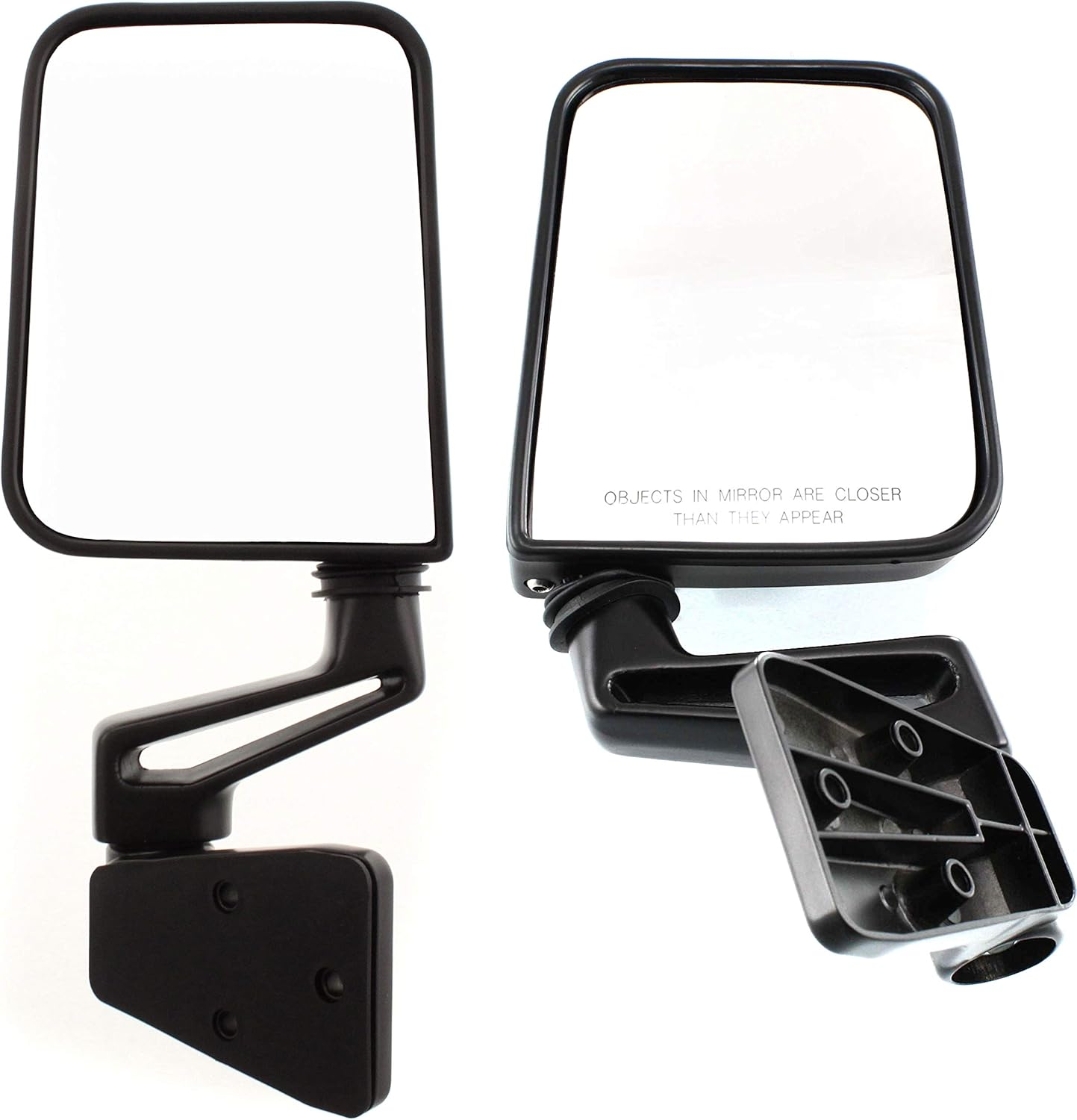

I use these cheap Jeep Wrangler mirrors:
They articulate easily but hold their position well. The mounting bracket also absorbs much of the vibration.

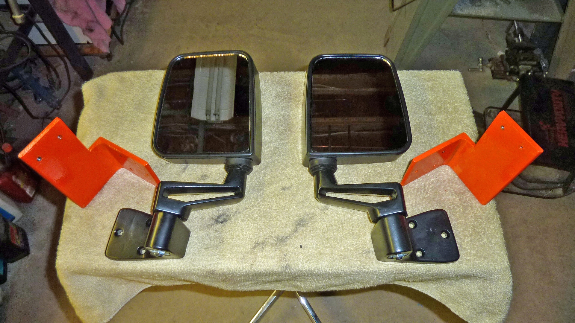

I mount then to the FEL frame with a couple of angle iron brackets:
View attachment 2632329 View attachment 2632330
The lower bracket also serves as a handle to steady yourself while mounting & dismounting:
They swing out of the way when hit by a branch and are readily available should one get broken.
