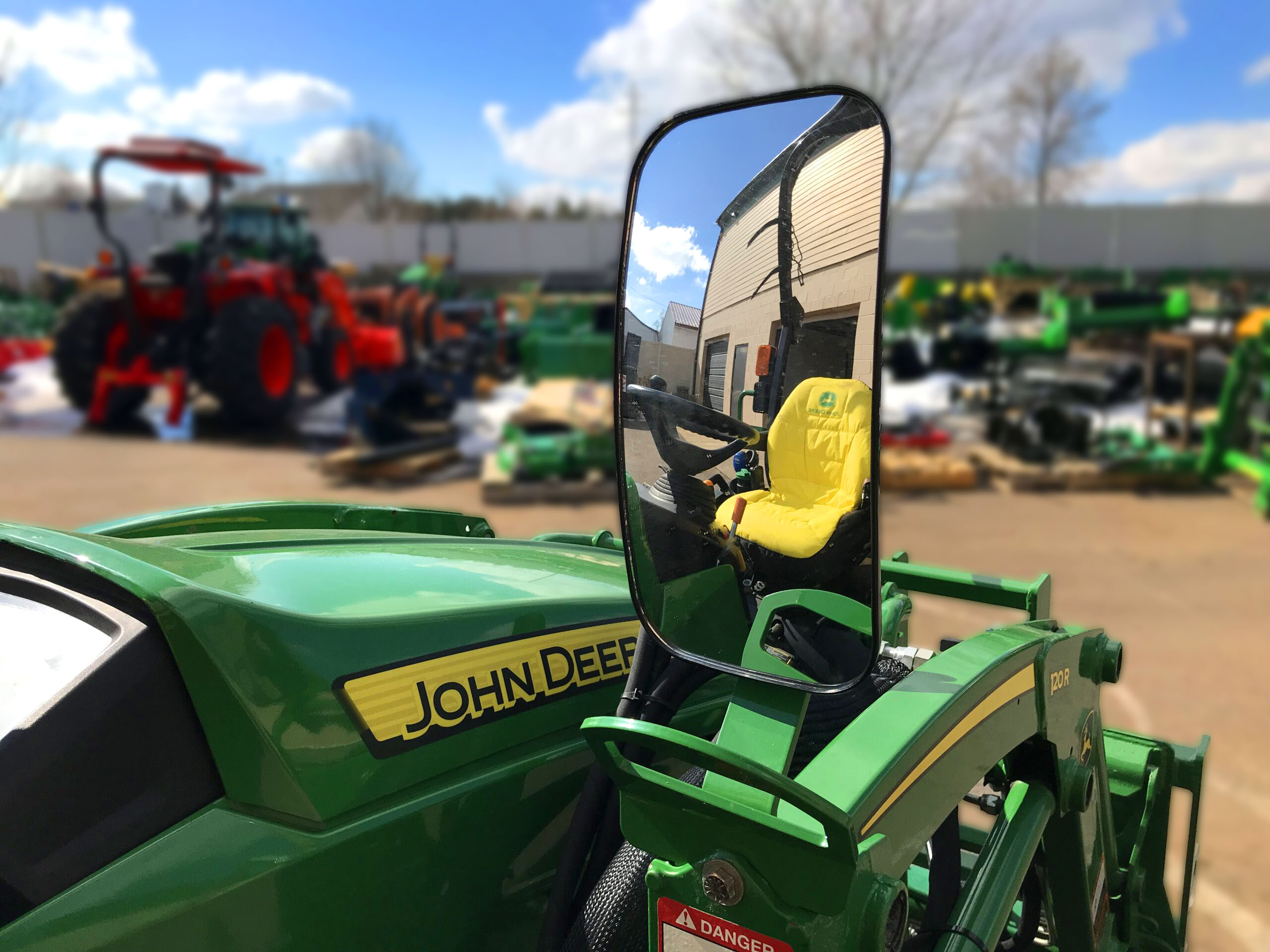

These popped up as I was just poking around the net yesterday. Thats all I can say about them.

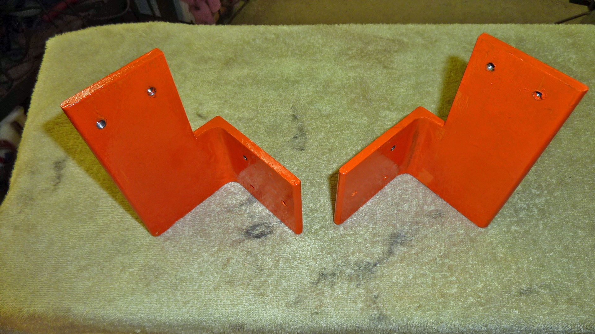

I use these cheap Jeep Wrangler mirrors:
They articulate easily but hold their position well. The mounting bracket also absorbs much of the vibration.
I mount then to the FEL frame with a couple of angle iron brackets:
View attachment 2632329 View attachment 2632330
The lower bracket also serves as a handle to steady yourself while mounting & dismounting:
They swing out of the way when hit by a branch and are readily available should one get broken.
bdhsfz6 loved the mirror mounting. Not sure what thickness size I need for angle iron. That extra benefit of a hand steading sealed the deal for me.​
   / Mirror recommendations for open station tractor #23
I used 1/4" X 3 1/2" angle because I had it on hand. 3/16" would work fine as well.
Here's a link to a more detailed post I made back in 2018:
It's specific to Kubota, but the same principle would work for John Deer as well.
