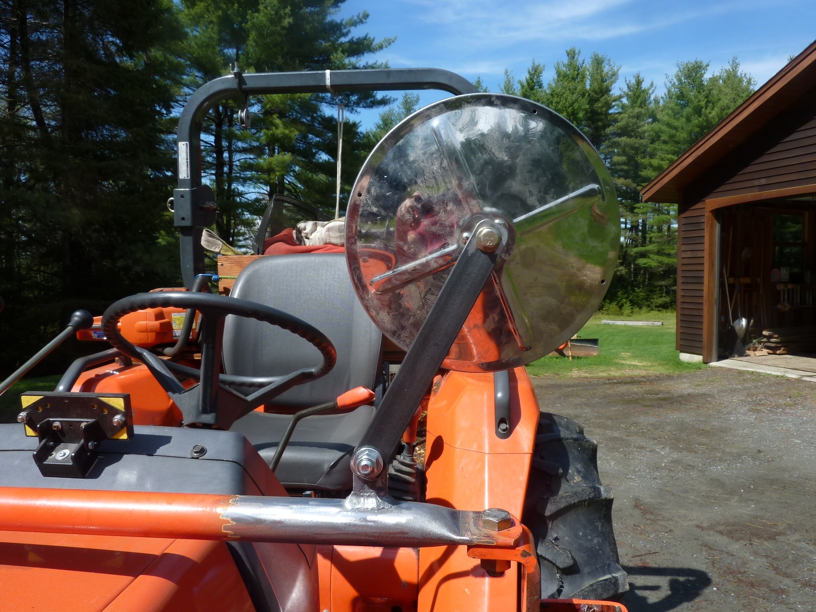

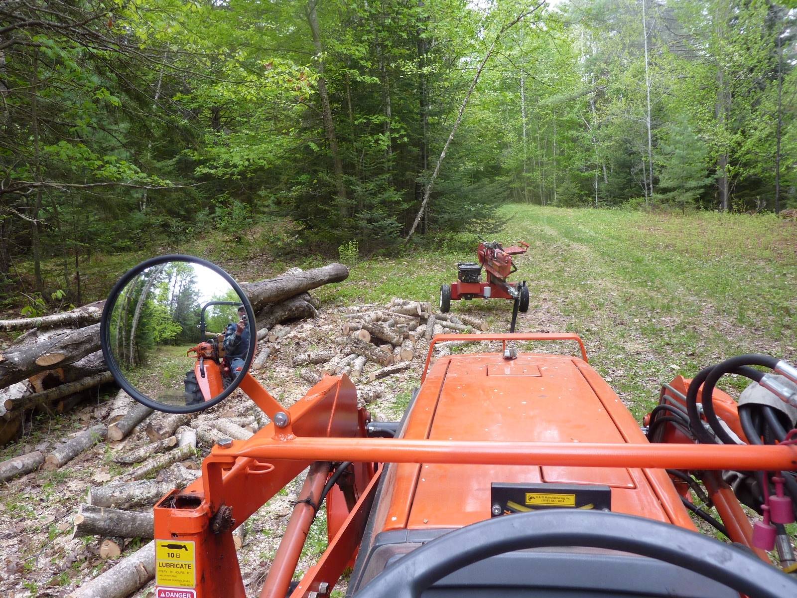

Years ago I found this one in the snowbank, off a UPS truck I think :) . Made a simple bracket, and welded it on the loader cross brace. It is not sticking way out, which I like, but it gives me a good view of what's behind me.

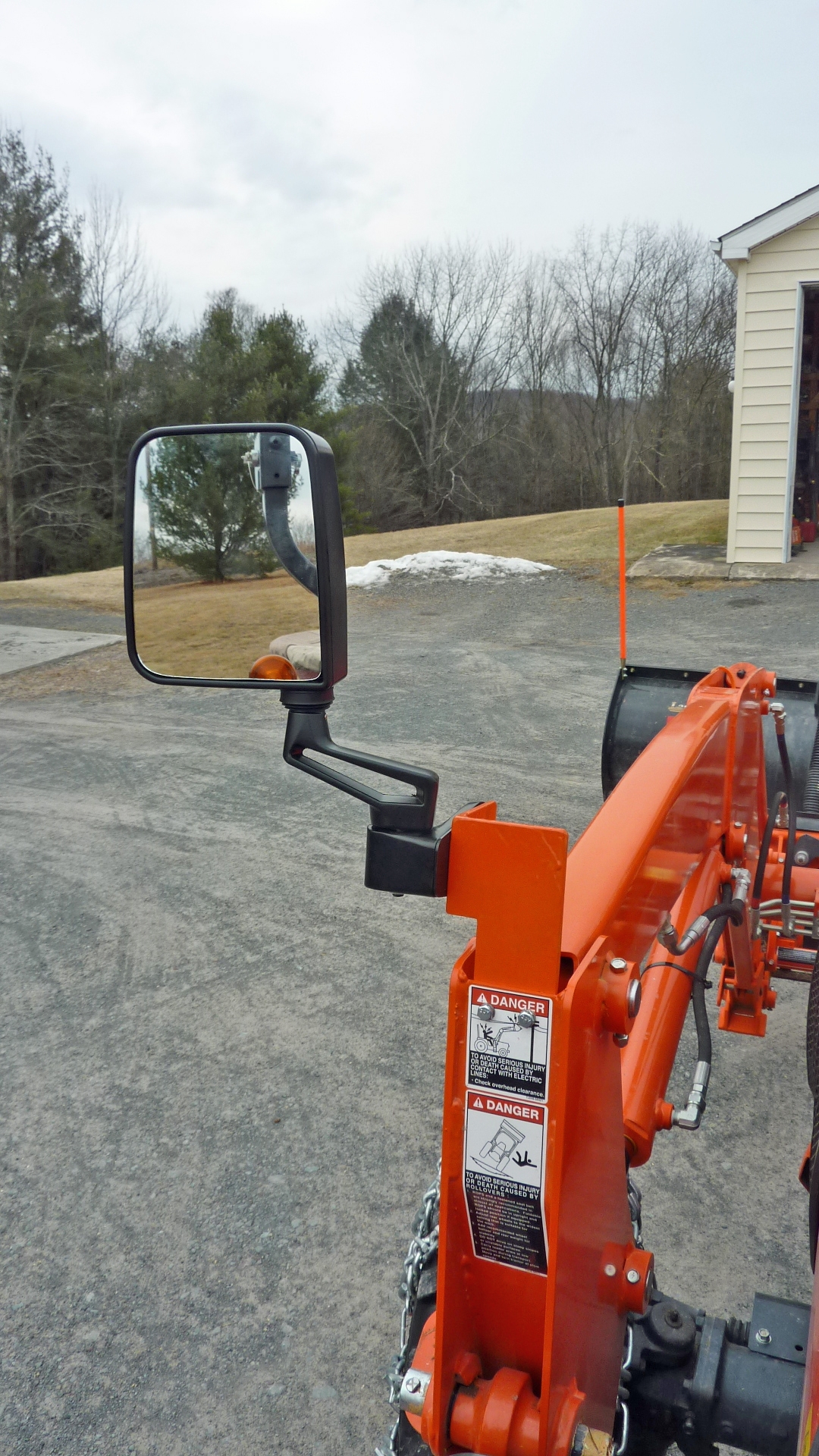

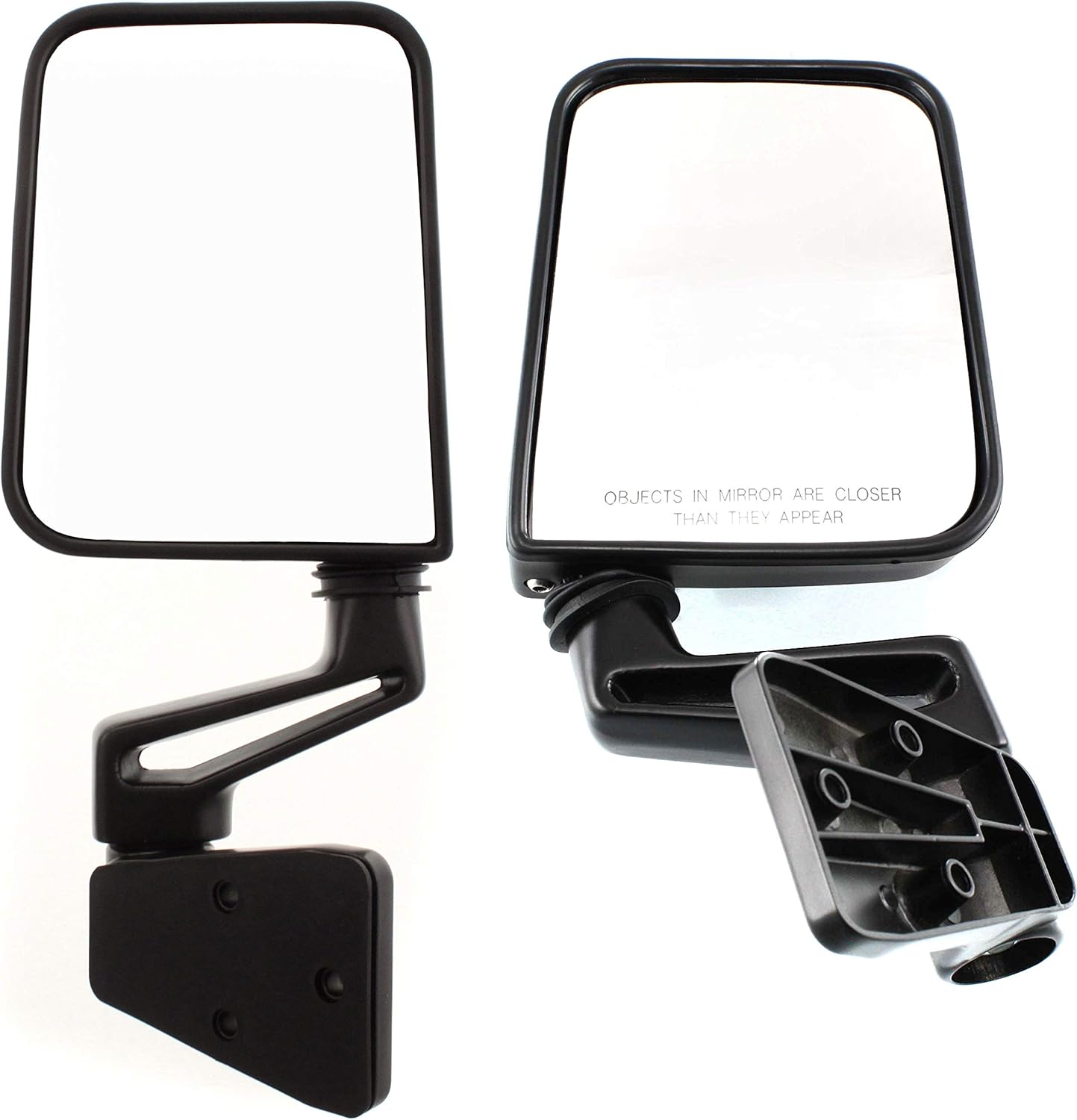

I use these cheap Jeep Wrangler mirrors:
They articulate easily but hold their position well. The mounting bracket also absorbs much of the vibration.

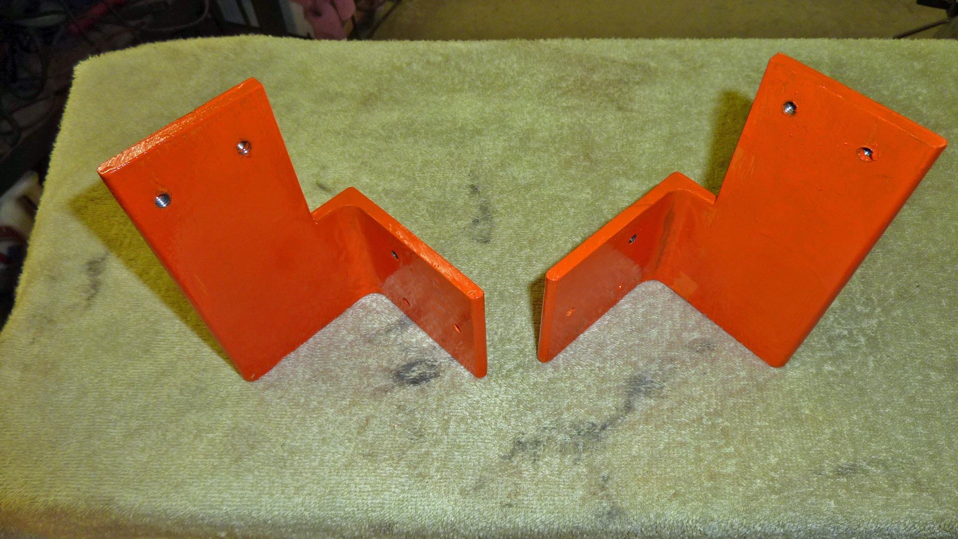

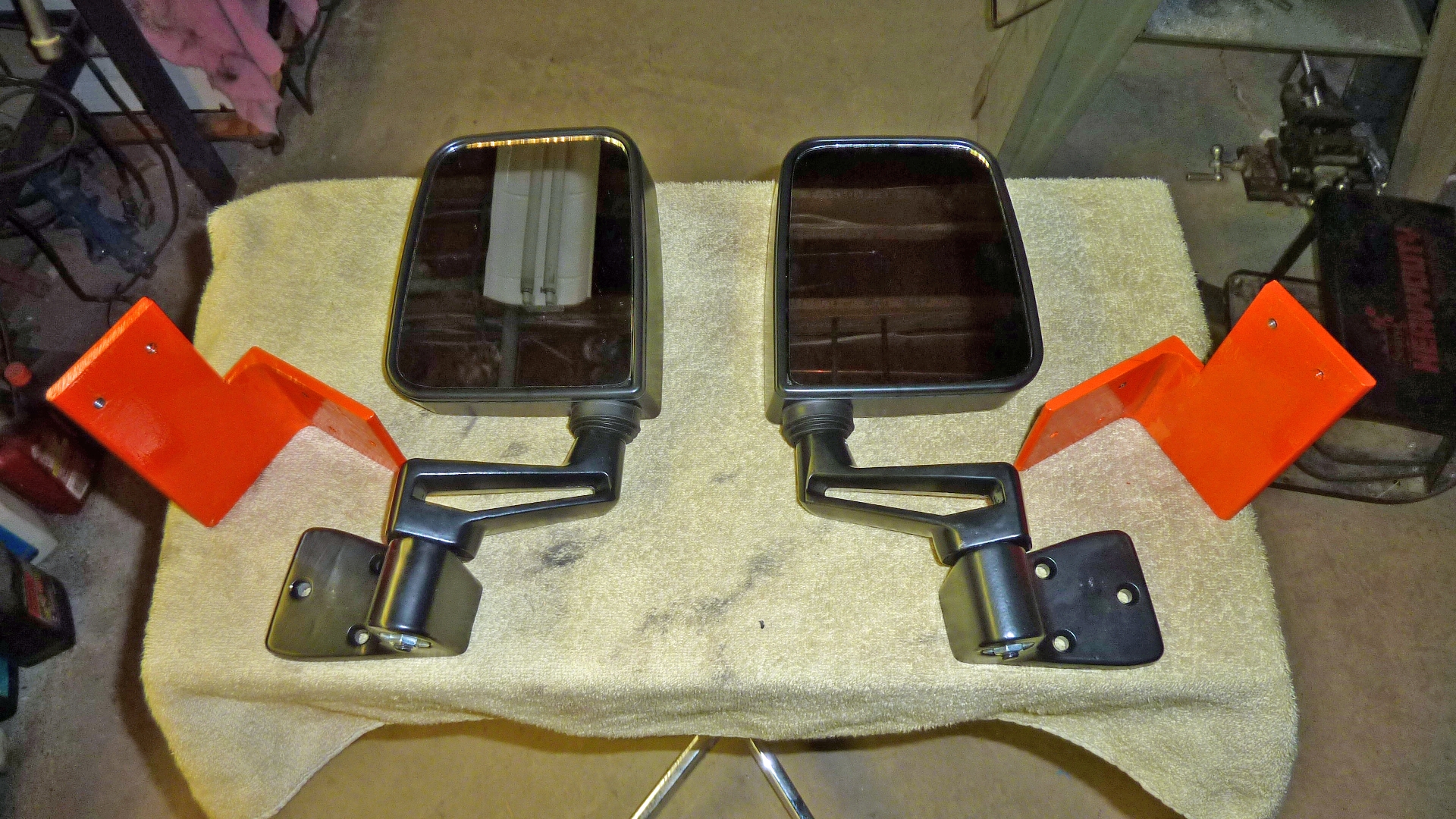

I mount then to the FEL frame with a couple of angle iron brackets:
The lower bracket also serves as a handle to steady yourself while mounting & dismounting:
They swing out of the way when hit by a branch and are readily available should one get broken.

I like the Jeep side mirror being breakaway. Plus it looks like you can get a great view of offset implements such as my hay mower and rake and has a sturdy mount.

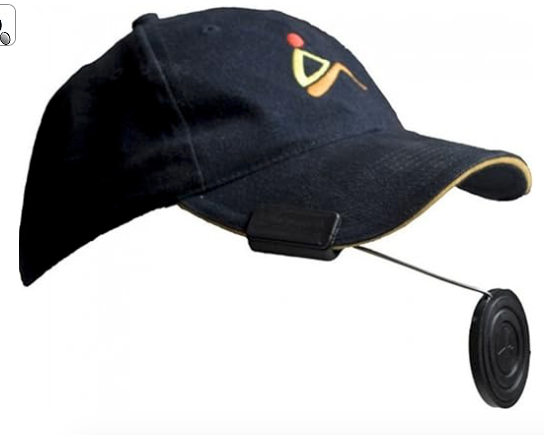

I'm almost wondering if one of those little mirrors that mount on a hat that cyclists/rowers use would be able to suffice? It would probably take some getting used to but then I could just tilt my head up a little bit to make sure and directly behind PTO implement was working correctly instead of have to rotate my head. But then again vibration with such a small lens might make it useless.

I tried using this bicycle helmet mirror attached to my noise protector muffs:
The larger size mirror helped and it worked ok, but I found it too difficult to quickly position my head to see what I needed. Much easier to glance at a fixed mirror with a wider field of view.
