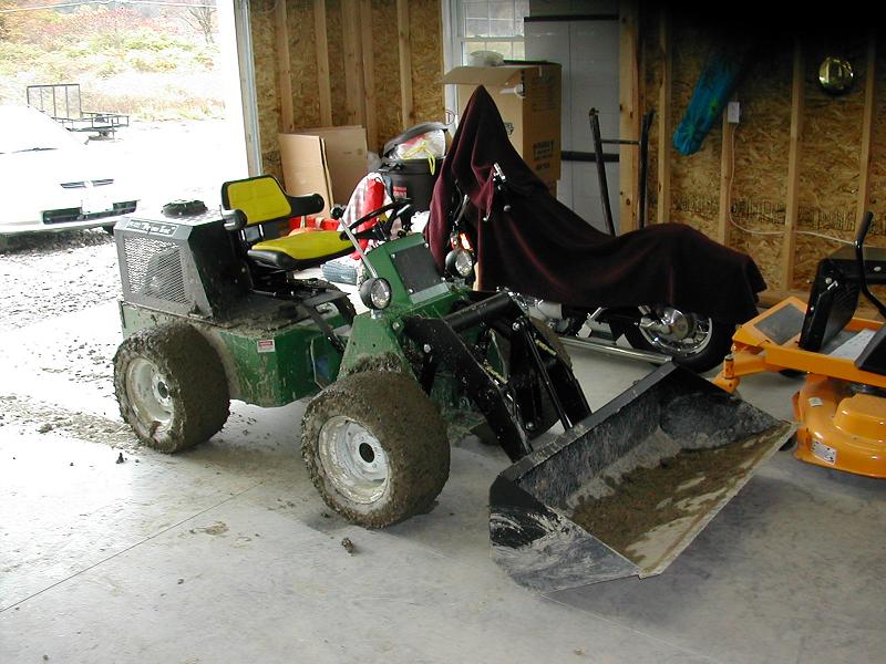

Looks like you’re putting it through its paces and having some fun I like the seat. What you got under the cover on the other side a Honda VTX?
/ Mini Modification #22
It's a Suzuki Intruder VS1400. It's for sale too. :( 1995 Suzuki Intruder 1400
Can't have too many toys at once... so the bike and ztr must go.

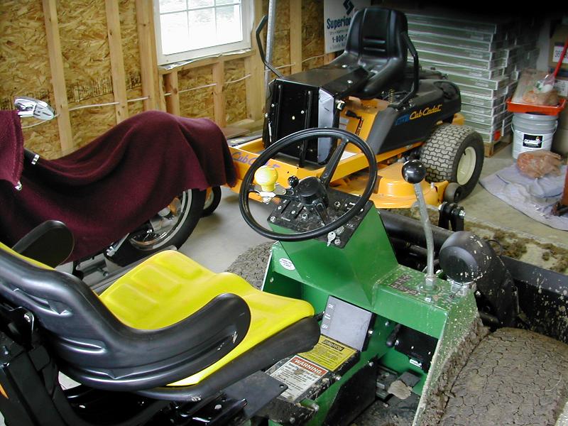

I took pictures of my newly installed TSC suspension seat and spinner knob. I wanted black, but they didn't have it... so I went with the JD "look". :D (Yes, I know my PT needs some cleaning... :eek: 14 hours of use in just over a week of ownership)
The seat sits much higher and is a bit harder to get in and out of, but it does seem to take the edge off of the bumps. My property is mostly clay that hardens like a rock and makes for a very rough ride.
I've had that seat on my 1430 for a couple of years and it's worked out well. The thing I found,once I installed it, was that the extra height made steering easier without the spinner, so I took that off.

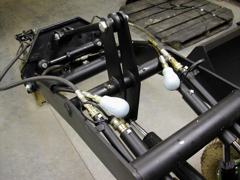

With the additional height of the suspension seat, reaching down to curl the bucket on the mini-hoe was killing my back. So here's another small modification I did yesterday. Cost was about $15. $5 for the 1/2" stock and $10 for the shifter knob (clearance bin at Auto Zone). I decided to keep the green/yellow theme going... :) :D

Good idea. What is the stock material? Also can be get a picture of how the stock attaches to the valve?

It was 1/2" round, 36" long cold rolled steel I believe. I got it at either Lowe's or Home Depot (can't recall). I grinded the last few inches of the end flat to match up with the stock part. Essentially, I tried to make the end look as much like the original part as possible.
That's very helpful. Thanks.
