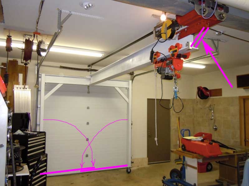

Sodo, the wheels are from Surplus Center
6x2 RIGID CASTER
New, JARVIS rigid plate caster with Triton polypropylene wheel. High load capacity Zerk fittings on both wheel hub and thru bolt. Roller bearings on axle.
SPECIFICATIONS
Wheel Size 6" x 2"
Load Capacity 1250 lbs.
Top Plate 4" x 4-1/2"
Mounting height 7-1/2""
Mount 2-5/8" x 3-5/8" slotted to 3" x 3"
Bolt Holes 3/8
With the weight of the AL, the pair is good or about 1 ton.

The load capacity is not the problem IMO. It's the smaller diameter. Even a small pea sized pebble is gonna stop it cold
/ Mini gantry crane #24
Could load it up and roll it over a pebble and see. Polyurethane might accommodate small pebbles.
Personally I'd load it at least double of the 880 lbs and lift 1 inch, bounce on it, shove it, try to see where it's flexing and brace accordingly.
Ignore the purple brace on the red/white juncture, I drew the pic but now I don't think it provides anything. The load on those 1/2" bolts is a tiny fraction of their capacity.
The rolling legs could have a fold-up brace that swings down and double-pins at center for when you travel it. Or maybe if you ever have a real heavy load just bolt a 2x4 across from leg to leg (at that time). You might get a handle on this by rolling it over a pebble with 2x or 3x 880lbs.

Looking things over again, I think the connection to the steel beam with the angle iron and bolts will be fine. Take the aluminum beam out of the equation and I would have any concerns hanging ~1500+ lbs from that pair of angle irons.
Welds still concern me, without seeing pics of the rest of the welds. Aluminum is tricky.
And the legs are still a concern. Mainly if you have to move a ~800# load that requires rolling those casters along. Thats in the weak direction of your aluminum box tube legs. And it is aluminum.
My 4 posts on my bridge crane are 10" i-beams standing 10' tall. They do flex if I bump the end stops pretty hard.
With your setup, I wouldnt want to have a heavy load moving along and and hit a stone ot something with a caster. Would be afraid of a leg buckling

What I've learned so far from use, I need to be able to lock the trolleys in place. I'm thinking of a threaded bolt to pinch the beam. With the gantry so easy to roll, the object pulls the gantry instead of vice versi. Came up moving my mmm. Also, everyone is thinking heavy stuff, I'm thinking 200- 400 lbs stuff. My lathe is in line with the wheel path , so I'm thinking lift one end at a time and swing 6 inches. That's all I need to clear it. Thanks again for all the good insight on this forum. Rob
I'm thinking of lettering on the beam "If the winch won't do it, Don't do it". It's cap is listed at 880 lb.

I'm far from a crane expert, but I have built one which successfully holds the 4,000# I designed it to and has been proof tested with closer to 5,000#. His 6x2" wheels are what I use on my runway trollies (4 per side) with urethane tires no less. They run real smooth and are load rated to 2,000# each. My bridge and runway beams are rated for a 5:1 or better safety factor even though the casters aren't. Normal working load is well under 500# and anything over 2,000# is infrequent to the point of less than one occurrence per year, so that's fine.
The comment about gravel is valid, but easily prevented with good house keeping. Urethane does handle some grit without causing a problem too. I used them because they run quieter and metal wheels on a 24' track makes some noise.
In the end, we're all second guessing this crane based on some vague photos and the OP's assessment of it's performance. We're not going to be the ones who have to use the crane or suffer the consequences of it's failure, but I do think the majority of people involved in this thread want to see the OP succeed and have a safe implement in his garage. Jumping in with "shoulda done ____" and then having it not even relevant to the materials in use is hardly beneficial to anyone.
Aluminum MIG in a structural application without a mastery of the process is asking for trouble. Welding aluminum at all in a structural application is asking for trouble. I think the OP knows why we have concerns over some of the joints, and that's part of the learning process. Better to wonder about it now than when a load is swinging at you because something cracked loose.
If you use the crane to winch, you'll be applying forces none of the load charts are designed to counteract. Cranes are meant to lift and set, not pull side to side.
