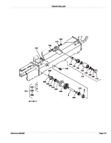

Nobull, On your excavator do you have a top roller or does it have the slide bar since it came with rubber tracks. My Grey Market PC 50 uuKomatsu. Its a 13000 pound excavator. It has rubber and the top slide bar instead of a roller. I need some tracks as Ive already had a lug pull out of the track. I put a bolt through the cleat bar and the lug on the track. I can get a set of steel tracks rails,pads and bolts for 3800 from Komatsu . My Grey dealer can get rubbers for 3600. Ive gt a friend with the same machine but he left the slide bar on it. I dont like it as it has worn down the bushing alot more than the sprocket. I may get a pair of smaller Berco rollers to mount on the top. SOme of the older pc 50's came like this.
   / Mini-Excavator questions??? #15
On my excavator there is three of 040 on the bottom and one 120 on the top. Don't know if you can tell but the bottom ones have a lip on each side and the top one is flat.

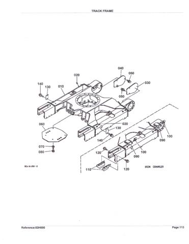

When I switched from rubber to steel all they had to do was add two of #090 and 110 to each side just as wear plates and guides. The only other thing that was done was to release a bit of pressure on the spring on the idlers.
