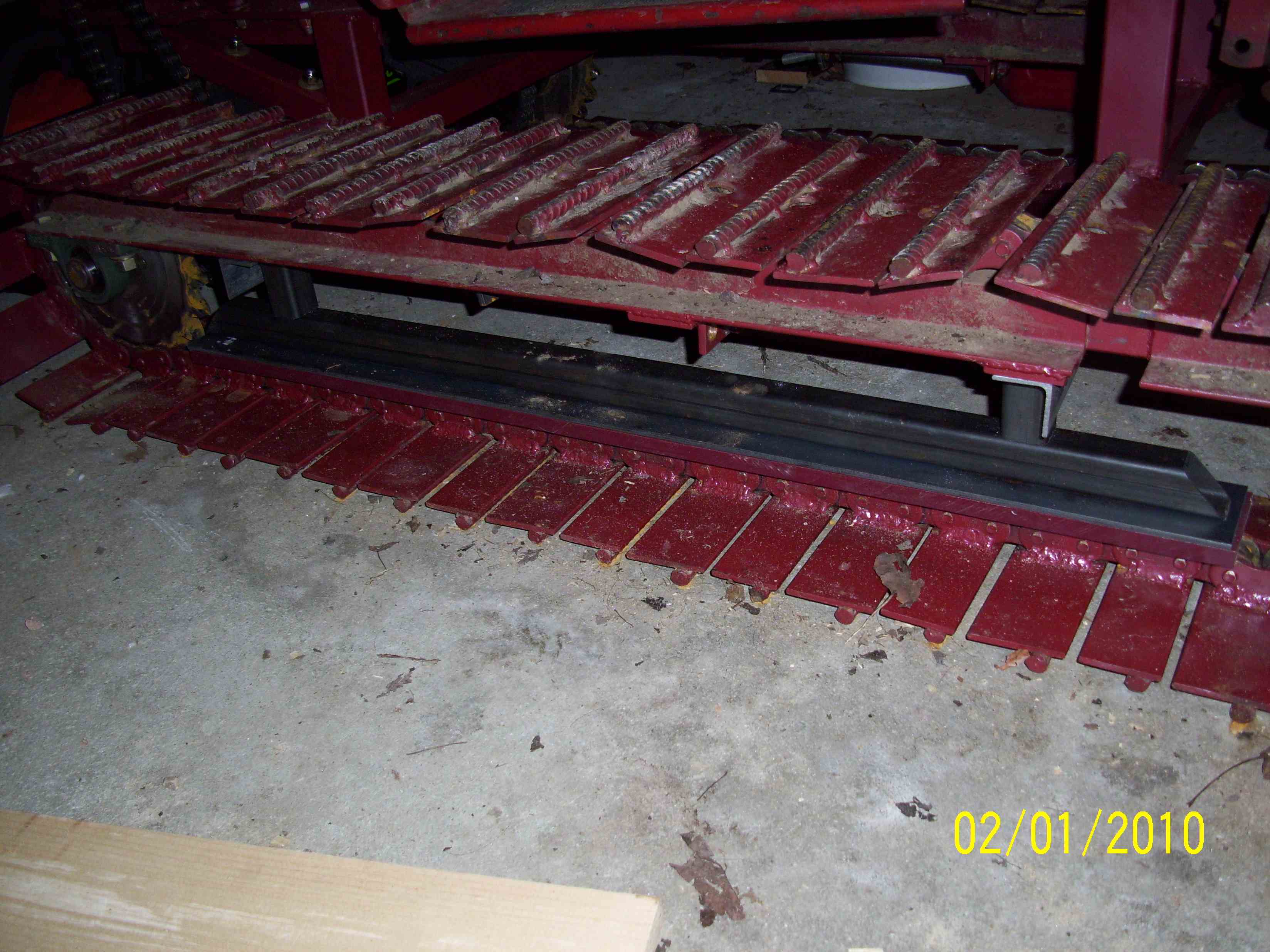

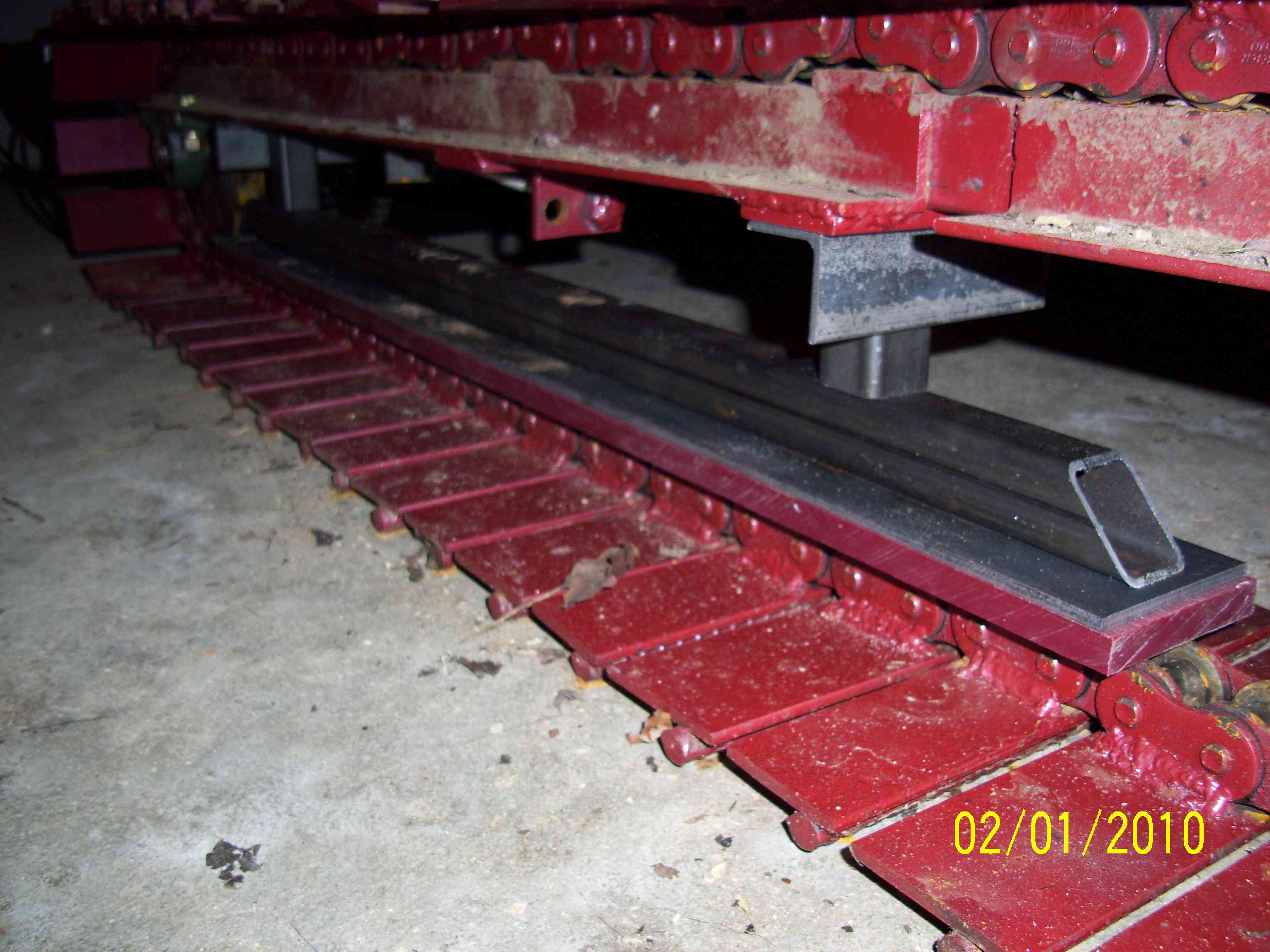

#75
Well I got most of the remaining parts cut but not welded or drilled yet. The two picture show the slide I am working on to support the track between the sprockets. My plan is to pop rivit the UHMW stock to the flat steel with 8 (4 on each side) 1/4 inch pop rivits. I am thinking about rivits because they are easy to install and countersink the heads. The material is much wider than the chain so the heads should never come in contact with the chain. I only have two supports which is to help keep the track tensioner open to adjust/improve it. The open end of the square tubing will be enclosed I just left those parts off for the photo.
Also I plan on bolting the slide supports to the track frame so I can removed the slides for repair and if needed I can shim the slide supports as the UHMW wears.

/ Mini Dozer - Project near complete #76
Screw the rollers, I like this 'slide' idea better.
Any thoughts of a slight groove to keep everybody in line ?
(must be some type of super glue holding those together)(yes, I know, just joking)
#77
The chain is pretty stiff so it doesn't move much. I figured I will let the system wear and see if will make it's own grove.
