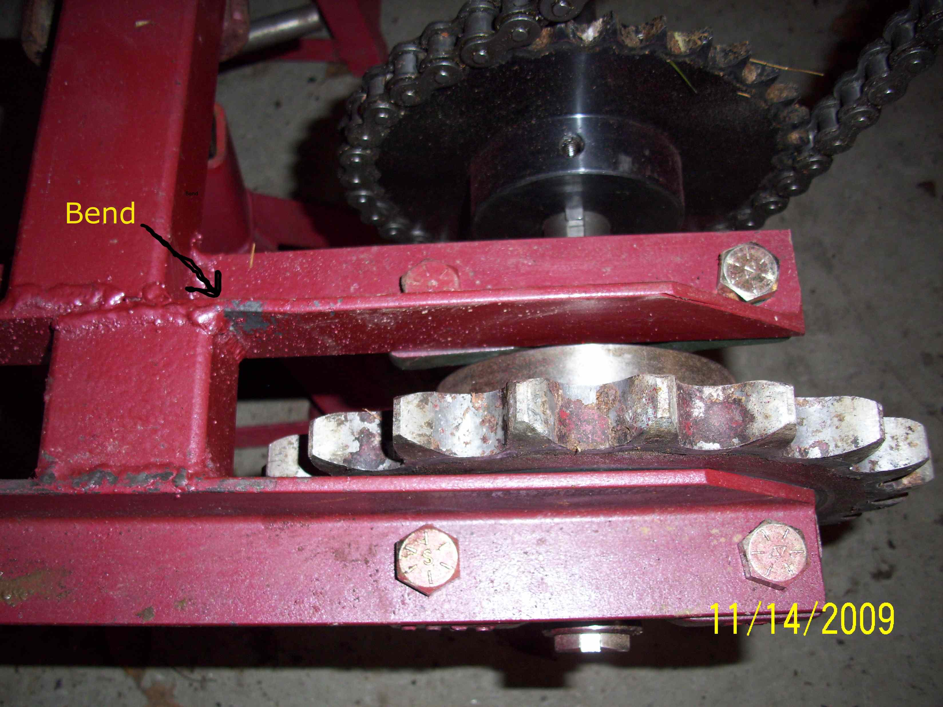

Well I found the issue today. It seemed the motor mounts may be fine I bent the sub frame:mad:. If you look at the first image "Bend Top view" you can see a arrow pointing out the bend. On the other image "bend and proposed plan" which is a view from behind.
Basically I am onto Version 4.0 and will need to straight the angle iron. Weld on additional reenforcement plates (either 1/4 or 3/8 thick) along the angle iron (See image). Along with some spacers and a additional pillow block.
Well like everything it is a work in progress.

It's odd to me that the bend appears to be outward. I would have thought it would bend inward. Maybe you could weld a cross member between the two sides as a stiffener? You're way ahead of me on this one.

Workinprogress, I noticed your sprocket is not aligned with the chain. The inner portion of the axle is too high (needs more spacing). Is that disconnected there? Also instead of just welding a piece of plate on the angle to thicken it, it would be a whole lot stronger to weld in a gusset there on the top and bottom of the angle too. That would spread the torsional forces along the cross member of the frame(the length of the gusset) instead of just in that one area.
/ Mini Dozer - Project near complete #29
Looking at the last two pictures again, the angle of your axle apears to be the whole problem. I think thats what bent the angle. When the axle was tightend against the inner and outer portion of the frame, that's what twisted your frame. The chain is walking off due to the alignment of the sprocket being off. When you get those little bugs worked out... man that thing looks like fun. And to know you built it, such braggin' right man. Cool project.

Ok, read your last post again, noticed you're gonna put spacers on the pillow block. You were ahead of me. That things gonna be so much fun.

I'm still of the opinion that your problem is likely the entire subframe flexing or some subset there of.
You did mention that she works fine until under stress, if it was the bend (which I don't really think it is, at least by looking at the picture), I'd expect it to walk off all the time.

as to the chain, whether the frame is flexing or not i think is irrelevant to your issue as a permanent solution. Frame or bracket flex can introduce the slack that lets the chain come off, but removing that flex will not be a permanent or long term solution - it will simply mean the chain, without a tensioner, will have to be kept tight at all times. It will stretch, and when it's loose enough to come off, it will - that's what chains do. My suggestion is that chain should have a slight bit of slack on the non-pulling side of the sprocket and then a tensioner on that side (or slack side) to keep it taut. That slight slack will help keep the frame flex from stretching the chain prematurely (ie, it will give the chain some ability to respond to the frame flexing forces without having to stretch).
if not, it will stretch, no matter how many times you re-adjust it, and just come off again. And at one point in the stretch, chain will have to be replaced. Leaving some slack, and then a tensioner to take that slack off puts all the "stretching forces" on the pulling side of the sprocket, and minimizes any others.

I am heading out into the garage later today to make improvements. I suspect the chain issue is a combination of multiple issues. The sectioned flexed in beginning with but then after more aggressived testing I think the frame bent but was still flexing some. With some heat and a 6ft pipe I was able to straighten the angle iron. When I first mounted the chain up everything appeared to be in line (using a small square). The photos showing the bend show everything out of alignment. The chain always came off the same way: off the lower sprocket and to the inside of the machine. This matches the out of alignment issue that are from the bend. Also the lack of additional guide rollers on the track added stress to this track sprocket and might have also contributed to the bend. The aggressive test I ran went up some pretty steep hills so this would have put most of the machines weight onto the rear sprocket along with high torqure of driving the track. Not to mention I know the machine is rear heavy from how it turns around.
