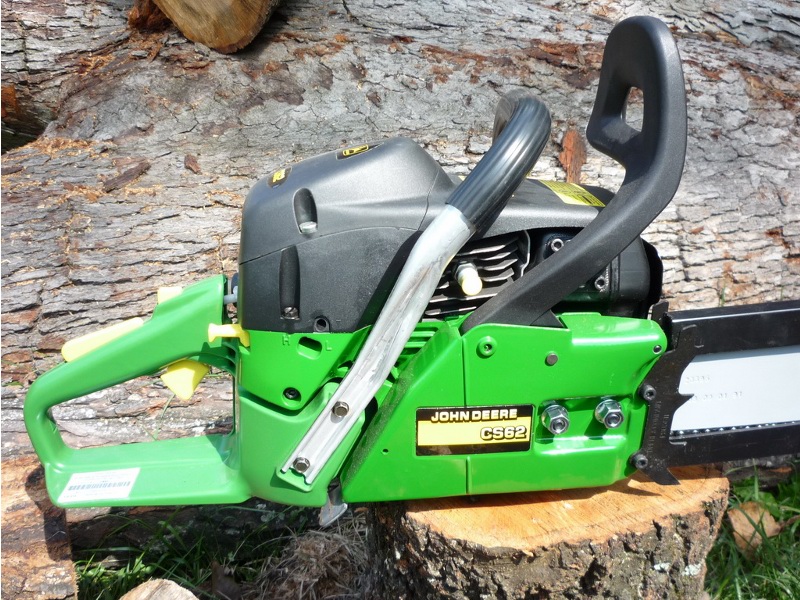

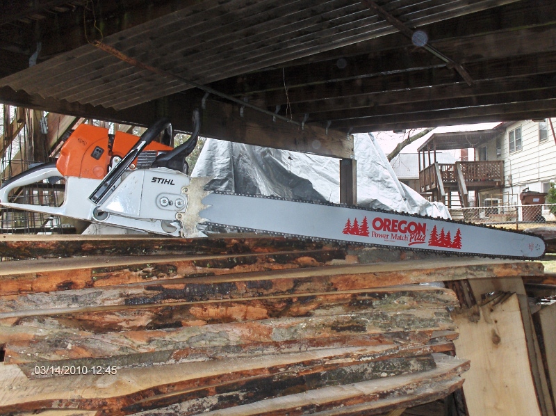

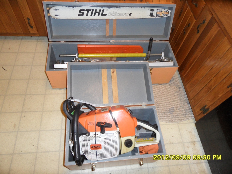

Warning -
Alaskan saw mills can be DANGEROUS!!
I had a nice simple Stihl 021 that I used for very small tree trimming etc. Then I won a JS62 at arborist site
attachment.php
and bought an Alaskan Mark III and a 28" bar.
This led to my first Stihl MS660 and stacks of lumber.
attachment.php
Which lead to making more stacks of lumber with a sawmill
attachment.php
and an even bigger saw
attachment.php
I tell you, milling trees can be addictive!

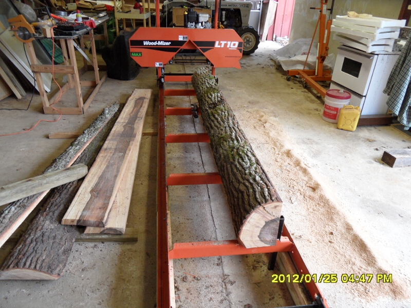

Here is my HF mill. I saw them on sale recently for $1700. that is plus shipping.
I would give it an 8.5 out of 10 rating and my only complain is the track that comes with it will only cut an 8' + board.
I made an extension so I can cut 16'.
Learning curve isn't bad and you can find all info you need on Forestry Forum.
