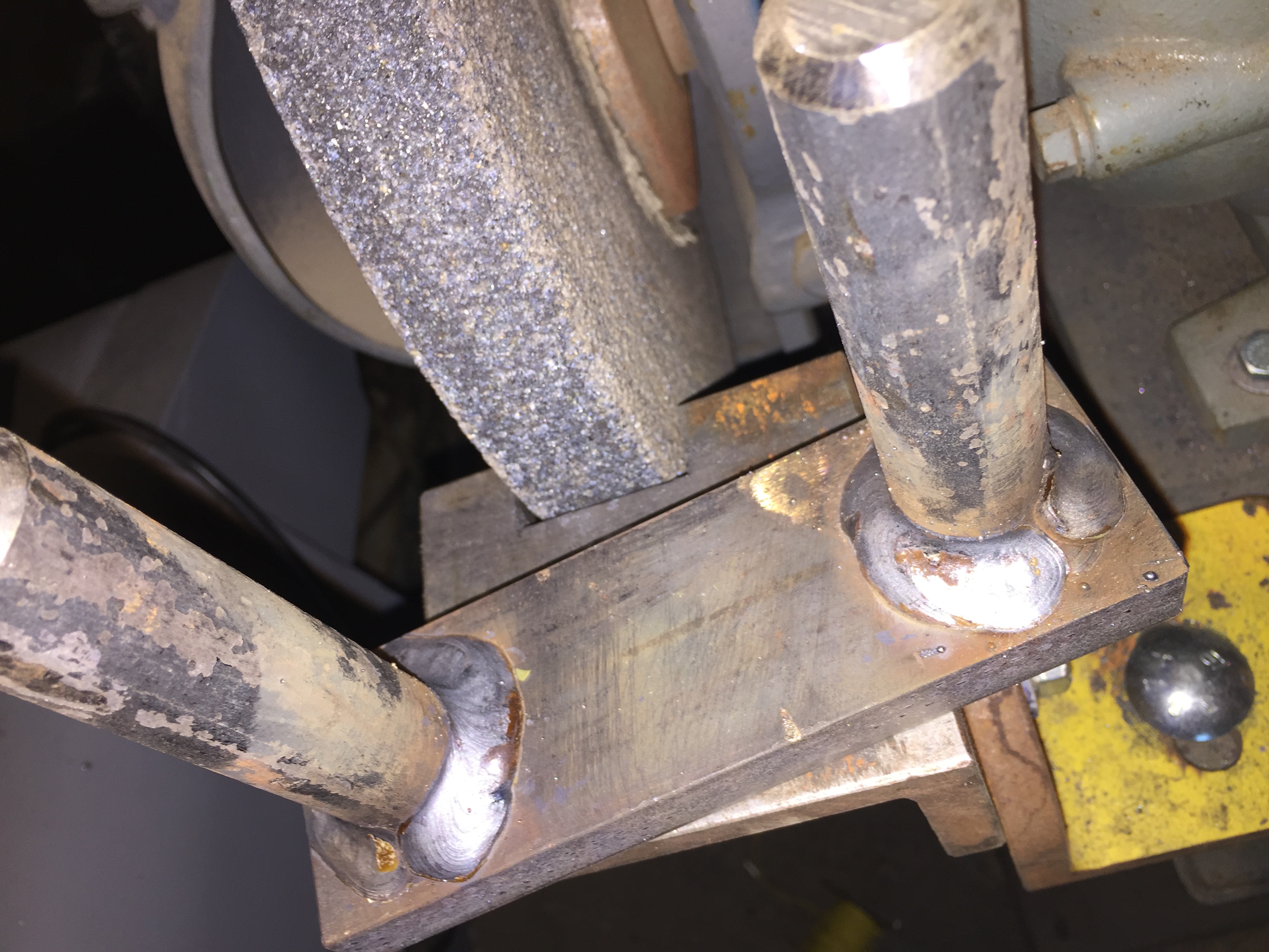

Not the exact same thing, but I have a Lincoln 350mp. Gaud I love this welder. So often I ground out a bad weld not to realize that it was the welder and not the user. This machine just lays the perfect bead after the perfect bead. The attached picture is a max effort short circuit bead I laid down this past weekend. The bar was 1/2" and the rods are 1". I also have my machine set up for stick and I used it for some hard facing. It's incredible how smooth the machine is. I like the multi process capability which I'm not certain the Miller is capable of.

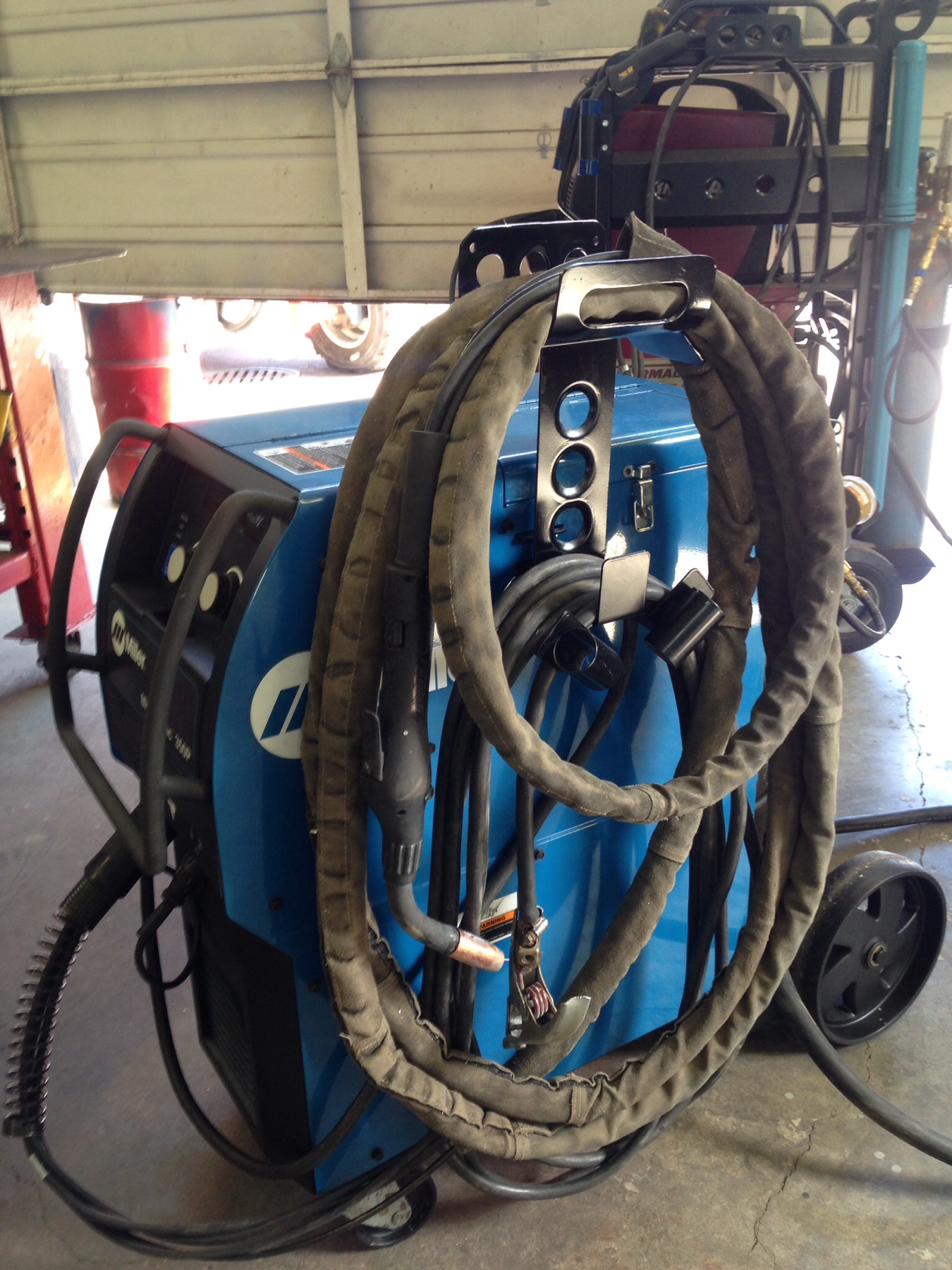

I've never tried welding steel with my Miller 350P. It worked nicely for aluminum with a Python push pull gun though.
I sold it to a friend earlier this year as he had a big aluminum job coming up, and wanted to upgrade from his MM 252. I have spool guns on other machines I can use for aluminum.

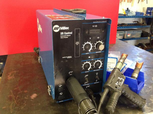

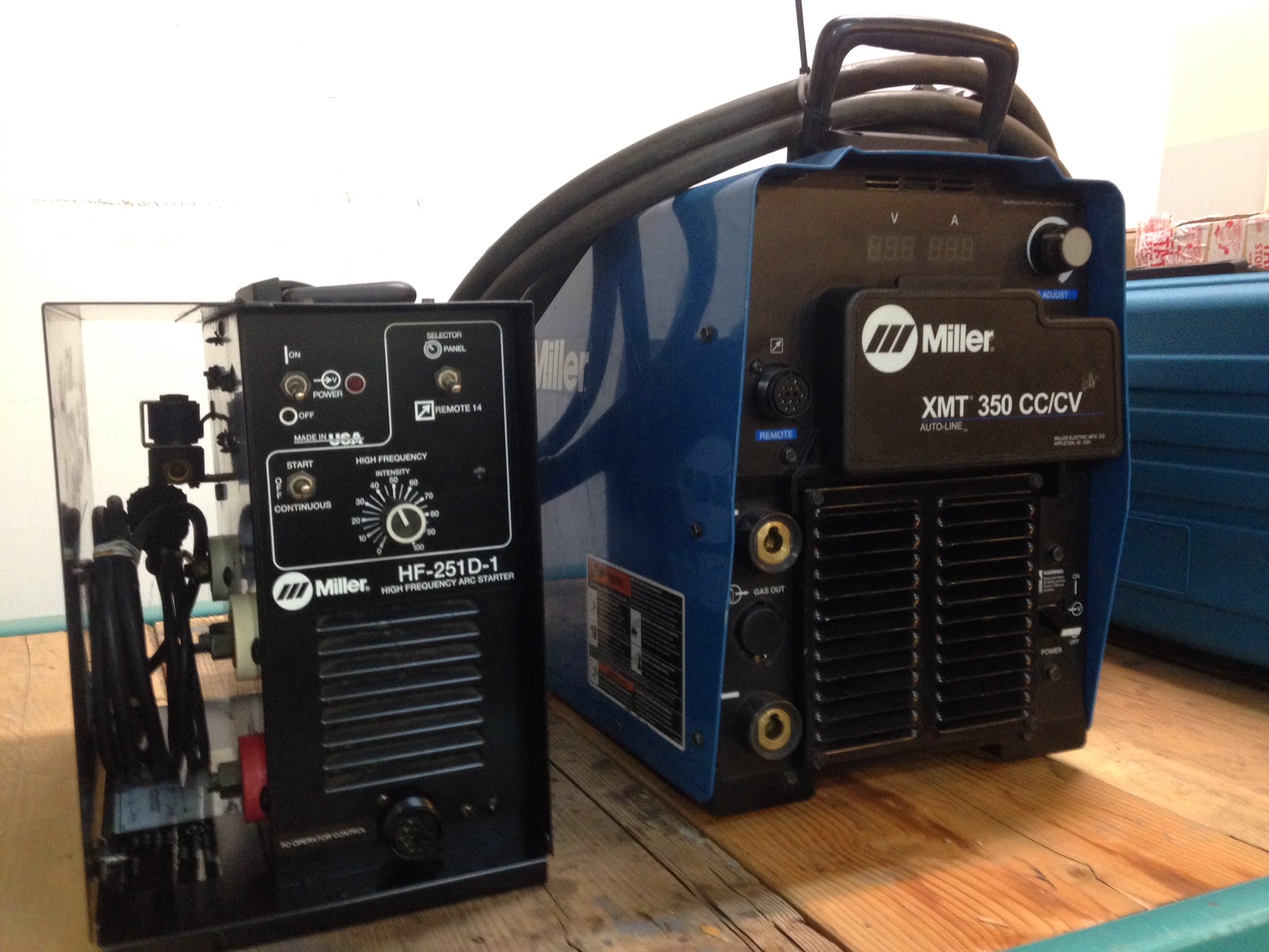

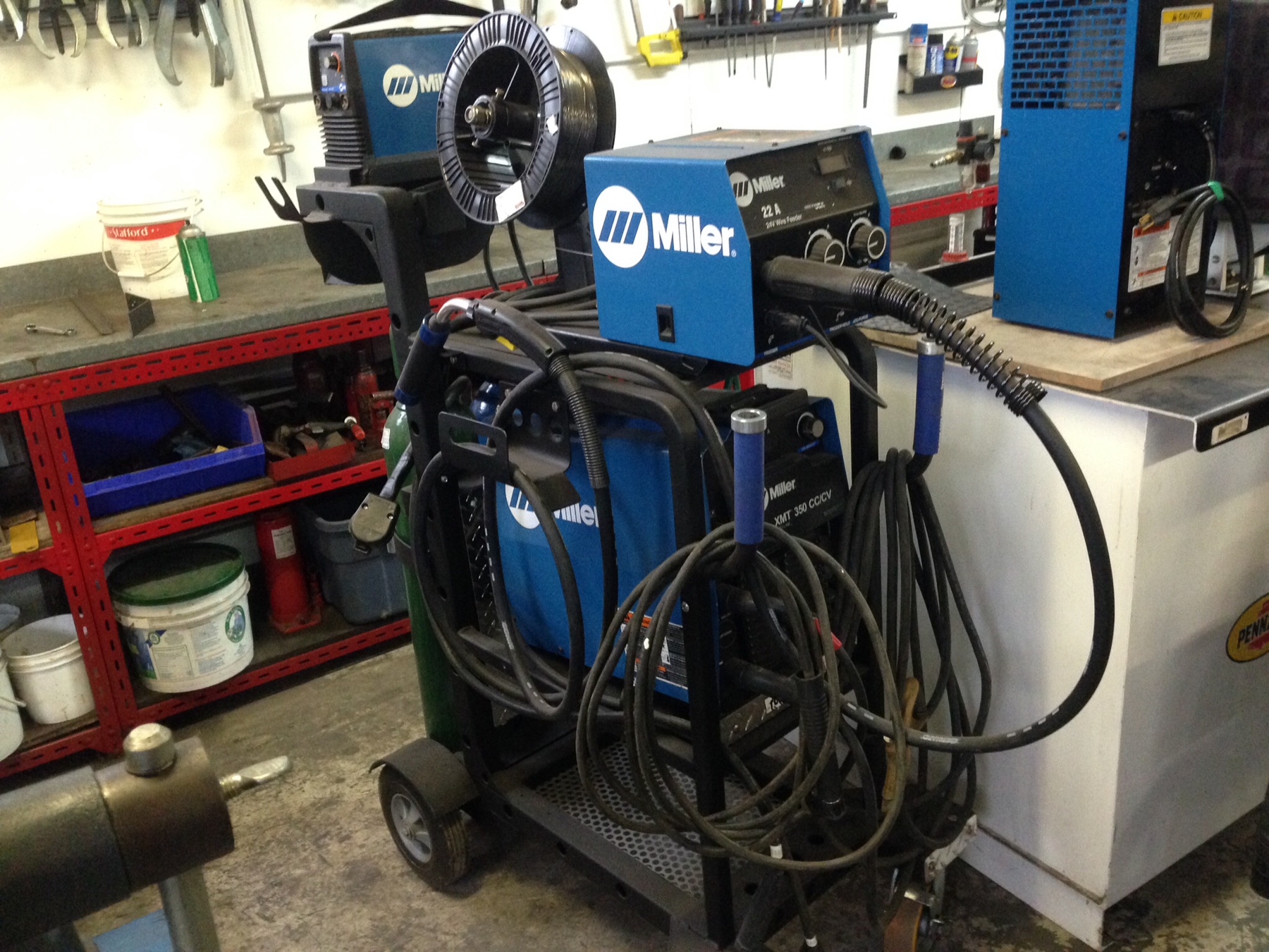

TMGT made a good alternative suggestion regarding Miller XMT's.
It's a good solid reliable (IMO) multiprocess unit. Stick, DC Tig, and will run whatever feeders and spool gun( with WC24 controller) for aluminum.
I have a 350 XMT. I've since sold the XR feeder with push pull gun when I bought the MM350P, but still have a spool gun for aluminum.
Here's pics of mine with some of the accessories.
Great flexibility for adding the features you need.
