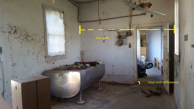

I am planning to turn my milk house into more usable space.
The first step was gutting the pipes and equipment out of it.
The inside walls are a concrete type plaster on top of some kind of wire mesh.
The floors are poured concrete. Circa 1920.
For the floors, I was thinking about a vapor barrier and a new sub-floor. That would mean raising the height of a door.
Another option would be a pour of a lot of self leveling concrete.
I think I am leaning towards a new sub-floor, due to the volume and ease of not working with concrete.
Thoughts?

I am looking at a "drop" in the middle of the floor hitting close to four inches. This runs the length of the building.
What do you all think of the adherence quality of the concrete up against that old stuff?
I plan on installing plumbing too, so I am leaning towards a floor build up.

4 inches changes everything. You wouldn't want to do that with self leveling for sure!!! I would hire it out if pouring concrete, but if you did that, you would want to raise the high side at least two inches, which doesn't have any advantages over building it up with wood. Seeing your picture, I think I'd frame it up level and put down plywood or Advantech subflooring.

After the original concrete is cleaned, a bonding agent has to be applied. Then some pins should be drilled into it to lock the new concrete in place and hold up the rebar. The existing concrete will make a great base. If done correctly, you would never know it wasn't original and it will be there for hundreds of years. But going with wood will be faster, cheaper and easier.

I'd go with the floor build up..

You've got plenty of ceiling height so I'd second that and go with Advantech. Then you can run plumbing under the floor.

2X4's for flooring joists or 2X6? That is the question. Since they will be set on top of the concrete. Does size matter?

Your joists are just really shims to level and support your decking, and since they do not span anything, you can use the smallest lumber you need. Spacing is more important. 24 inches apart is standard for 3/4 ply or bigger. I prefer 1 1/4 for decking, but it's more money and super heavy. You can also go closer together if you are going to have some heavy loads. 19.2 or 16 inches will only add a few boards to your job, but give you a lot stiffer floor.

The joists may not have full contact with the floor when level. Depends on the unsupported length of joist.
What clearance will you need for plumbing? (Joist height) ?
What will be the he future use?
Type of heating? (In floor) ??
Prevalent moisture in buildings?
Just questions to ask yourself.

Yes all valid.
Plumbing and heating are of no concern, the moisture question will have to be addressed.
It's a man cave. No just don't tell the wife.
Eddie I will make it stiff and able to support a nice pool table.

Egon brings up a good point. While I doubt you will have more then a few inches where the 2x doesn't touch the floor due to irregular dips in the original floor, the more contact you have the better. After cutting, I would use liquid nails or something similar to secure the 2x's and shim any gaps you might have. Take the time to get it 100% solid now because you never will have this opportunity in the future, and a springy, or squeaky floor only gets more and more annoying over time!!!!

Self leveling is pretty low psi stuff. I've seen it dust up at door ways before the rooms could be finished leaving a trench that needed to be filled. I would never recommend it be left unexposed.
If you raise the floor, you'll screw yourself on the doorway. Honestly, if you "need" the floor to be level, I'd bust it out and repour. This way you can hit your sill height and still have a flat floor.

I have opted on raising the floor, and will raise three doors (one outside, two inside) in the process. Two other outside doors will be closed off and the building will be re-wrapped with vinyl. It's a lot of work, well not really, just a lot of busting out the old wet sheet stuff on the inside. I have worked in there already, repairing all the holes in the walls, and it has a fresh paint job. It use to be my laundry room as I was "remodeling" the farm house. LOL. A truly multi-use building over its lifetime.

It should be easy enough to raise the height of the doors. A lot of old buildings didn't even have headers over the doorways. But if you are going to do it, might as well make it as strong as possible and put in new jack studs with a header.
