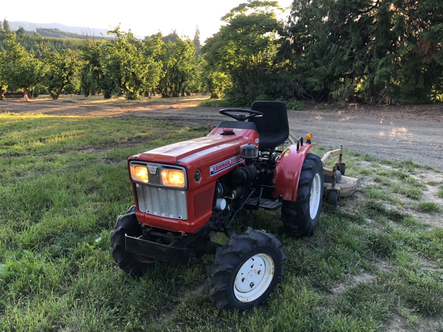

Finally getting the wiring dialed in on the 186D. Headlights and work light are now working, new orange flashing lights and switch, and now the horn works.
The wiring on these are fairly straight forward! But that does not mean that there is not a large time investment involved to trace it all out. Then you have the issue of do I repair 30+ year old wire? or run new wire realizing that newer insulation attracts varmints to chew on it?
That becomes a decision from looking at overall condition of existing wiring in my opinion. One thing I would encourage if you decide to replace wire is to route wires into a few main runs of multi wires and use wire loom. You may wish to use a loom inside of a loom, although I fear that the looms may suffer with the same food smells that insulation does from production process of recycled materials.

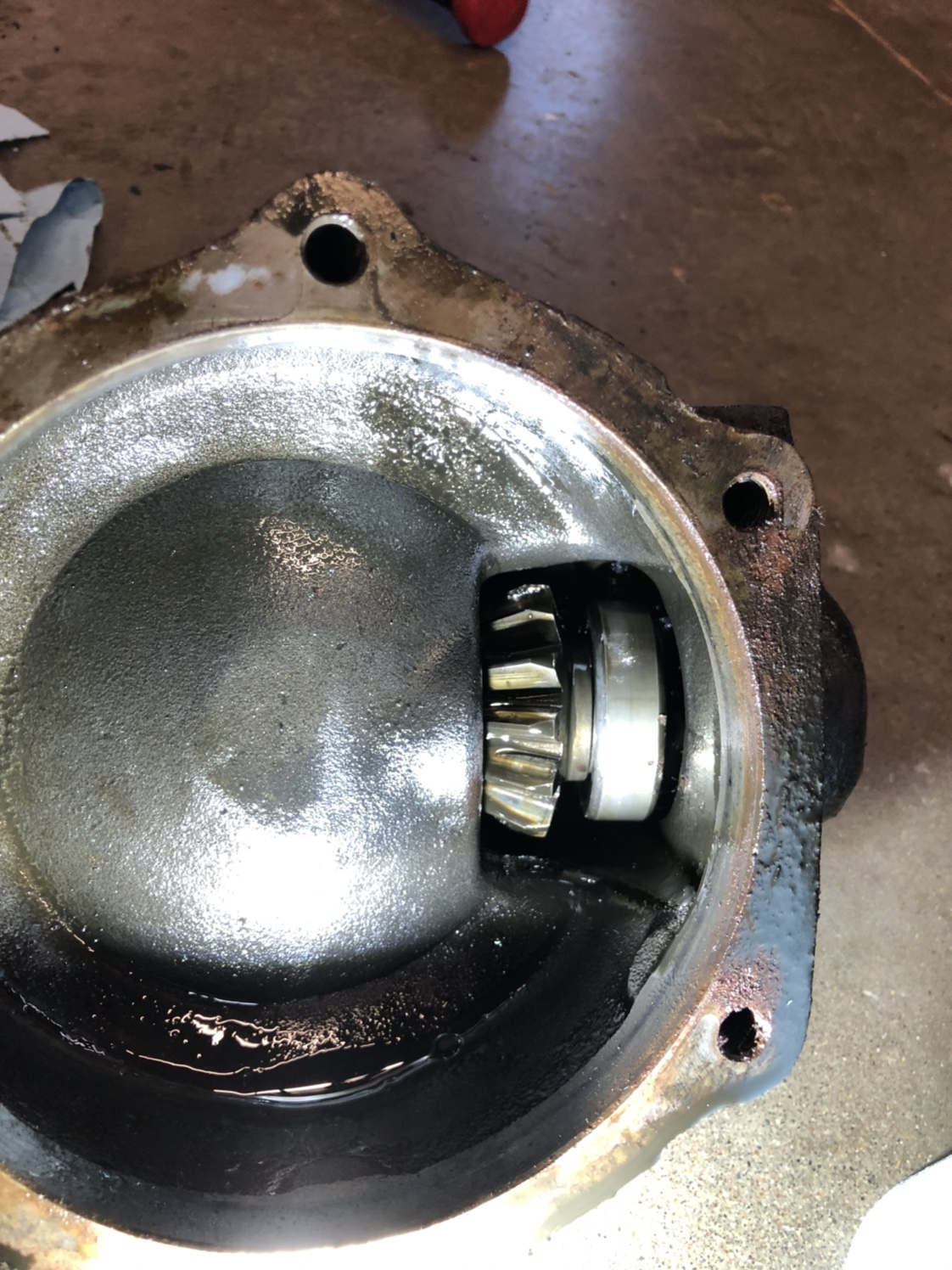

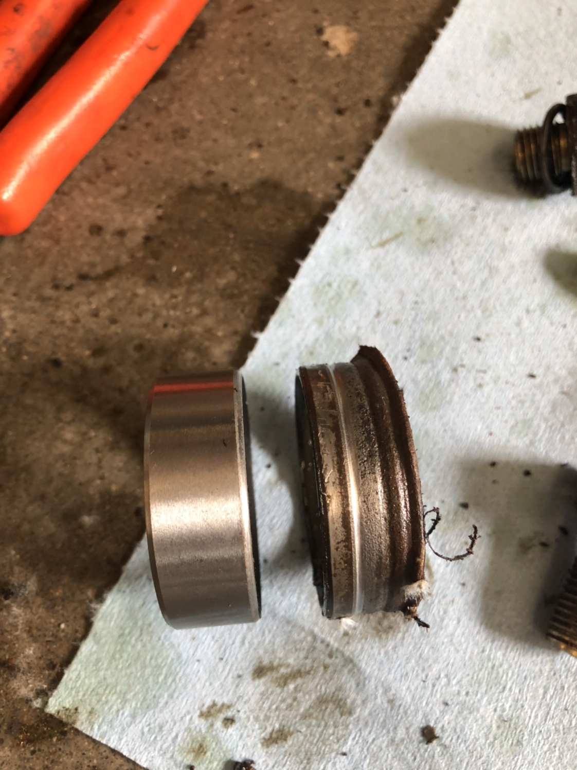

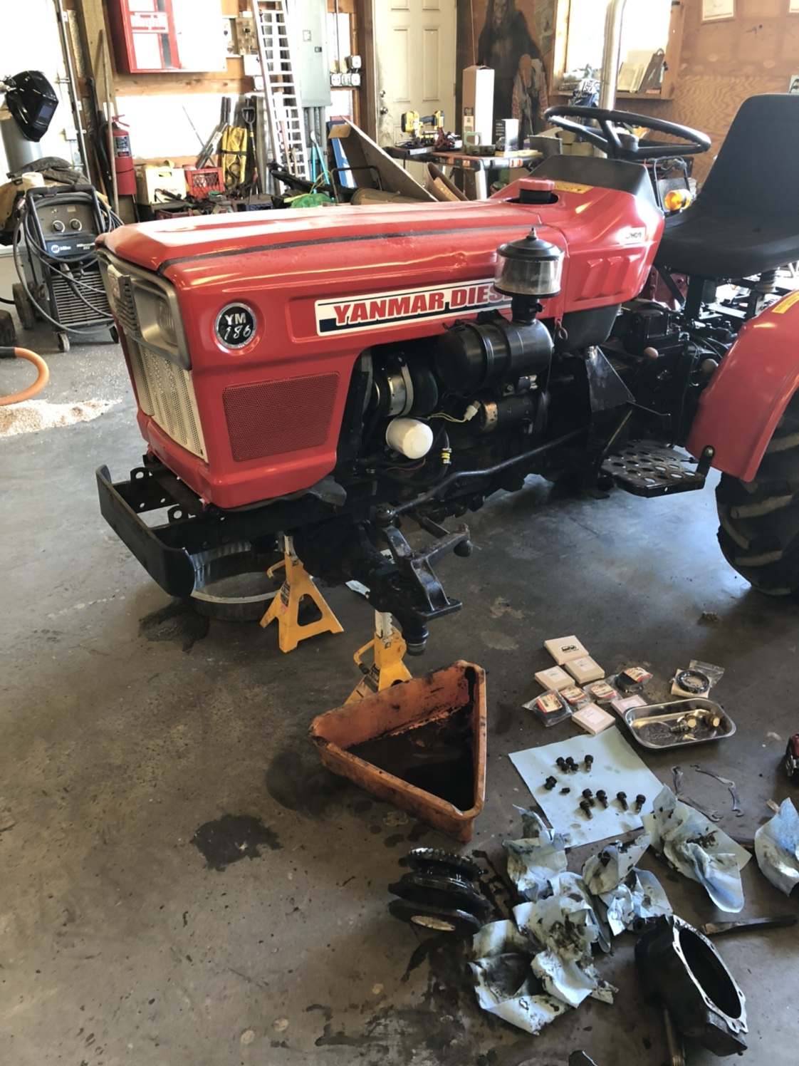

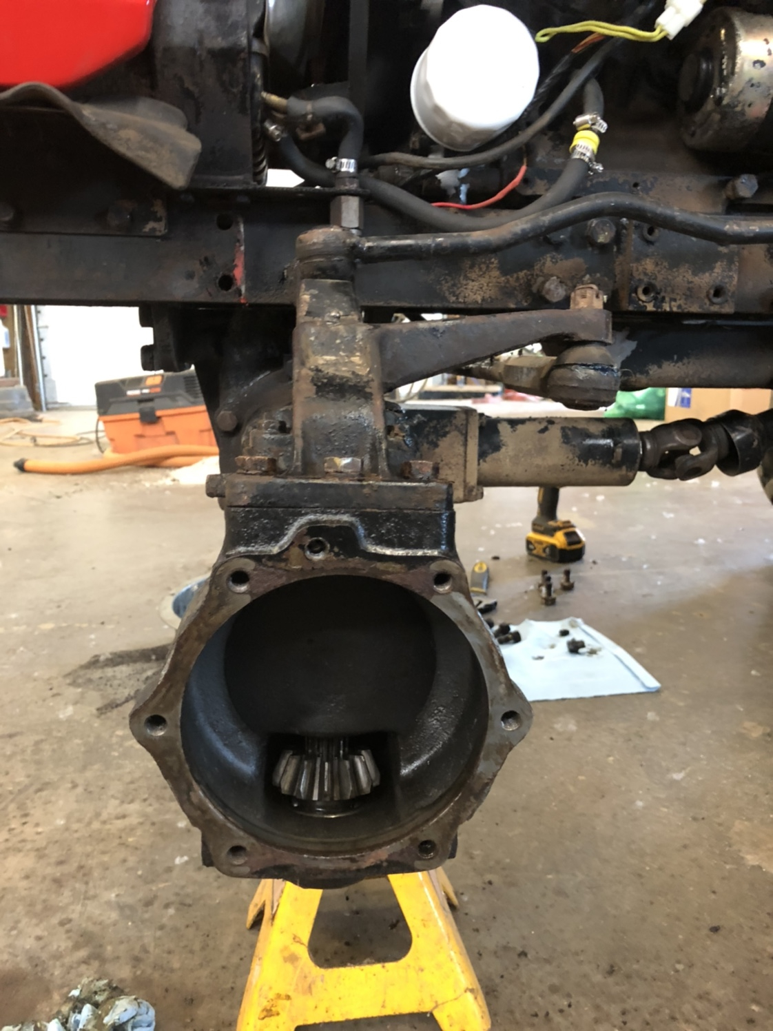

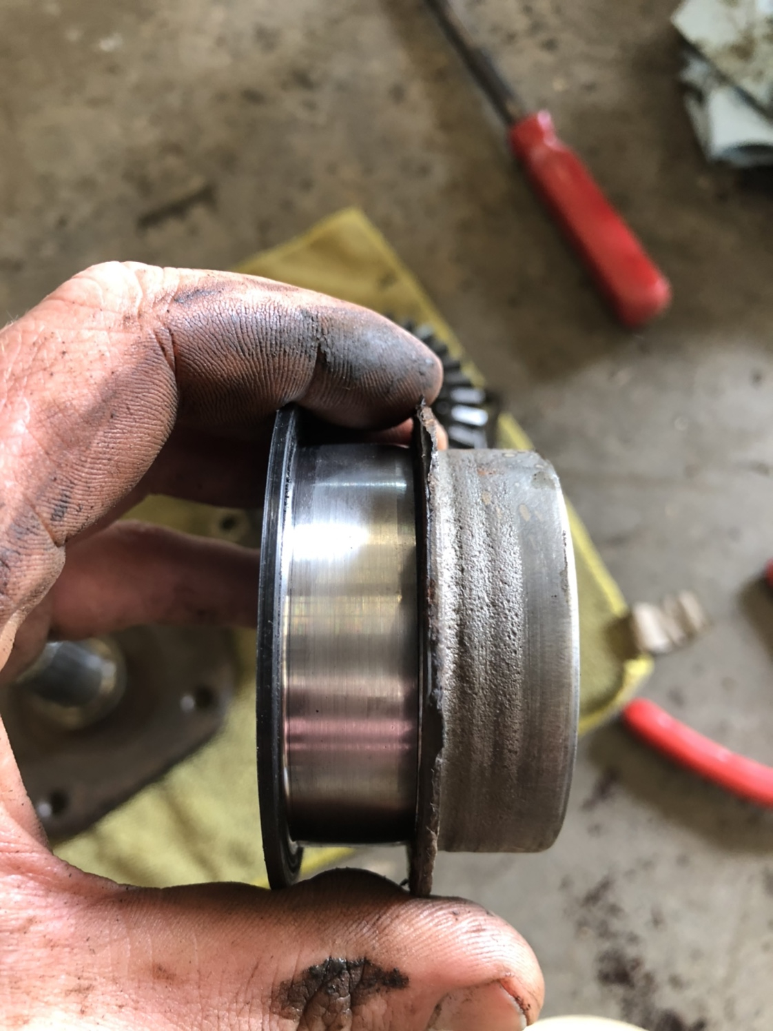

Started in on resealing the front end tonight and ran into a minor issue. Based on the way the manual reads the stub shaft should just slide out of the knuckle bit the bottom bearing seems to be stuck on the shaft. Any recommendations on how to get the shaft out so I can replace the seals? Any suggestions on where to get new o-rings for the front hub assembly?
   / Might be getting back into a Yanmar #55
Have you tried getting between the gear and spacer with a tapered screwdriver to get it started? Any o-rings will be Japanese standard.

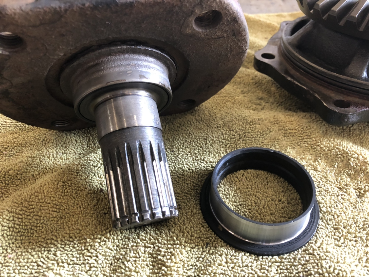

Finally got the 186D done today. As you can see it was definitely time for new seals and collars. Got some fresh seals and collars installed and refilled with some 90wt gear oil and so far it seems to hold. Gave it a quick wash since gear oil managed to get everywhere in the process.
   / Might be getting back into a Yanmar #58
I think it's safe to say I think you found the source of the leak!

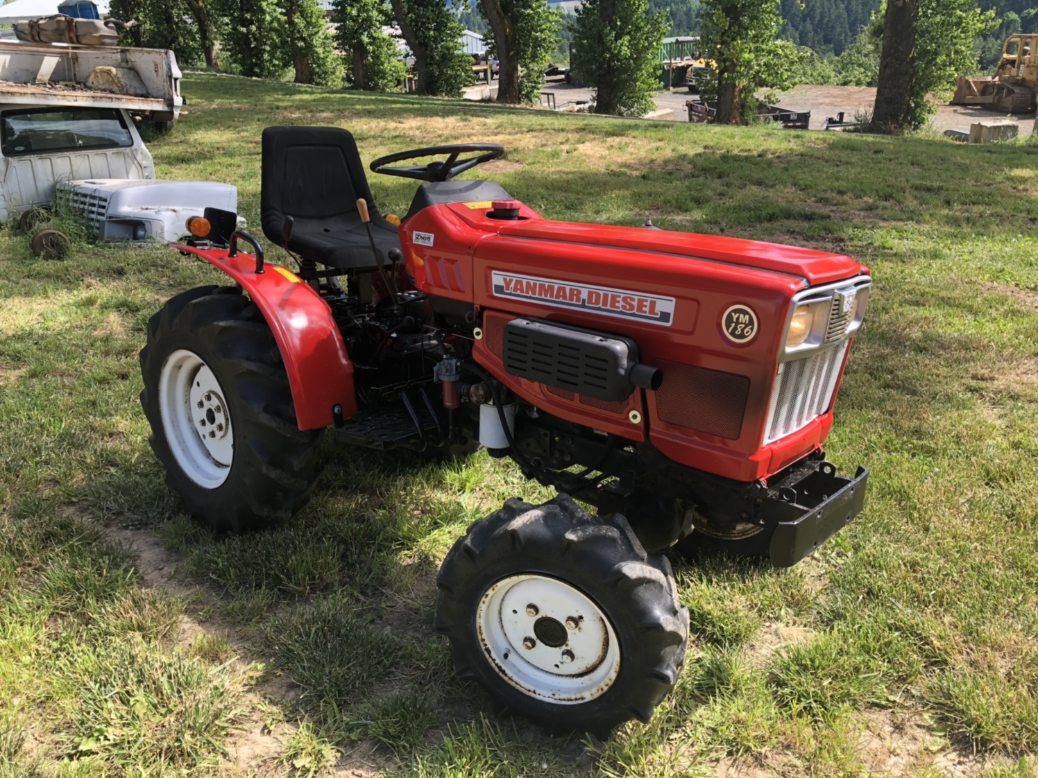

#59

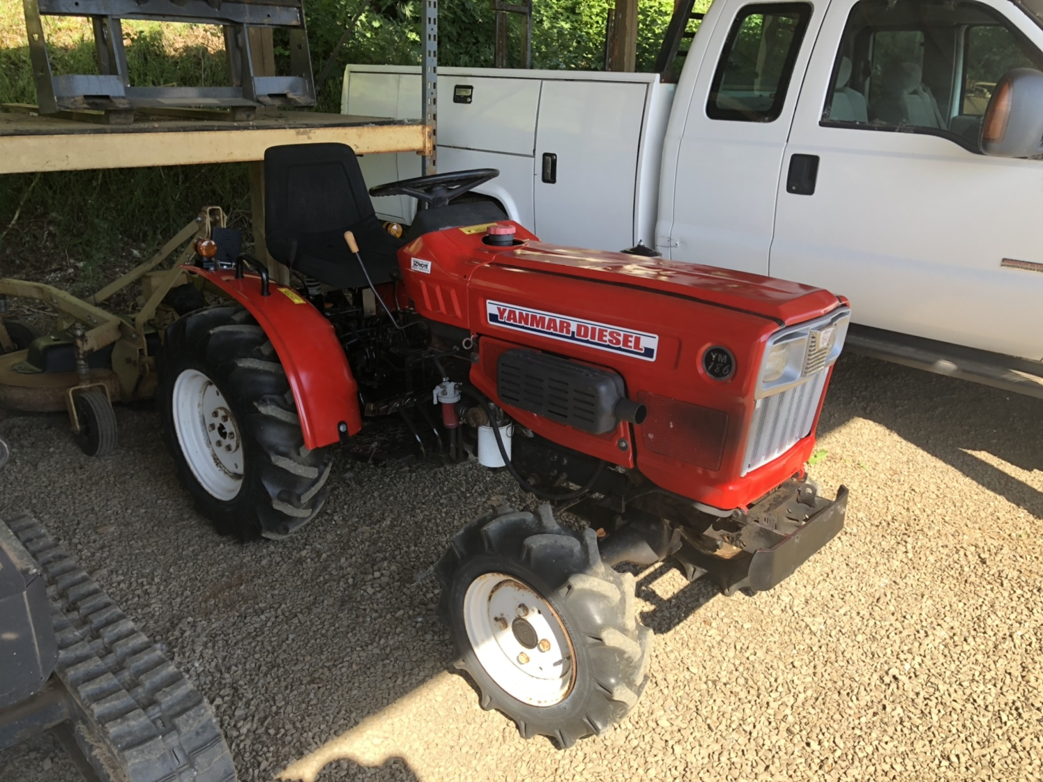

Said goodbye to the 186D the other day to another forum member. Now to turn my focus to the 226D.
   / Might be getting back into a Yanmar #60
Oh I bet the other forum member is happy too! :)
