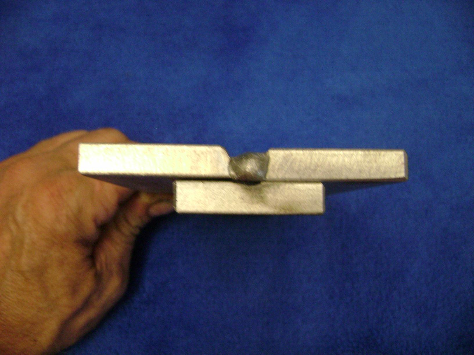

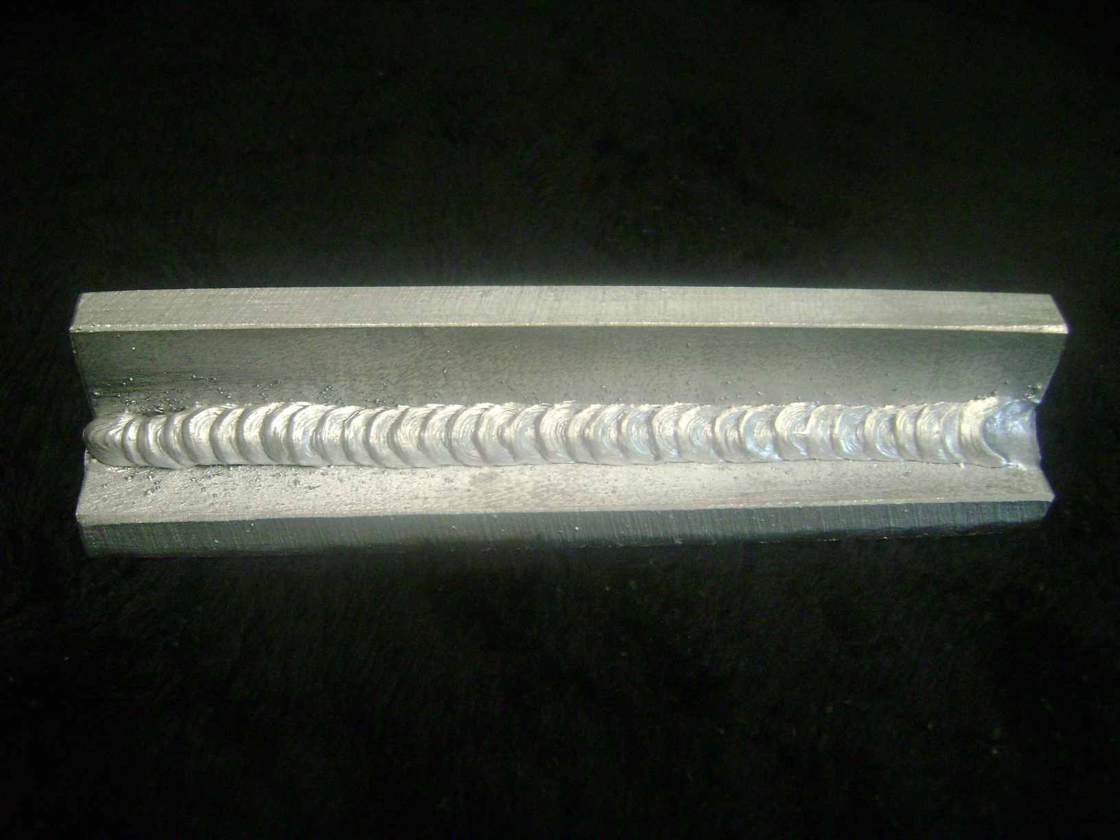

If you need to weld aluminum with a 115v unit you really only have a narrow window. Install a teflon liner in your mig gun. Run only 4043 .030 wire preferably with U groove drive rolls. Turn wire speed up to max and adjust voltage until you get a nice hot flat weld. Once you get there, That is your only option. It will be about 1/8" Aluminum..No more no less. If you have to do Aluminum that is less than 1/8" you need to go to beat the band to keep from burning through. Or buy a new Twin Pulse unit for $7k and never worry about it again.:thumbsup:
/ Mig welding Aluminium #13
I bought a Cobramatic, (push pull) for $400.00 and run it off my $300.00 Mig machine. :D
