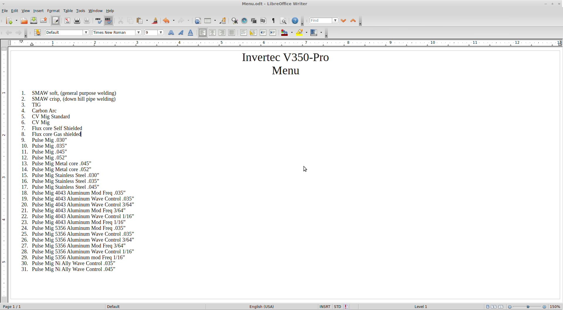

/ Mig - stick - tig multi unit? #3

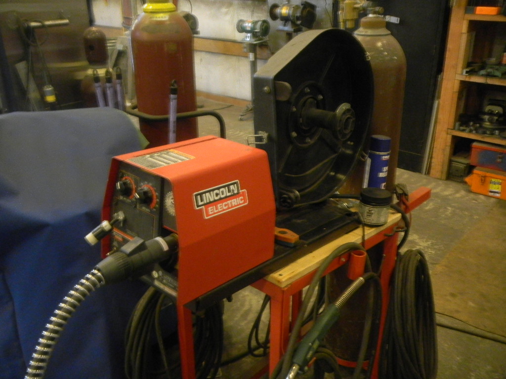

With my multi function machine it is a matter of how fast you can spin the dial. As yomax4 says I have to plug in cables for the spool gun or wire feeder. But this takes no time at all.

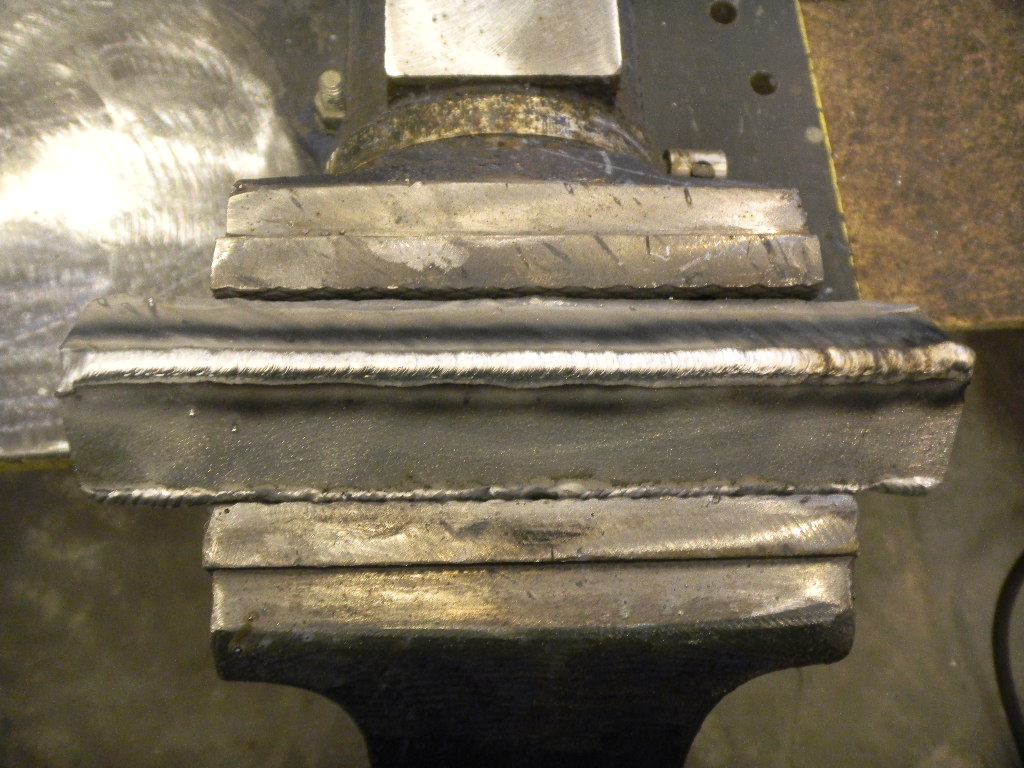

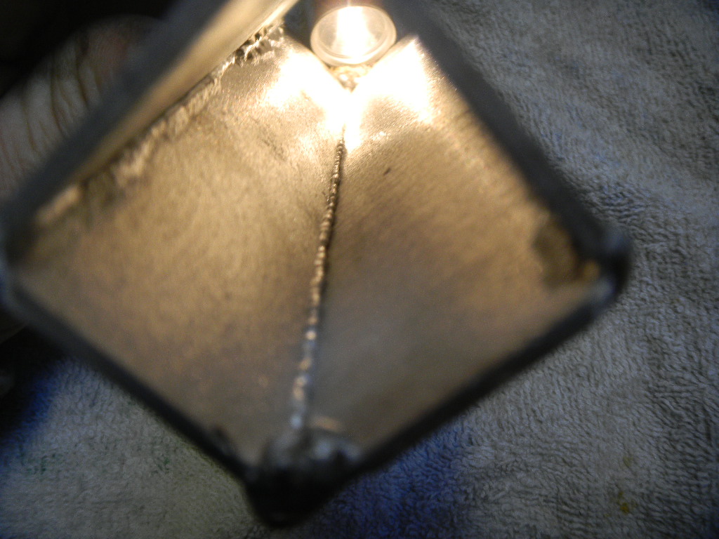

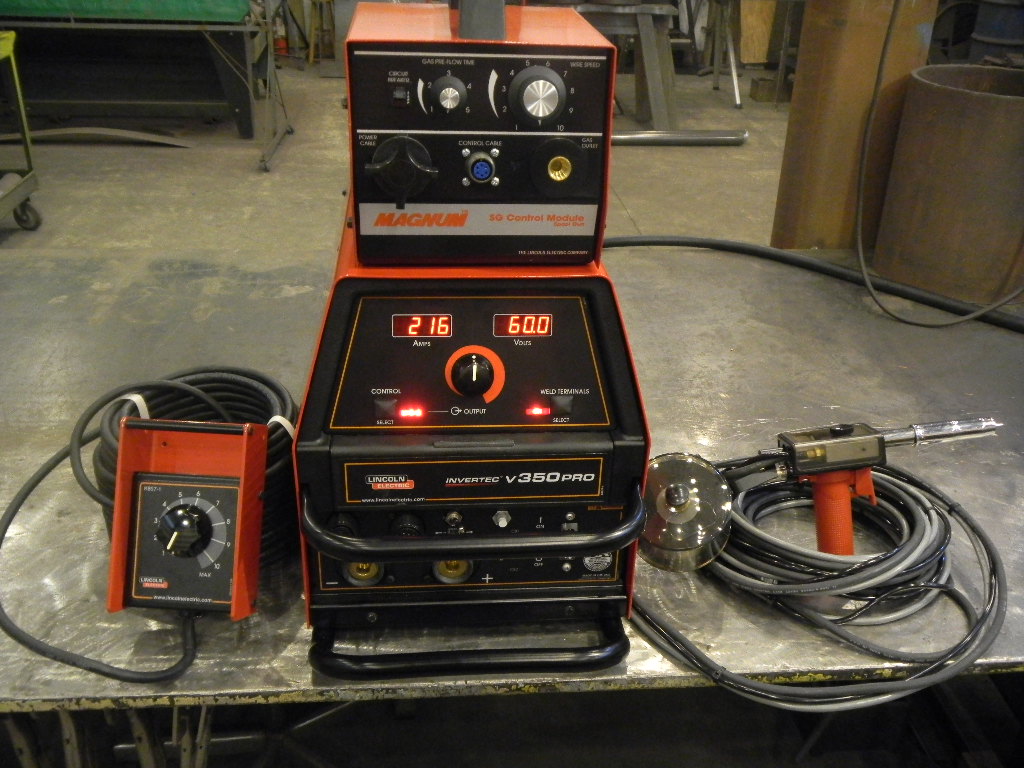

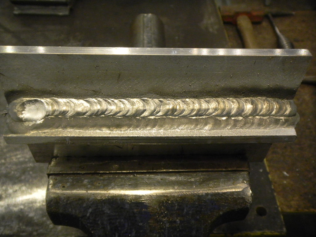

How good do spool guns work? I have never used one but when I do my aluminum, I would like to do up to 3/16 to 3/8 structural for a small boat?
When I first got my V350-Pro this is what I did on some 16-GA, and 3/8-inch aluminum.
