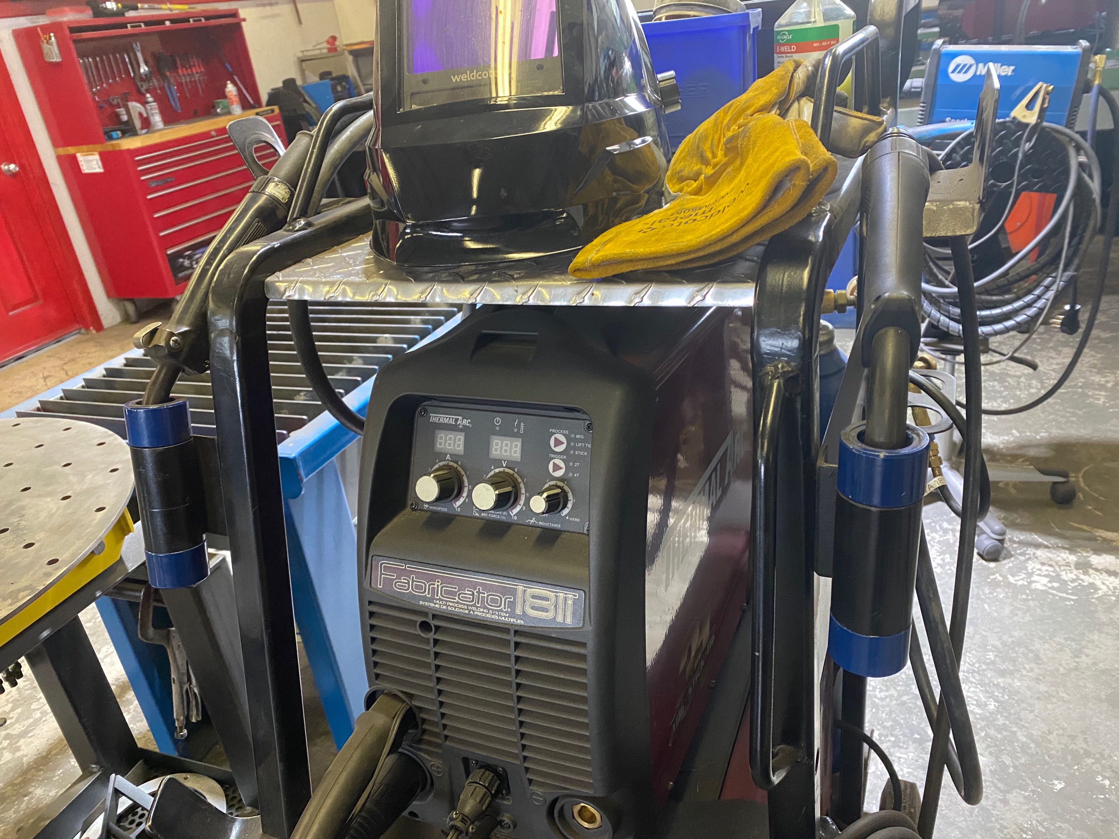

I can’t think of an effective guard. The best I can do is be cognitive of how and where I place the gun when the the welder is energized.

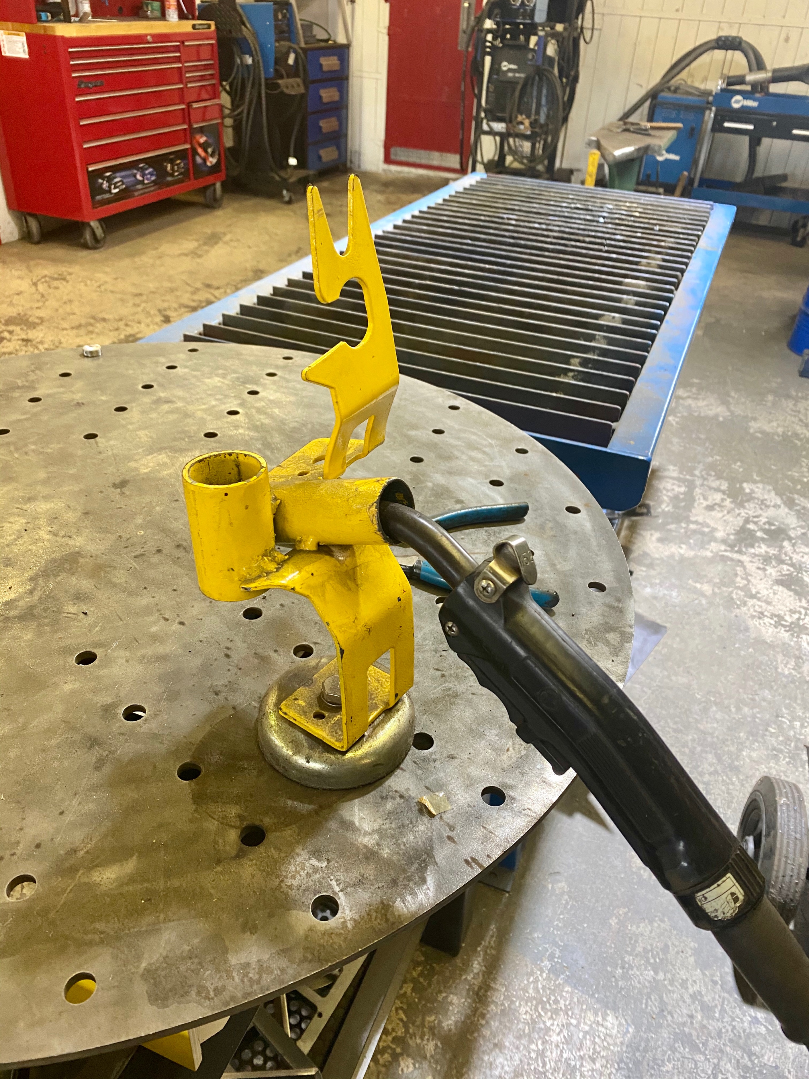

Storage spots for gun on cart...
Portable magnetic base. The vertical socket is for the plasma cutter torch...

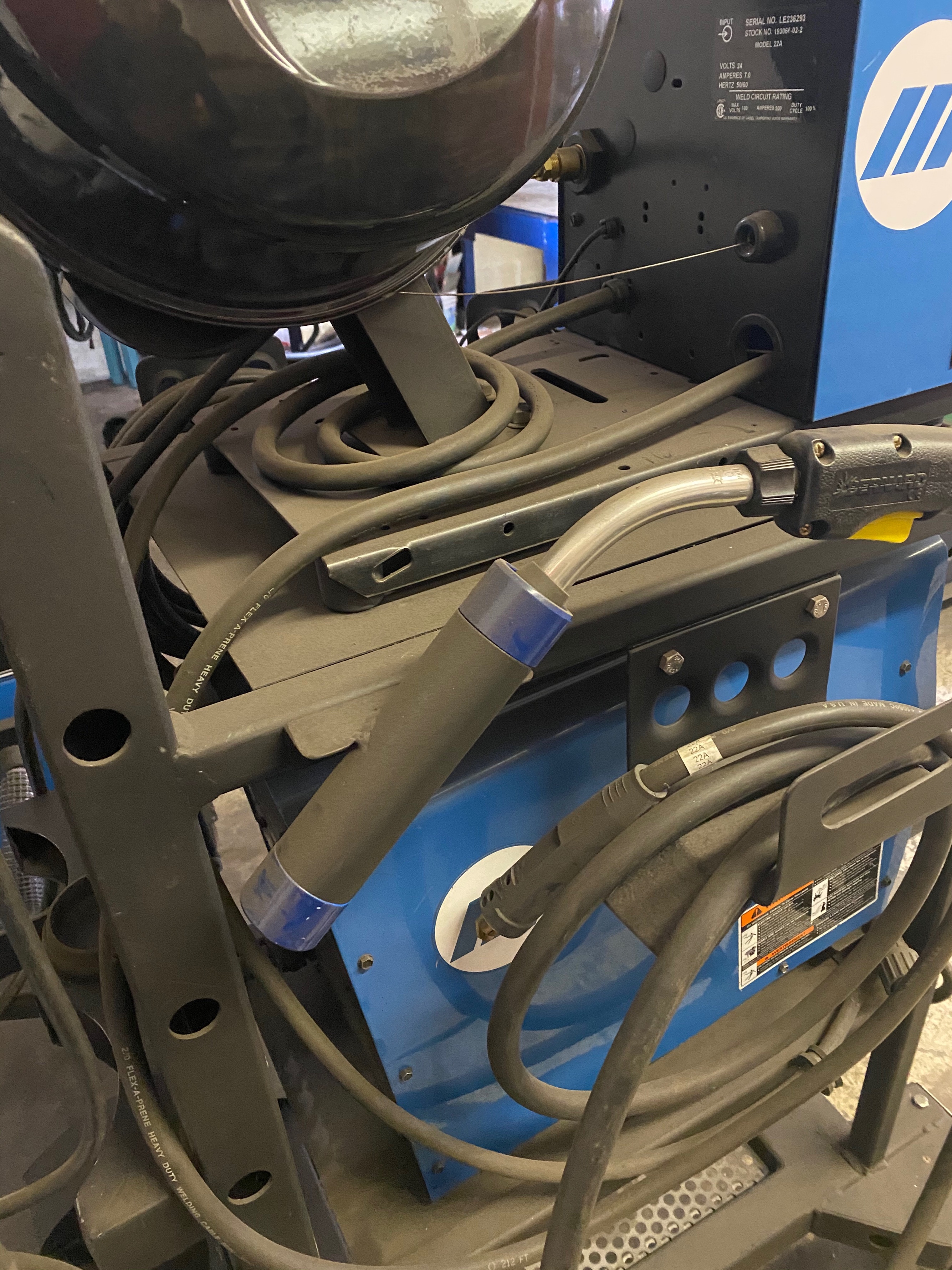

Most times I hang it like this as it is quick, easy and relatively foolproof.

I like that mag base multi holder... looks 'not homemade', but I'd sure copy it for my own use in a heartbeat!

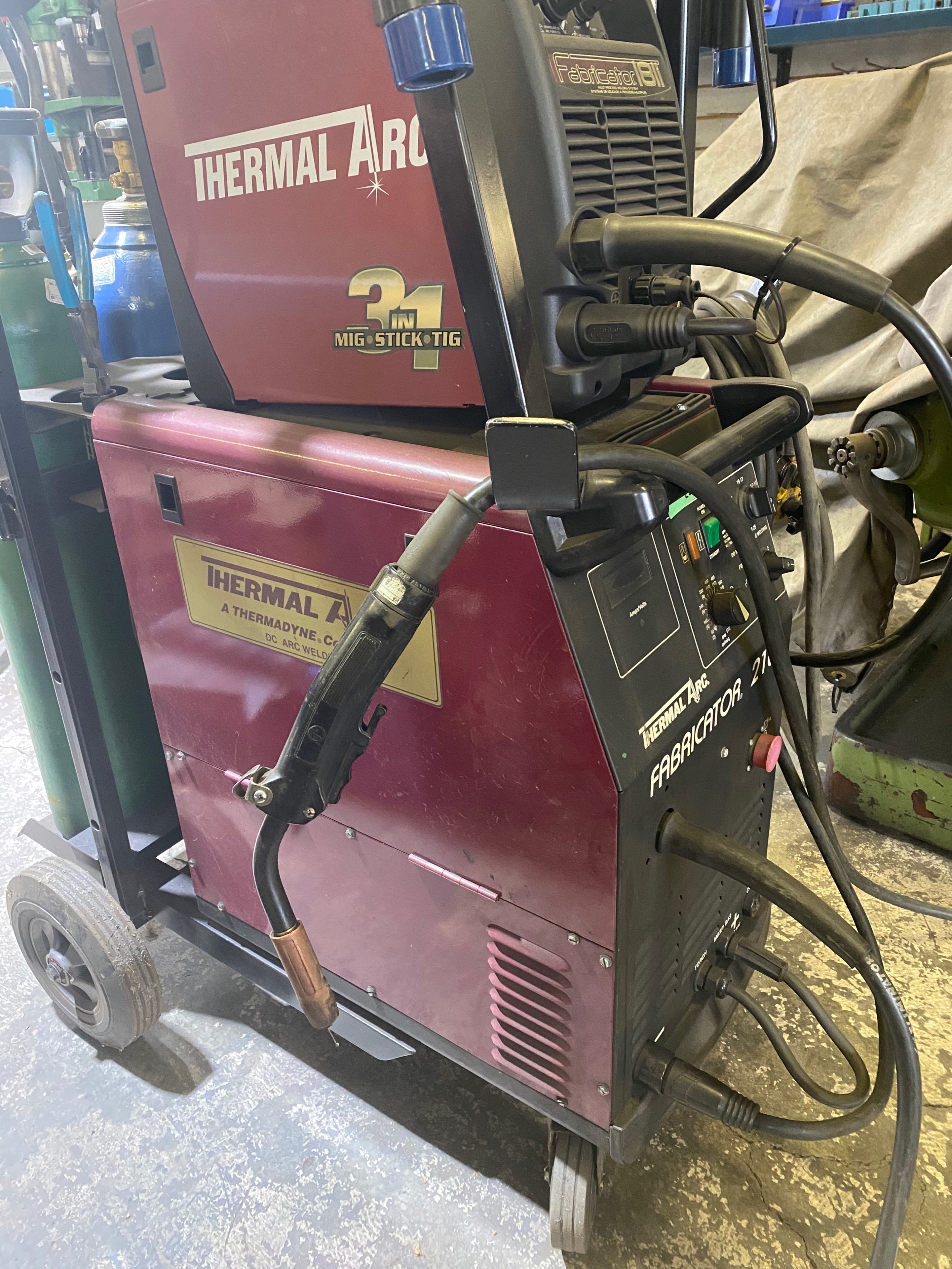

Everywhere I weld I stick a scrap piece of pipe welded on to table legs welding cart ,gas cart ,anything .6-8 " pipe welded at a 45 perfect holster and it's free':cool2::drink:

Ummm... Do not have welding table (yet?), that is another dream out there a bit... So magnetics are probably out... Probably have to go with pipe/tubing sleeve on welding cart, and get into habit of "holstering" gun at cart....

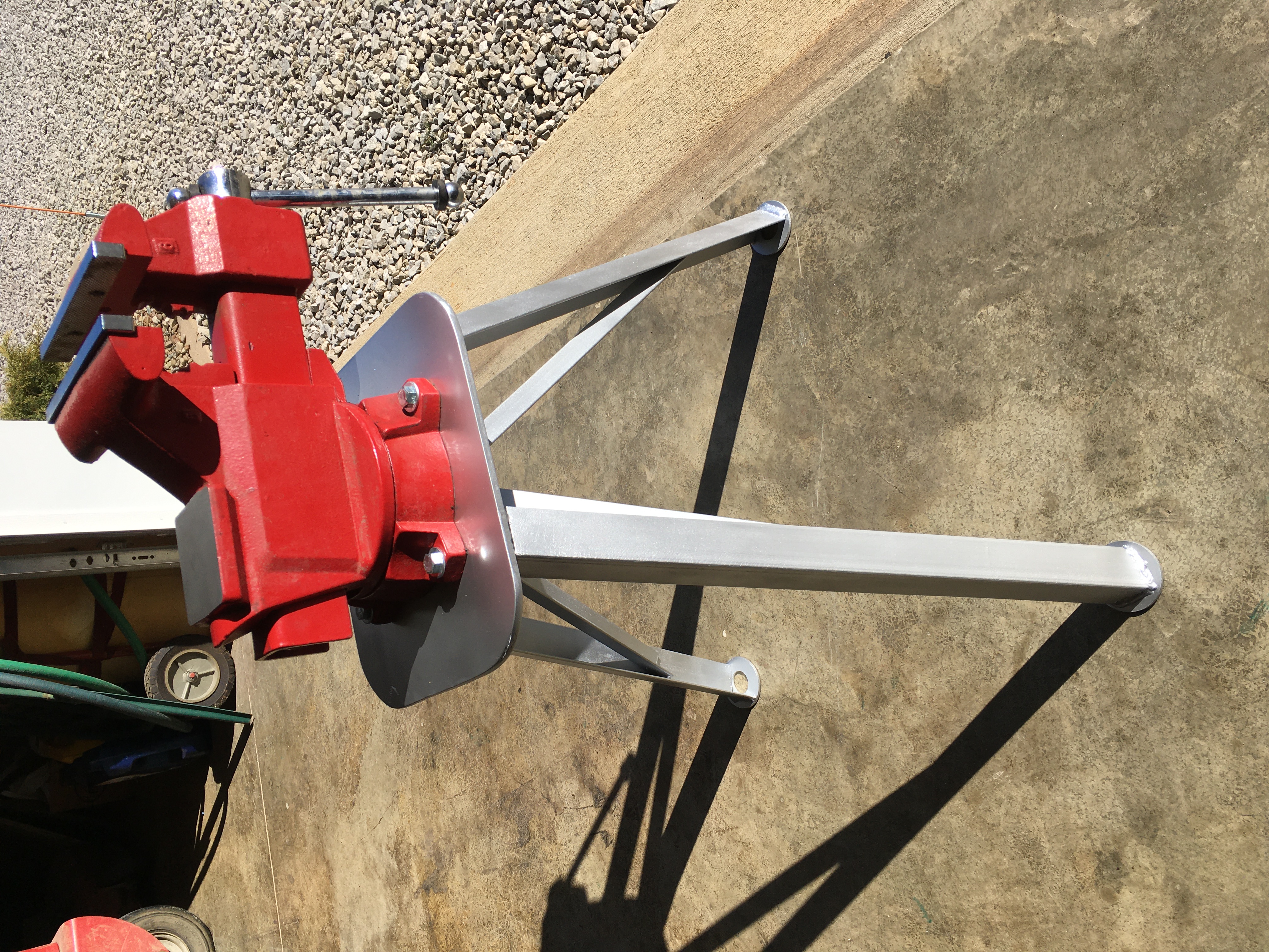

I recently decided to make a stand for a vice I have had too long, without having built the bench it was supposed to be mounted on.
A simple build, and I had all the material on hand.
But then, I realized I was most of the way to finally having a welding table. :thumbsup:
So, another simple build, with materials on hand.

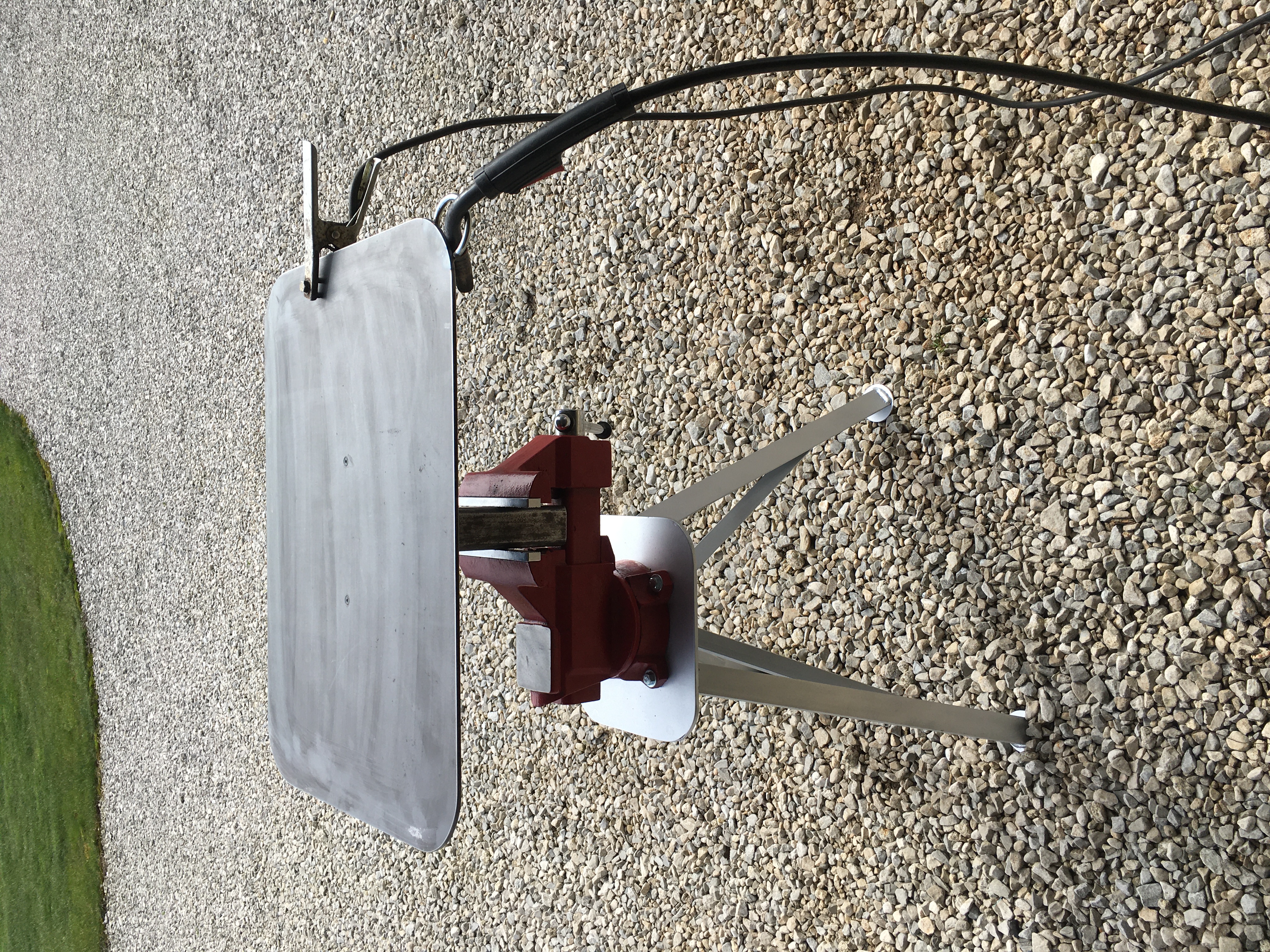

And, that led to the mig gun holder, which is a ring welded to the welding table.
Bonus, since the welding table is held by the vice, it is height adjustable. :cool2:
Now, I can't think of a reason why I didn't do this sooner.
