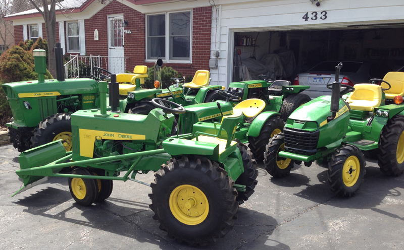

Today I am changing oil and filters in the jd 455 2 wheel steer Diesel/ snowblower tractor . Then I will pull in the jd 455 diesel 4 wheel steer tractor and do the same. Also todays pics show yesterday me pulling out 7 of my 10 little tractors. If things go as planned I will then pull the jd 110 round fender in the shop and begin the first center mounted grader blade project. I actually have three tractors I want to build center mounted grader blades for . I will end up selling all 10 mini tractors one day and because they don't have mowers they might sell better with a grader blade . :laughing: aaachangeoil.jpg

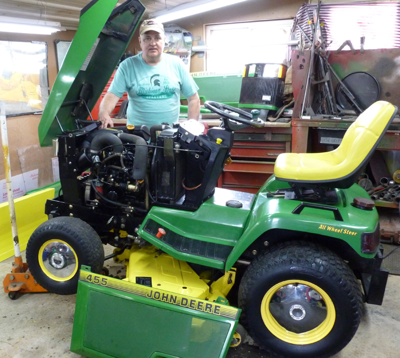

Today I pulled out the jd 455 with cab and snowblower and pulled in the jd 455 mower tractor. Change oil and filters and sharpen blades. Just a wax job yet, wax on , wax off:dance1:
Next tractor in the shop will be the jd 110 round fender and when it is pulled out it will be sporting a new mid mount grader blade:cool2:aaaallwheelsteer.jpg

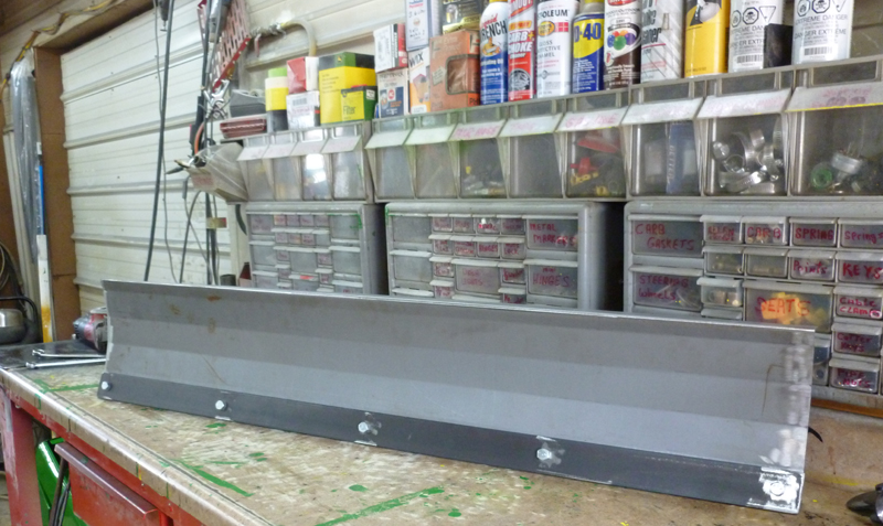

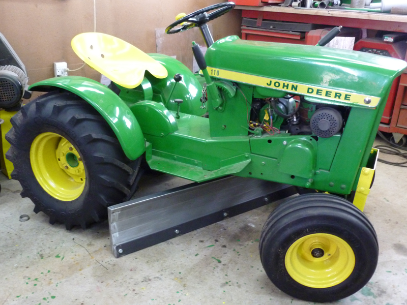

Tractor number three is now in the workshop and the center mounted grader blade is now under construction .
One pic shows the 48 inch wide blade on the workbench after bending the curve in it . It also shows the cutting edge drilled and bolted on . Also the end caps are welded on . The second pic shows the rough look of the blade sitting under the tractor . Next I will design and cut out the blade circle parts with the plasma cutter. This project will be done and painted by Friday morning and tractor number 4 will be pulled in for it's updates:laughing:aaabellyblade2.jpg

Another excellent example of craftmanship from you. May i ask how you curved the blade?
/ Mid mount Grader Blade Project
#9
Thanks ,
I have a small Tennsmith hand brake that bends light metal . I made a slight bend every two inches and then folded over the top and bottom 2 inches for extra strength .:eek:

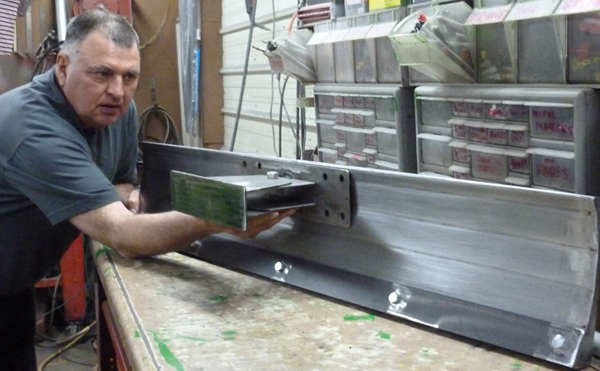

Todays progress pics show the blade circle parts and the mounting plate . 3/16" thick metal used. Tomorrow I will design the front hitch brackets and then join the front to the back with a light duty frame . :cool:aaacircle.jpg

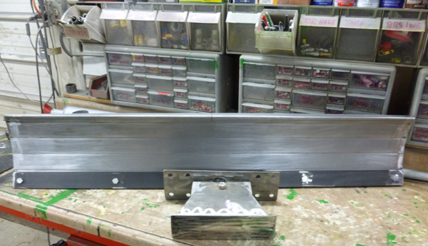

aaabellyblademounts.jpgToday I got the mounting brackets made and welded to the frame and welded to the rear angle assembly. Just one 1/2 in rod through the front mower plate hooks it on. Tomorrow I will work on the lift brackets and the drill the holes for the angling pin.

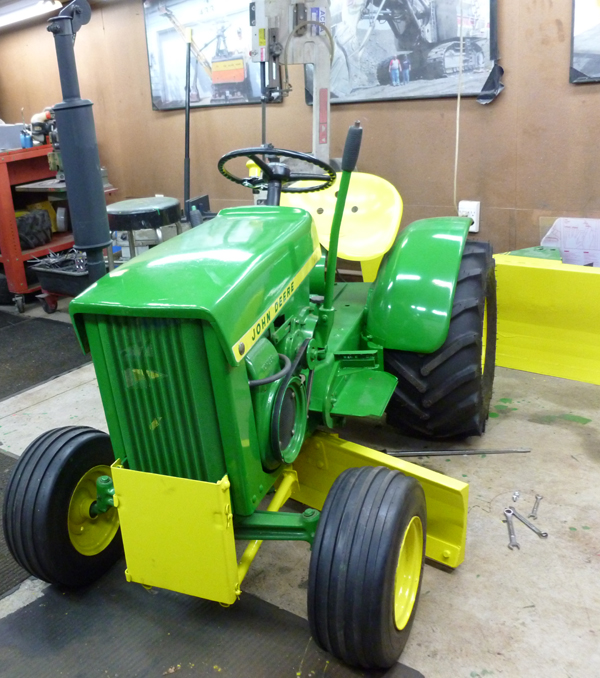

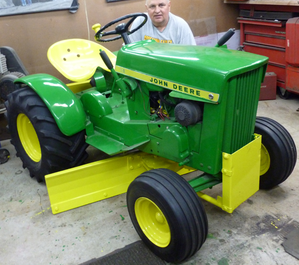

Todays picture shows the painted blade mounted on the 110 . I am very pleased how it turned out :dance1:
Next I will change the stock exhaust to a upright exhaust stack :thumbsup:aaabladepainted.jpg
