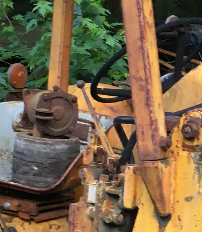

Thanks for all the replies. We could not get the tractor to start. It has not been started for 10 years. Because the starter engages but the engine does not turn over leads me to believe that the starter is not providing enough amps to turn the engine over or the engine is tight. Not running for such a long time might have caused some rust on the cylinder walls. I said in the beginning that I will take it if it runs. The owner is going to remove the starter and see if he can rotate the flywheel by hand with a screw driver. I don't think the swing motor can be fixed. It looks like the shaft that comes out on top is bent.
