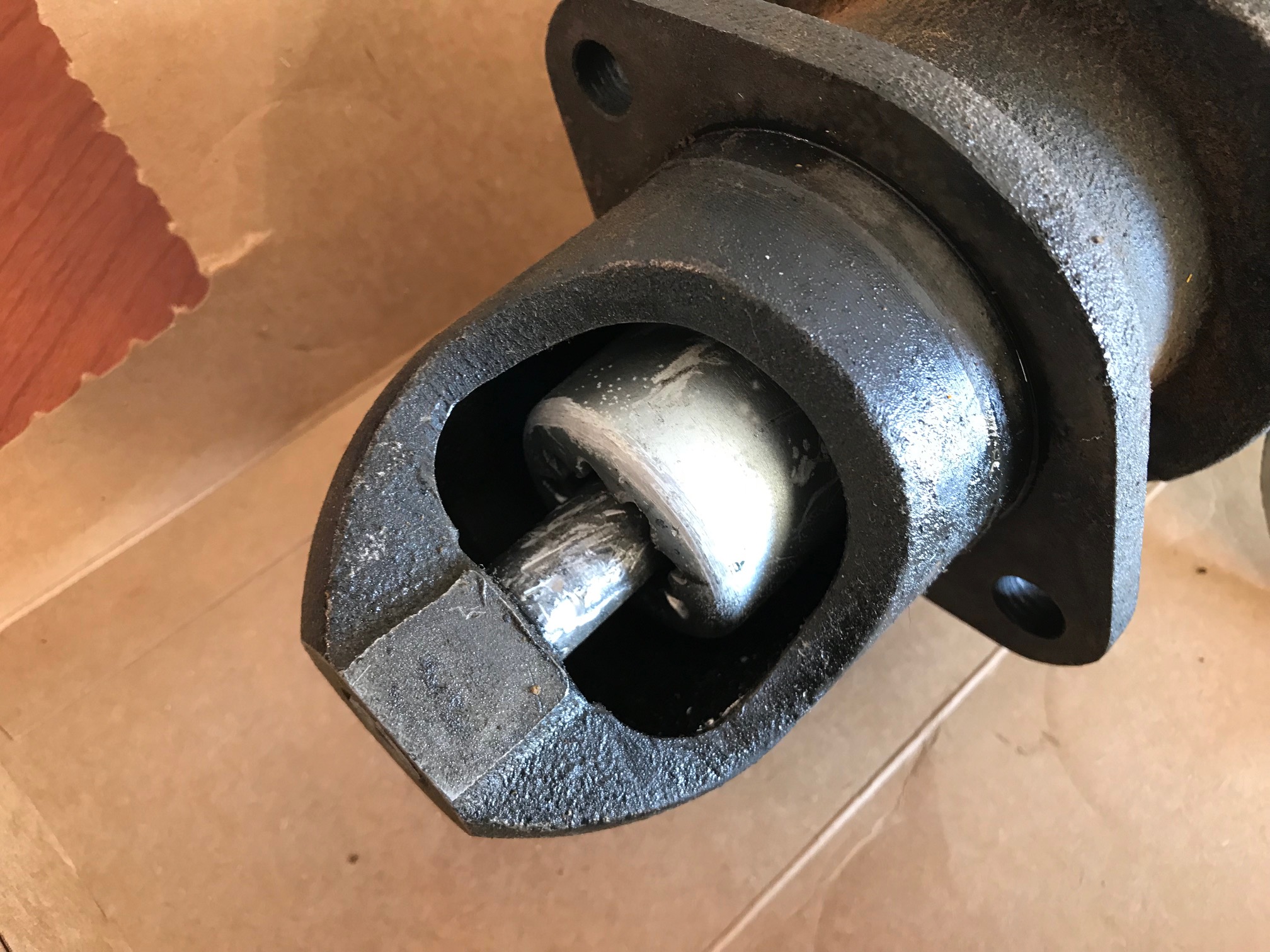

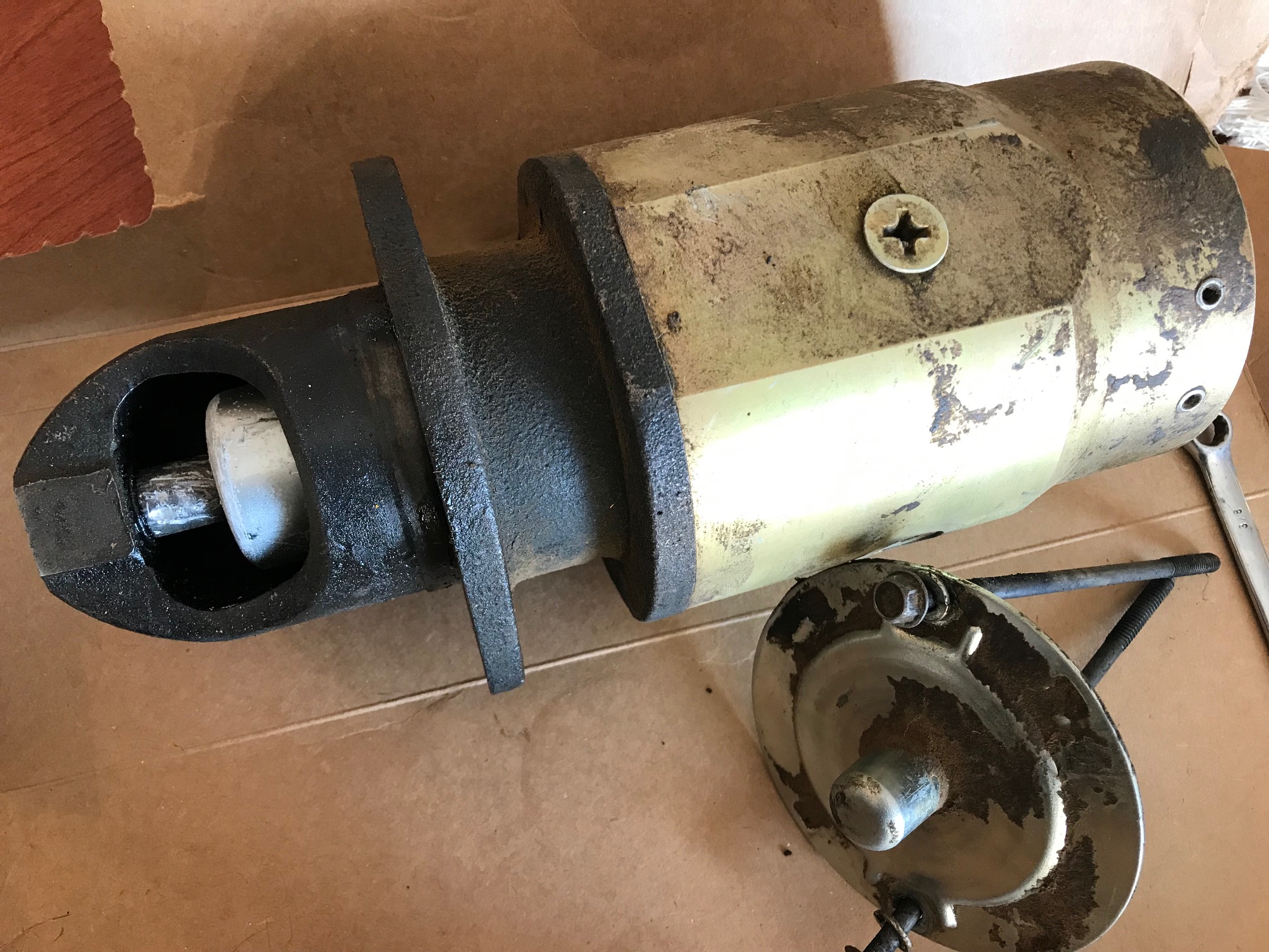

We got buried last night by snow and high winds. When I tried to start the MF35 utility (gas), I heard a clunk and then after that the starter just spins without engaging anything.
I pulled the starter and this is what I see. Am I missing the gear drive from the starter shaft or is something else going on here?
/ MF35 broken starter and snowed in! #2
Yes, the bendix teeth do appear to be missing.
I located a replacement starter drive at NAPA and someone is picking it up for me. I'll have to walk to his house in order to get it from him :)
Here's the question -- where did the broken gear go? Is it safely in the bottom of the oil pan or do I need to disassemble further in order to find it?
It must have broken into at least a couple of pieces and then fallen off the shaft, right?

It wouldn't be in the oil pan. The fly wheel is external to the engine oil pan.
/ MF35 broken starter and snowed in! #5
More than likely it just split in half. You may be able to fish it out of the clutch housing with a magnet.
/ MF35 broken starter and snowed in! #6
There’s a plate with four bolts on it on the underside of the clutch housing. Remove that and you can look right up inside. My bet is that the starter gear pieces are laying at the bottom of the bell housing and when you pull that four-bolt cover, they’ll drop out.

It's back together and running. I didn't even try to find the broken part, just put it together and cleared the snow. Once the weather is better I will drop the clutch cover plate and see what I find.

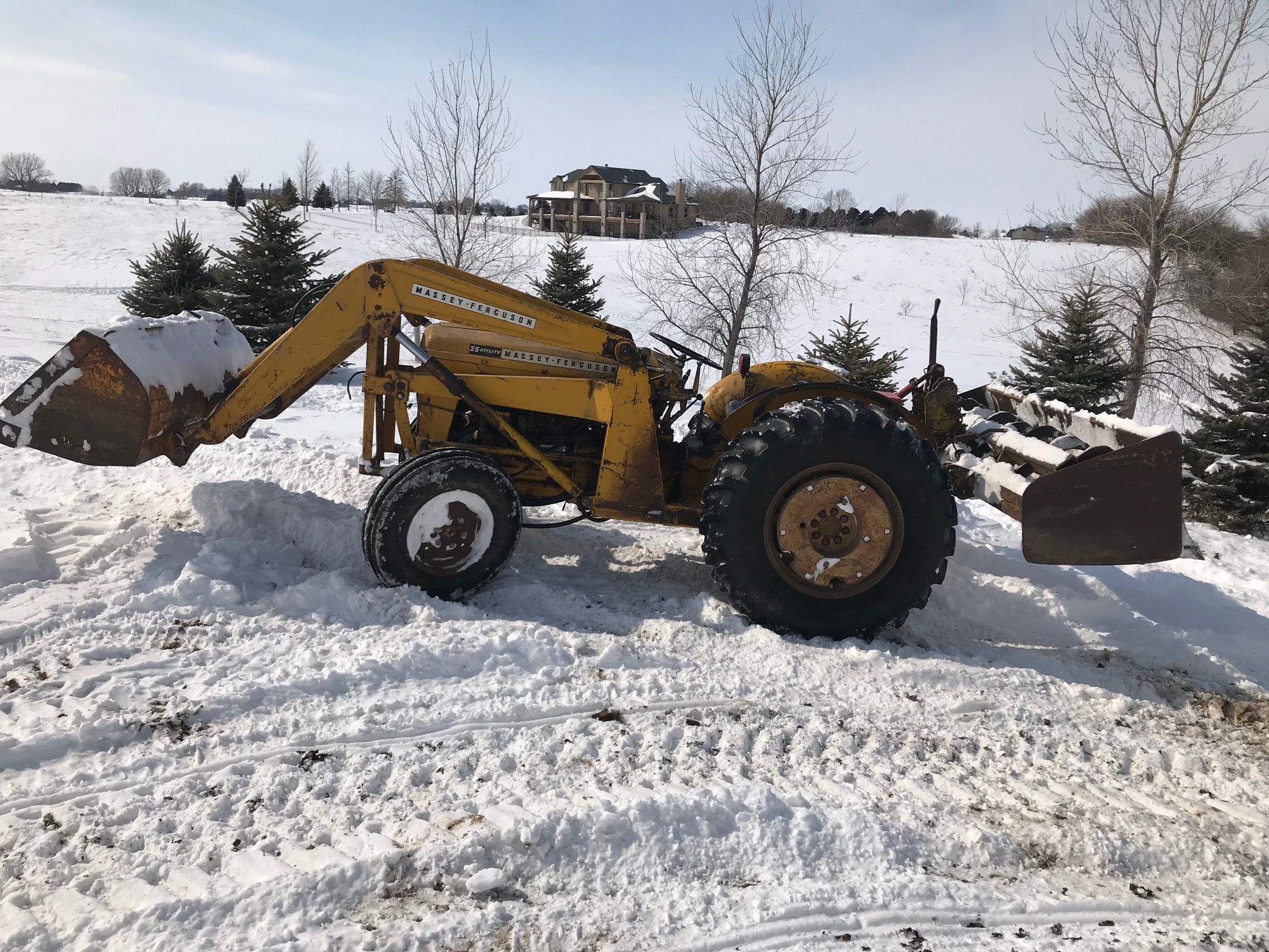

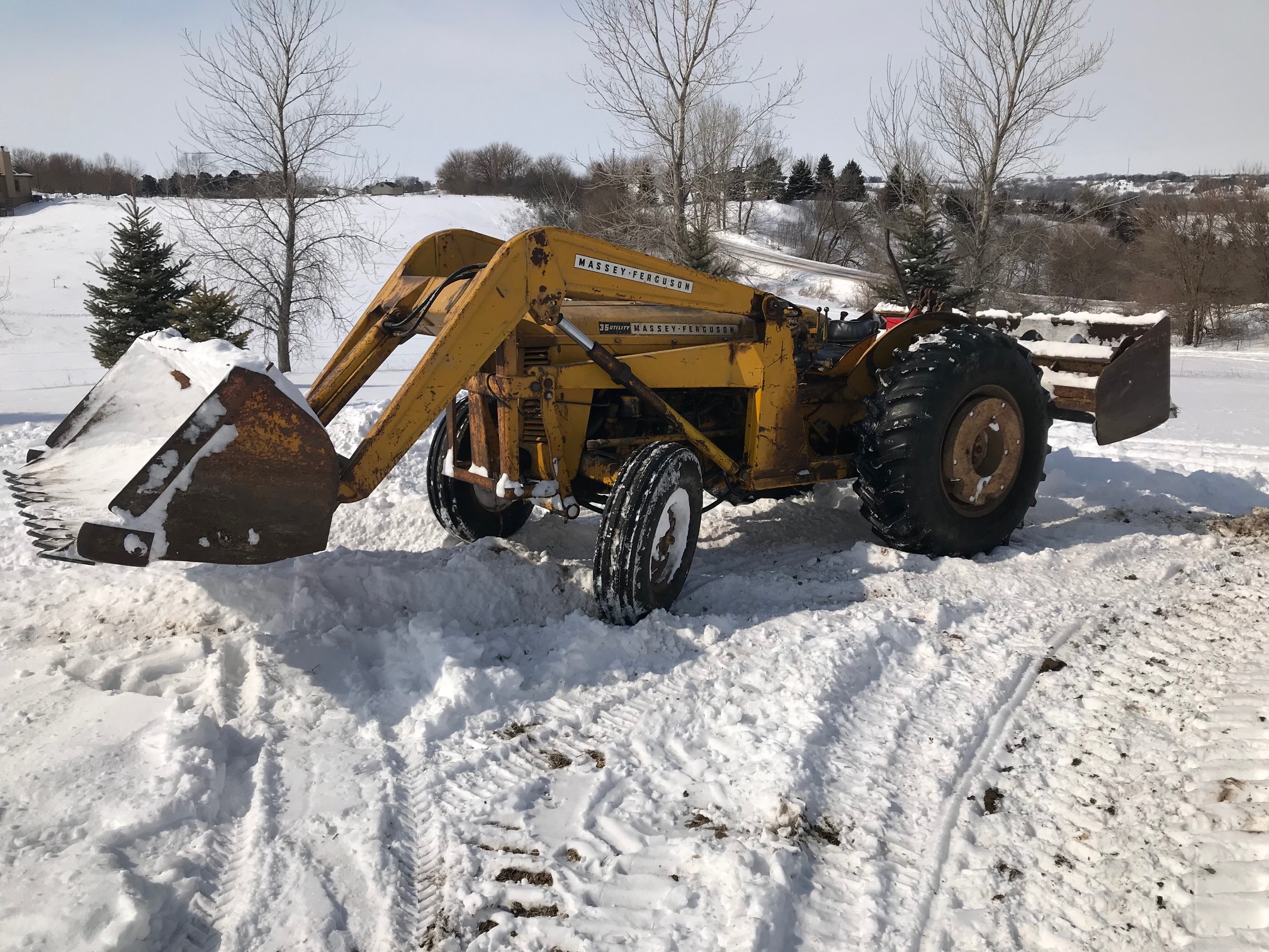

Back in business. Just finished cleaning up what the road grader put across our driveway again.
I gotta say, for being nearly 50 years old, this is still a very useful machine. A little rough around the edges and not very pretty, but she gets the job done.

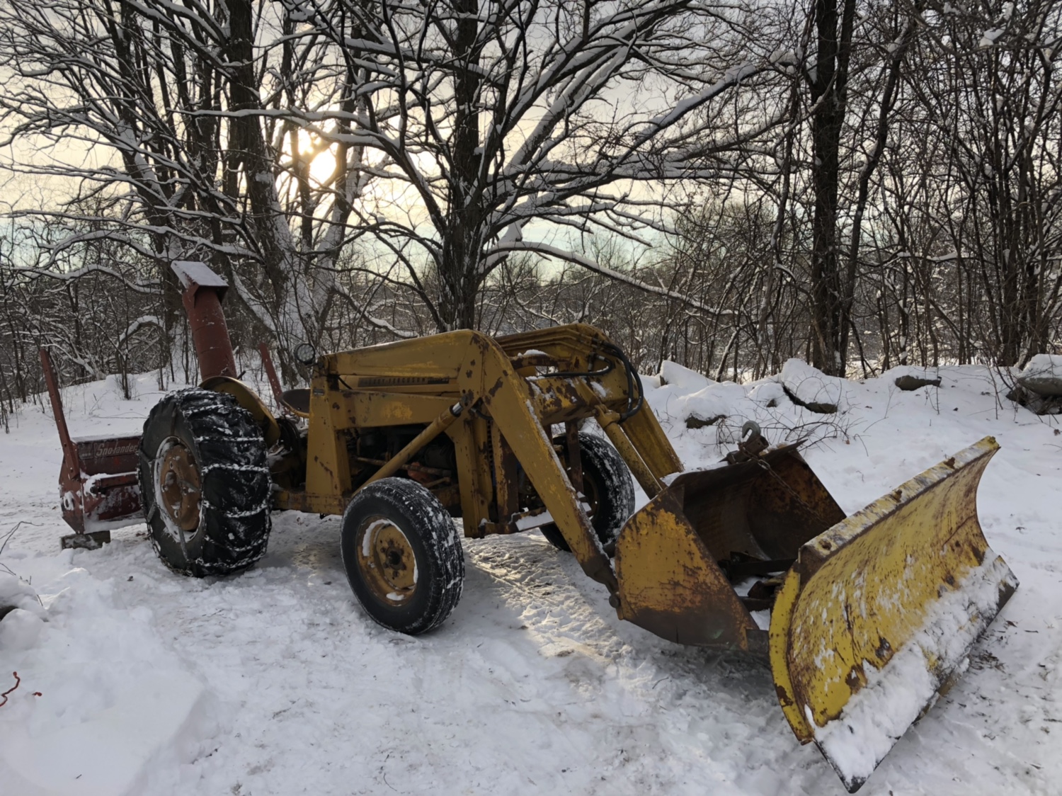

It was not bad. First, disconnect the ground from the battery then the hot wire from the starter. Next loosen the hose fitting where it connects to the PS but I did not have to disconnect it completely, just loosen it enough so it can move a bit. Pull the two starter bolts and wiggle the starter out of there. It's a minor pain but nothing serious.
Is the bendix the thing that pushes the starter drive gear out into the flywheel teeth? If so, that's the part I replaced on mine. It was not very difficult.

Nice, seems easy enough. Yep, the bendix is what kicks the starter gear out to engage the flywheel. I figured it wouldn’t be too bad. Just wasn’t sure if the distributor needed to be removed. I don’t feel like re-timing if I can help it, machine runs awesome right now.
My snowblower is a 6’ McKee Sno-lander 520. As long as your machine runs well and the governor is properly adjusted (very important), it’ll handle a 6’ blower no problem as far as power.
Does your machine have the shuttle shift? (Geared reverser). If so, that’ll help a lot because you can move pretty slowly in reverse. I have the shuttle, so I’m not sure how fast reverse is without it.
With the shuttle, you have reverse in first, second, and third for both hi and lo gears. That being said, for light fluffy snow I can hit up to 6” in 2nd low reverse and it’s not too fast. Real deep or wet heavy I use 1st reverse low.
