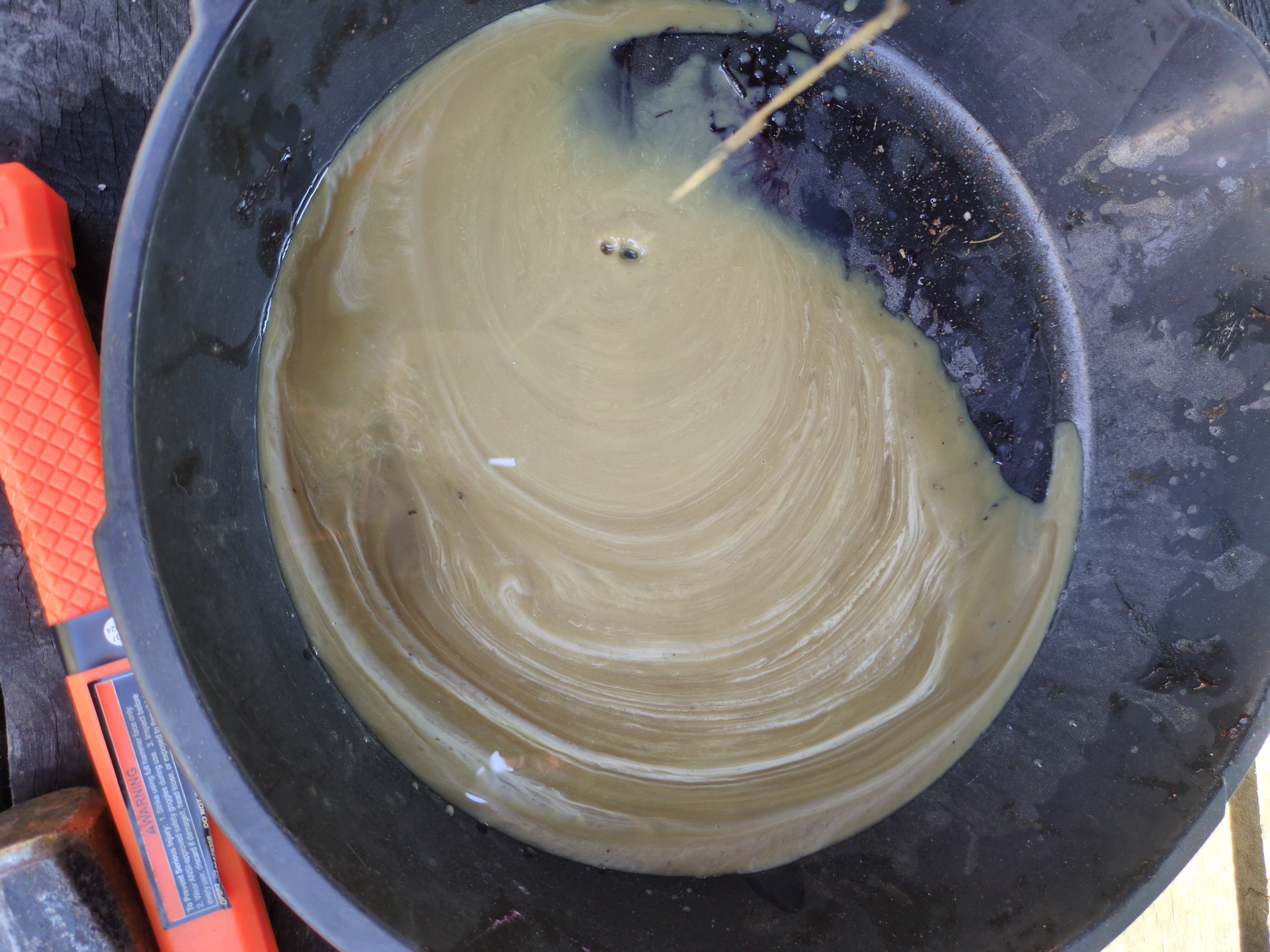

I have the same tractor... with no weight on the 3 point, the arms will remain up for a very long time. With the engine off and the lever in the full down position, put your foot on the arms and use your weight to move them down.
On that fluid, I would be flushing that several times. It should not look like what was in your photo.
You also have fluid in the front axle... I would open and drain that too.

I've gotten new oil (getting AGCO 821 XL from the local dealership was WAY cheaper than Amazon!) and filter (had to use ebay as dealer was out but ebay was nearly same price).
I disconnected the FEL cylinders and flushed them best I could (manually pulling them in/out with hoses in a small container of fresh oil). I also used air compressor to purge as many of the lines as I could.
I put in 8-9 gallons of oil and don't see anything on the sight glass. I saw someone post that it took them 10 gal to see it. Anyone else w/ a 1533 see different?
I'll have to bleed the air from the lines. Hoping I don't blow oil everywhere in the process (any more than I already have). After that, we'll see if that cures the original symptoms w/ PTO and 3PH. Followed closely by a rotating out this oil.

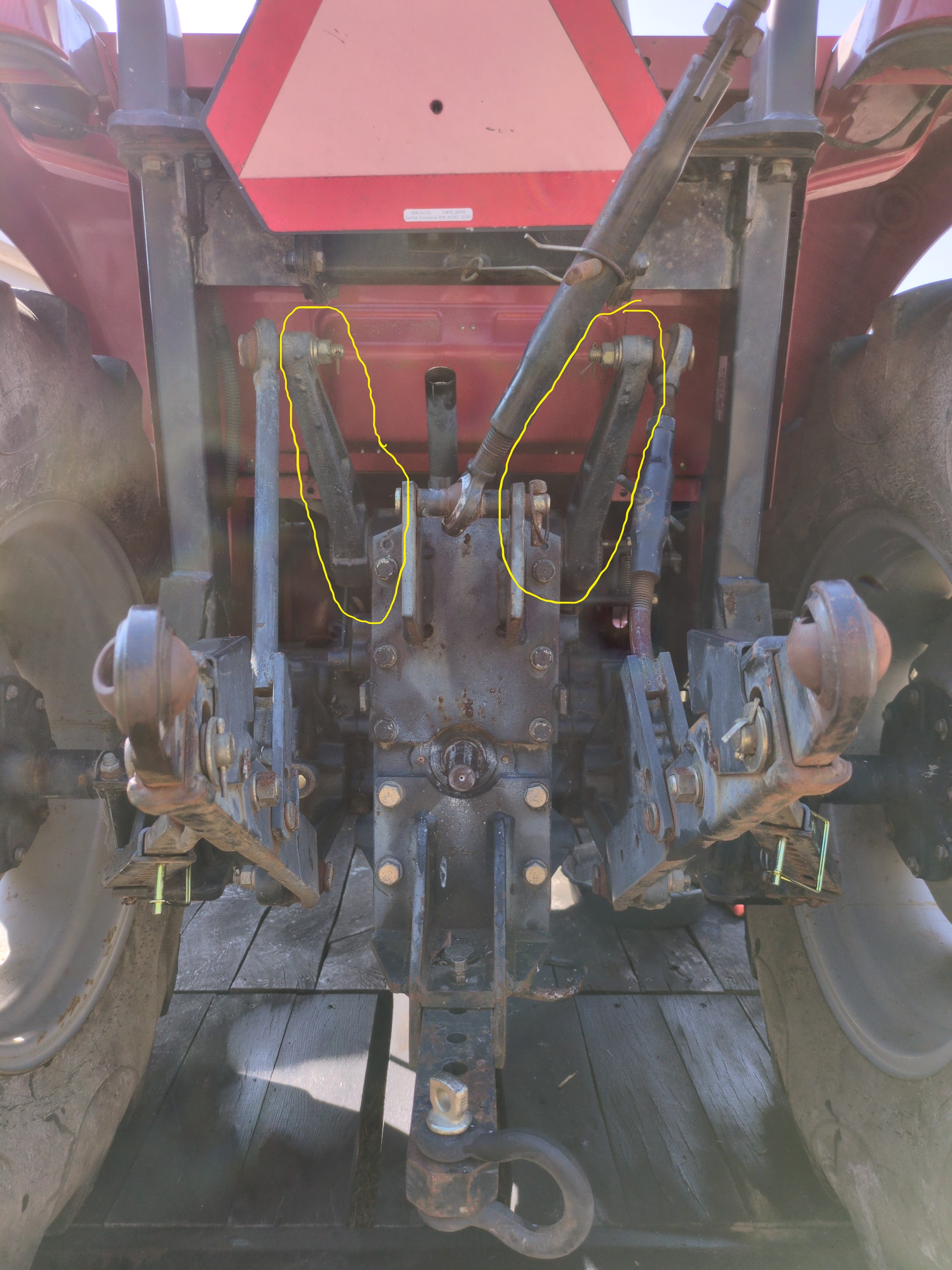

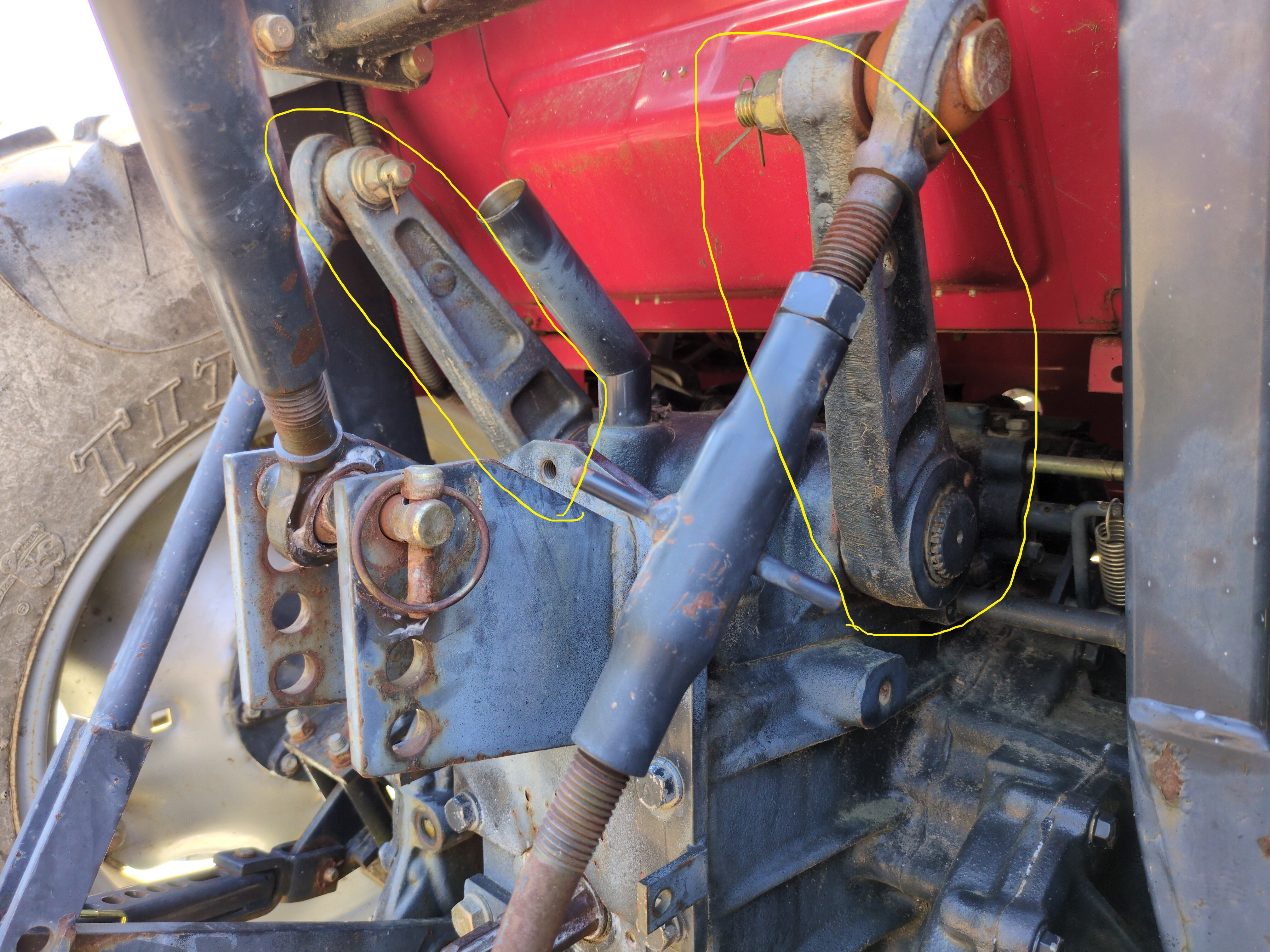

You’re missing your PTO shroud, and hydraulic fill plug, unless you just removed the plug temporarily, that could explain your milky oil.
From the photos and your issues, it looks like it’s had a pretty hard life for only 599 hours.
   / MF1533 SyncroShuttle has no PTO power
#36

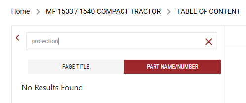

Yes, I have the plug; 'fluid change ops' were happening in that pic.
I do not have whatever would be in the lower circle. Searching AGCO online parts book, the only thing called 'shroud' is at the radiator. Any other information?
