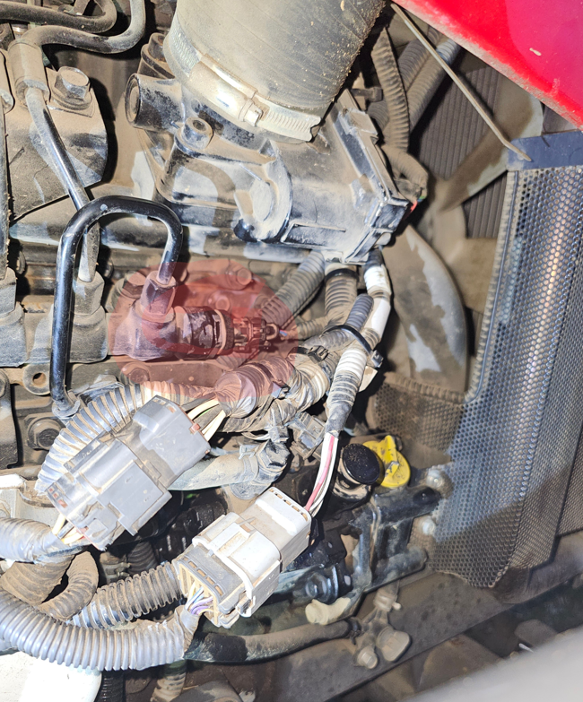

I intend to put maximum effort into this thing today. The weather is favorable, I have all day, and by the end of the day it will either be on a trailer or running. Maybe both. @thclimer, no worries, I have half-a** tried and today, not half-a** trying. It is my strategy to find that pump just for troubleshooting. I did take the flow/psi sensor off the fuel rail, turned the key on, no fuel. Also, used the priming pump there and no fuel.
I took the Bosch "measuring unit" off also, turned the key, no fuel but I was able to get the fuel when actuating the manual priming pump. SO, I believe at this point, a couple of things. I think that there is NO issue with the pick-up out of the tank. I inspected the filters and they are as clean as can be and no evidence of contamination so it rules out the fuel cell and filters. I also believe that because I can manually prime up to the "measuring unit" that there is no component preventing fuel to the main injector pump, like a cutoff valve. However, beyond that, I need to get to the priming pump and identify it that is a failed component OR it is being prevented from running because of the myriad of switches that Harry and I both know are present on these machines.
THe highlighted in the pic is the flow/PSU Sensor on the manifold. You can see the main injecotr pump in the lower right. Sits on a gearbox where you service the oil. The best part about this pic is how it demonstrates how engineers that designed this cearly have never worked on anything beyond a pencil sharpner!

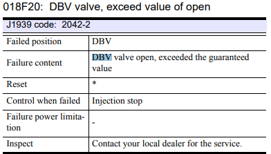

Update, I am writing this because this will help someone else. So, my little MF 1742 replicates the same codes that Mitsubishi builds in their ECU. Duh, right? Well, I am saying this because AGCO does not make it very clear and instead of banging your head against the wall trying to figure out the meaning of what is vaguely written in the AGCO manuals, here it is.

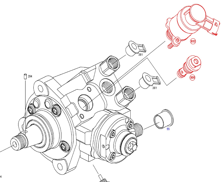

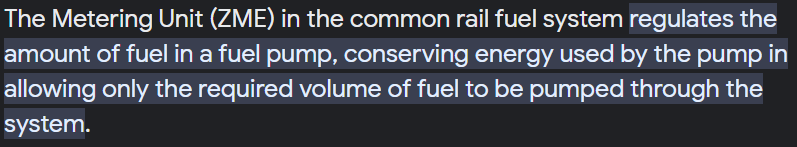

Here is the issue... AND if ANYONE knows, please chime in. It says DBV is the pressure limiting valve and I cannot find that term in any of the literature. I THINK that is the same as the "Measuring Unit" on the injector pump itself. Second and last for now, I truly think the ECU needs a computer to reset this thing BECAUSE of what is reflected above. Thoughts if you could please. This helps me THINK. I grew up as a Flight Engineer for 25 years but when we had engine issues we had literature that would tell us EVERYTHING we needed to use critical thinking to solve problems.
   / MF 1742 Cranks but wont start
#17
Thoughts on this fellas. Do you feel the pressure limiting valve is the same as the measuring unit called out below? I cannot find a pressure limiting valve anywhere in the literature.
