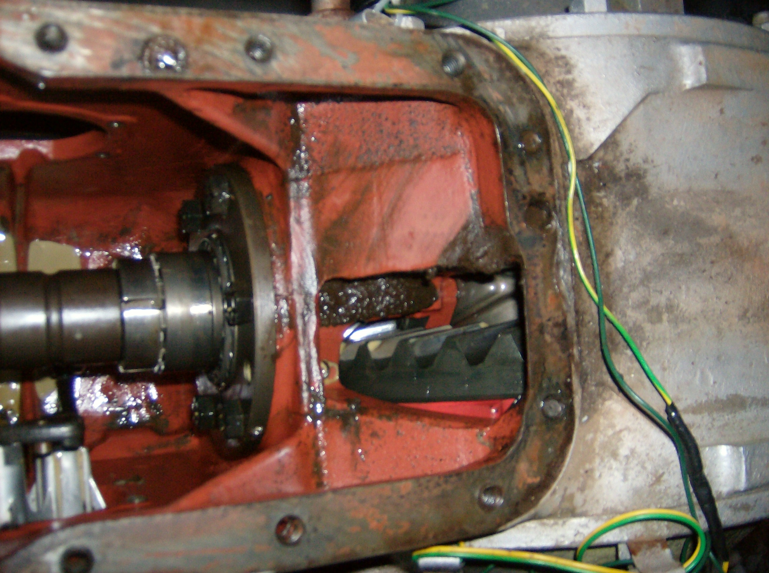

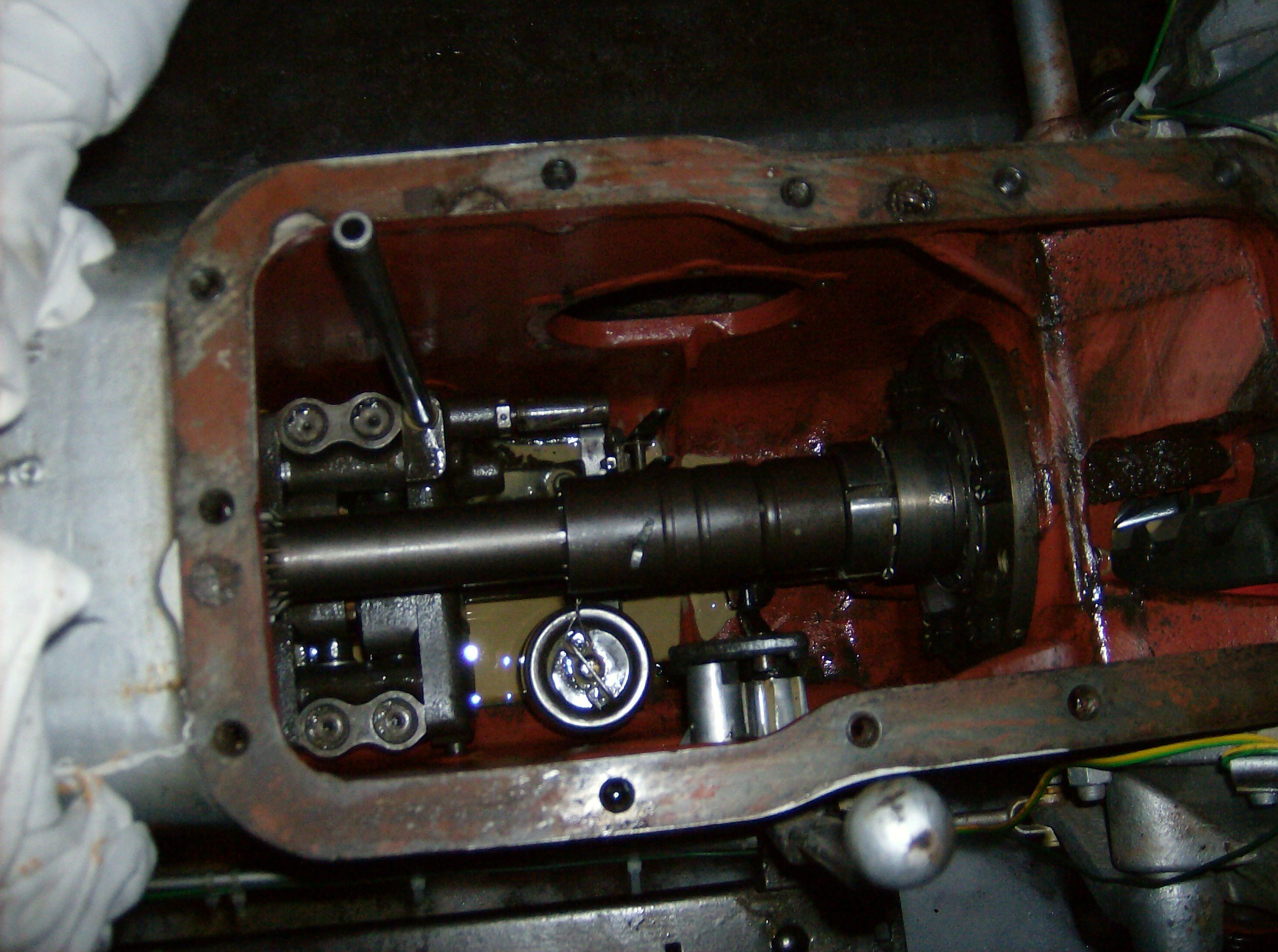

Photos are of my 135 when I had similar problems. O-rings on the lift rod from the pump / over-greasing lift arms that contaminated my hyd fluid and clogging the filter were what caused my problems. Lesson learned for me, one pump of the grease gun will do .... :thumbsup:

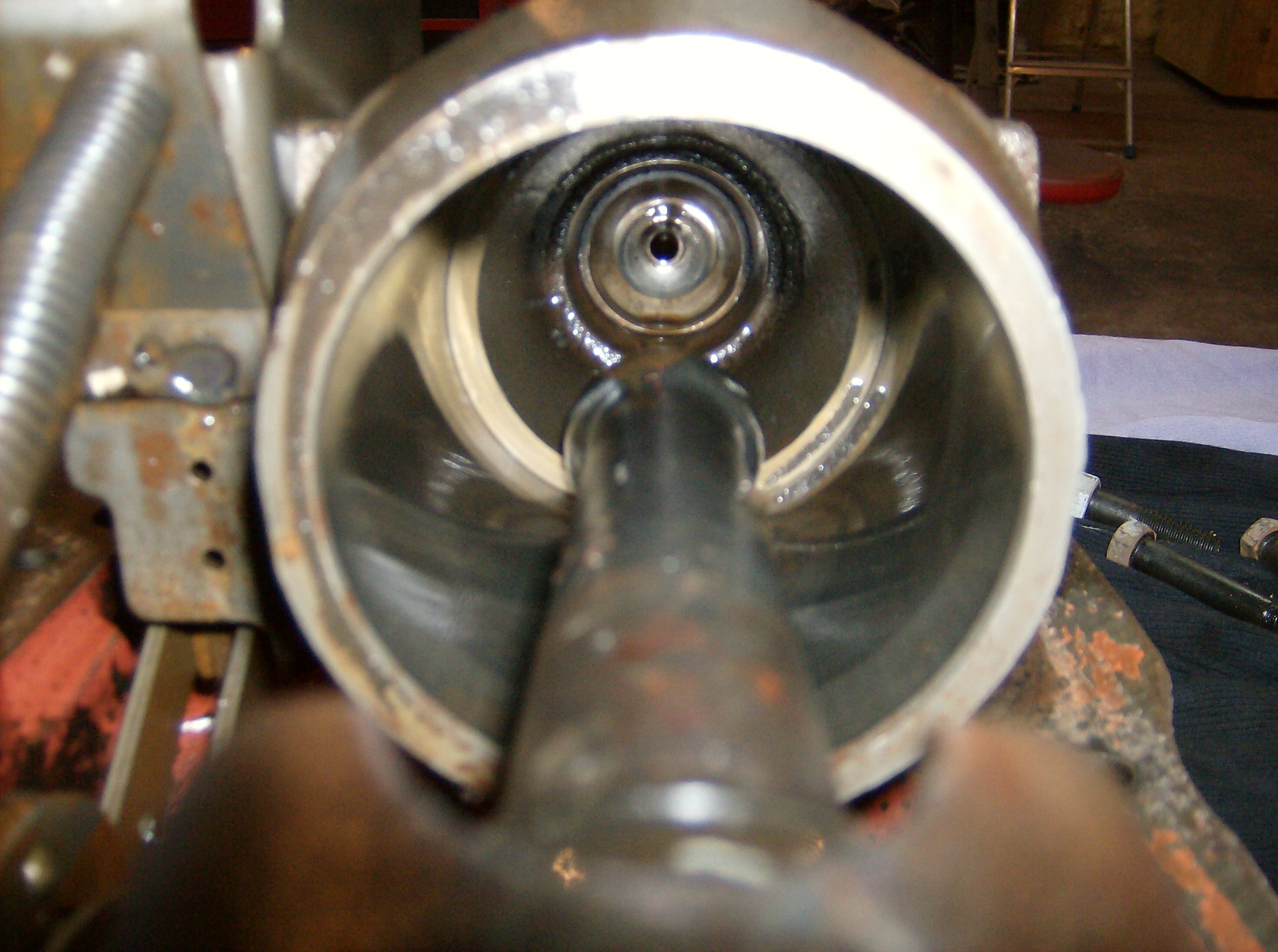

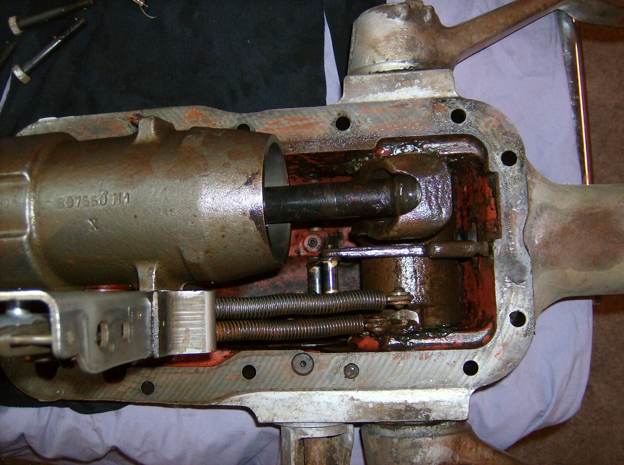

Even after replacing orings on the standpipe / flushing twice and installing new filter / checking lift piston and adjusting tolerances my MF will not hold the arms up after shutting her down. From what I've been told over the years that is a characteristic of the older masseys.
Lift piston and rod, along with linkages are attached to the cover, which is probably why it weighs 2 million pounds (definitely a two person job).

Pulling the lift cover is not a complicated task, there is a roller that when you take the side cover off you will see, you have to remove it to slide the linkages apart during removal.
Installation is where you have to be careful to get the linkages situated correctly. Even with the I&T manual I still took some photos, a picture is worth a thousand words.
As mentioned in previous post, if like me you don't have another tractor with a FEL or a come-a-long / lift of some sort, be careful because most of the weight is towards the aft end of the lift cover. I did drain the oil from mine because of contamination, to simply remove the side cover to access the linkages you would probably get away with approx 10-15 litres (2-3 gals).

First thing I would change is the filter, my first post with pictures, second and third images show the filter next to the PTO engagement lever cover, pop that off and it's right there. You can see that mine was lockwired, as it should be it was only hand tight, 30 minute job tops so worth doing for sure.
