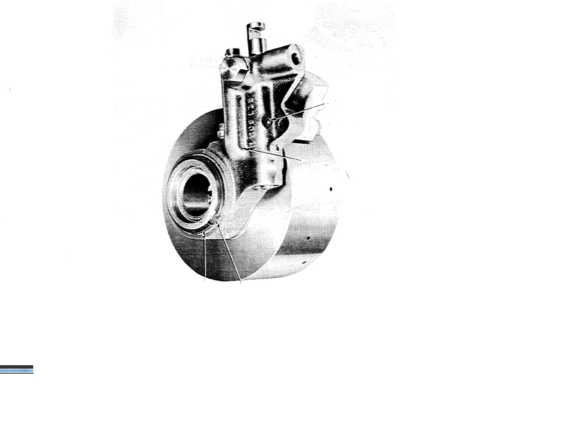

I have a MF 135 Deluxe with IPTO. I believe the 135 and 165 share some IPTO parts. The IPTO system consists of a hydraulically actuated clutch, the enagament of which is controlled by a 3-position spool valve. The clutch drum is splined on to the rear of the hydraulic pump camshaft and the friction plate hub is splined on to the front end of the PTO shaft. Hydraulic pressure is supplied by one of the low pressure outlet ports of the Multi-power or auxillary pump at 250 psi minimum (to maintain this minimum pressure, a special valve is built-in to the outlet flow pipe in the Multi-power circuit). The clutch valve is operated by the hand lever on the LHS of the center housing. The IPTO clutch pack contains: 7-Friction Discs, 7-Separator Plates, 11-Needle Rollers, 11-Return Springs, 2-Piston Rings, and 2-Sealing Rings.
The IPTO unit also incorporates a friction brake to stop the PTO shaft when the PTO is disenaged. I've attached picture of the IPTO unit. Hope this helps.

Have you had yours apart? If you have, am I correct in saying the repair will require removal of the lift cover and splitting the tractor. I believe I will need to repair or replace my auxiliary pump since my multi-power does not work properly and this will require the same procedure. I think the OP ultimately has low pressure from the pump and as a result damaged the clutch discs. He asked earlier in the thread if the damage could be repaired by a "jack of all trades" mechanic. What do you think?
