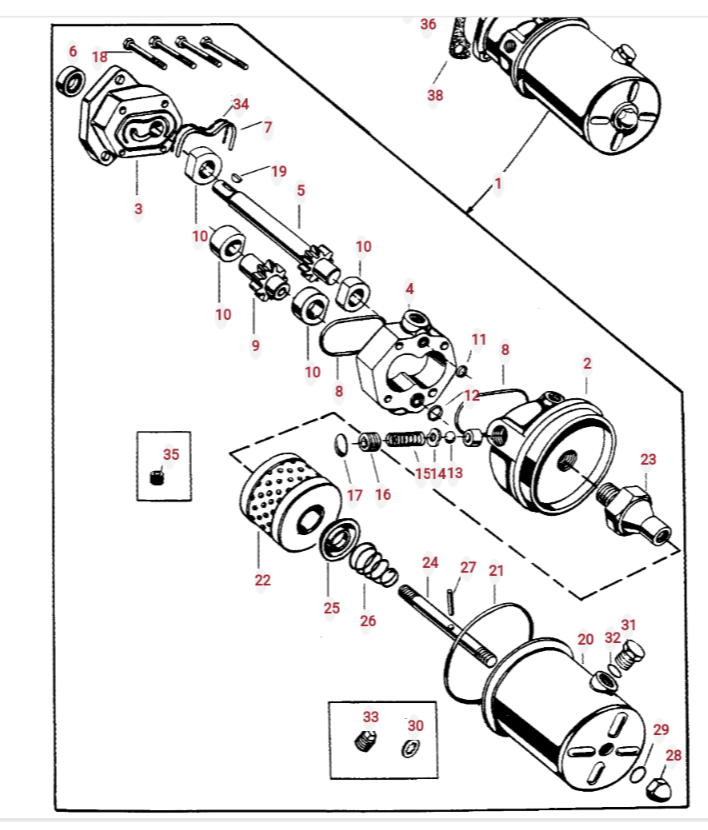

The power steering canister has no dipstick. Only a plug threaded into it. That port is the oil level. Fill til it runs out and screw the plug back in. The plg seals. There is no vent. You can try this. Fill it up to that point. Start the engine and let it run with plug out and watch what happens. You may need to top it off a bit at first. A certain amount of oil circulation is expected, but if the fluid starts to foam up and steadily bubble out on the ground, then yes, the pump probably has some problems.
On the other hand, even if the pump is working properly, hard and uneven steering could be linkage related, as the power steering on the 165 and 175 mostly takes place between the grill and the radiator. Lots of inter related moving parts up there that do tend to create problems as things wear over time.

There may also be a filter inside the pump housing. I would check out the parts diagram to see. If you are servicing the system might not be bad to make sure that's in decent shape.

Here is a diagram of what the pump has going on. So there is a filter in there that would be worth checking out. Might give you a clue as to the problem when you open it up.
   / MF165 hydraulic questions
#20
Thank you for the diagram! I need to get a service manual and just haven't gotten that done yet.
