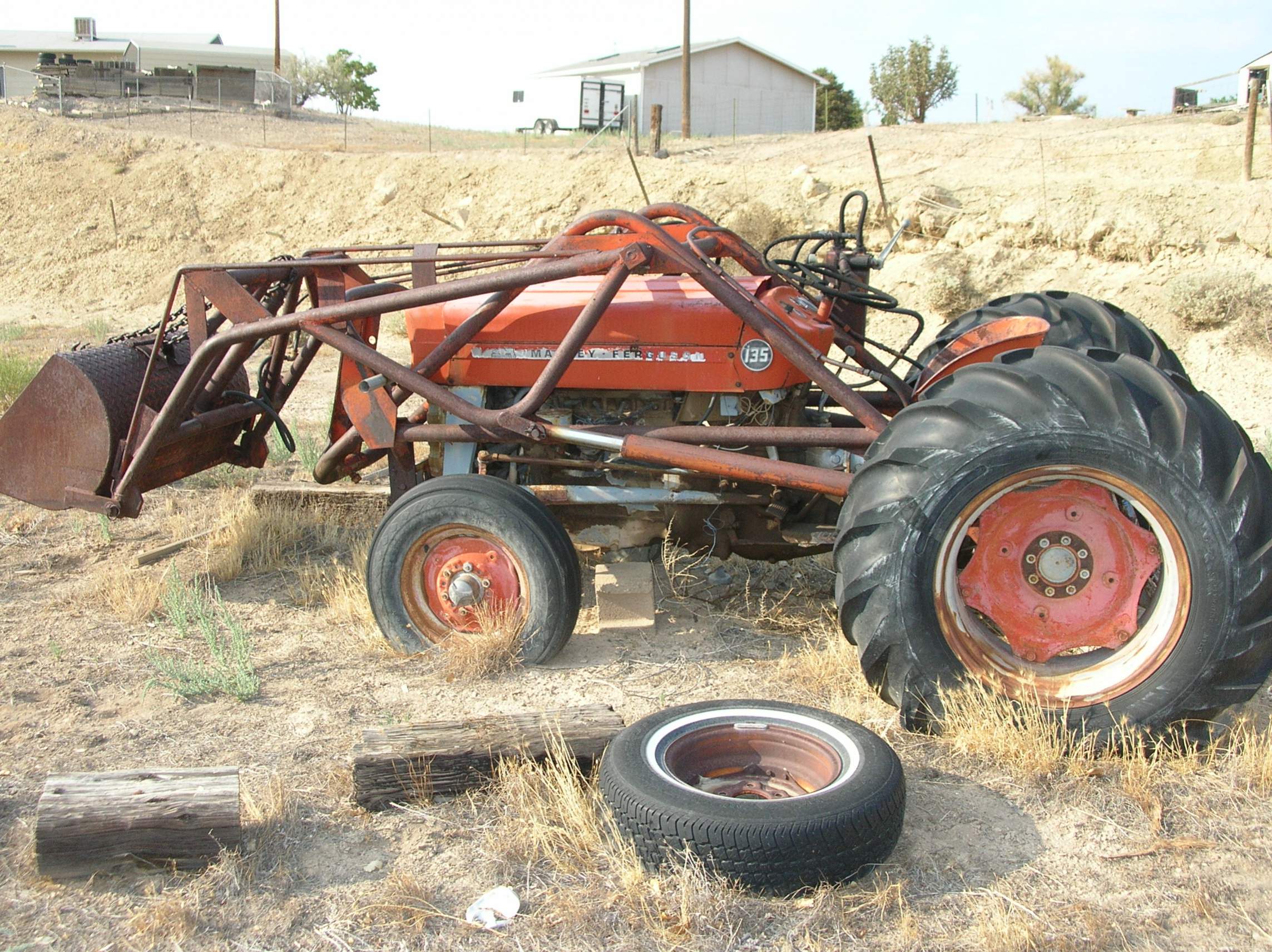

Thanks for the information, I have the system drained so I will check the relief valve tonight. Ive attached a pic of the beast the way I found her in the field.
