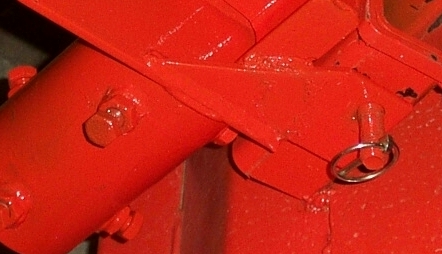

I'm getting ready to plant a bunch of metal fence posts and will be using my fel to push them in with. Do they make or has anyone ever seen a device to plumb them with besides a level? I need something I can see from my tractor without having to get off and look at the post several times. The back side of my bucket will be my focal point. I've attached a 3" piece of pipe to the back side of my bucket to push them in with.

It's originally off of an old 10' satelite dish, I had this thing laying around the shop for years and thought I should be able to use it for something...lol. I put it on the back of the bucket so I could see it from the tractor seat. I'm thinking if I get it started, then I can finish it from the tractor. Another fellow suggested a magnetic post level. I may see if I can find one and give it a try. As for safety I would never get under a fel or ask anyone else to do so either.
