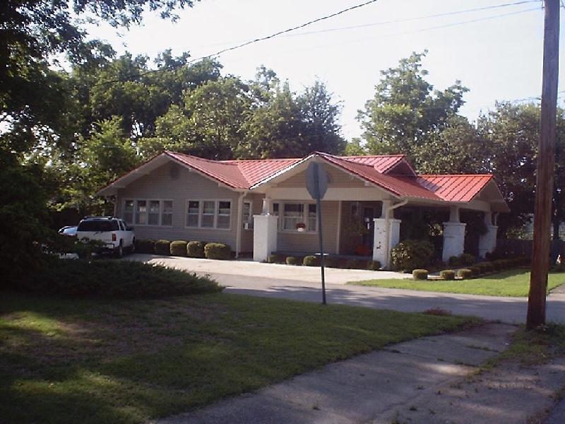

Here is a picture of a small house just up the street with a brown metal roof.
