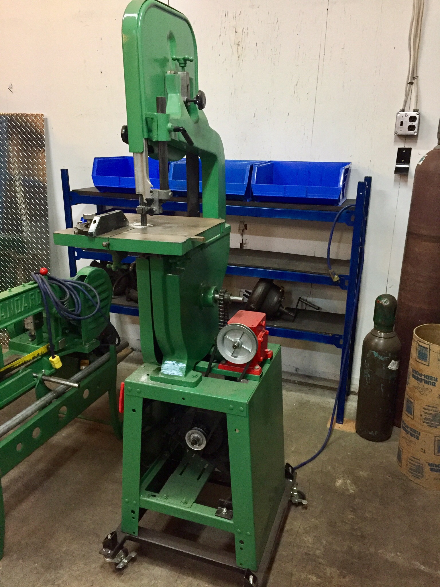

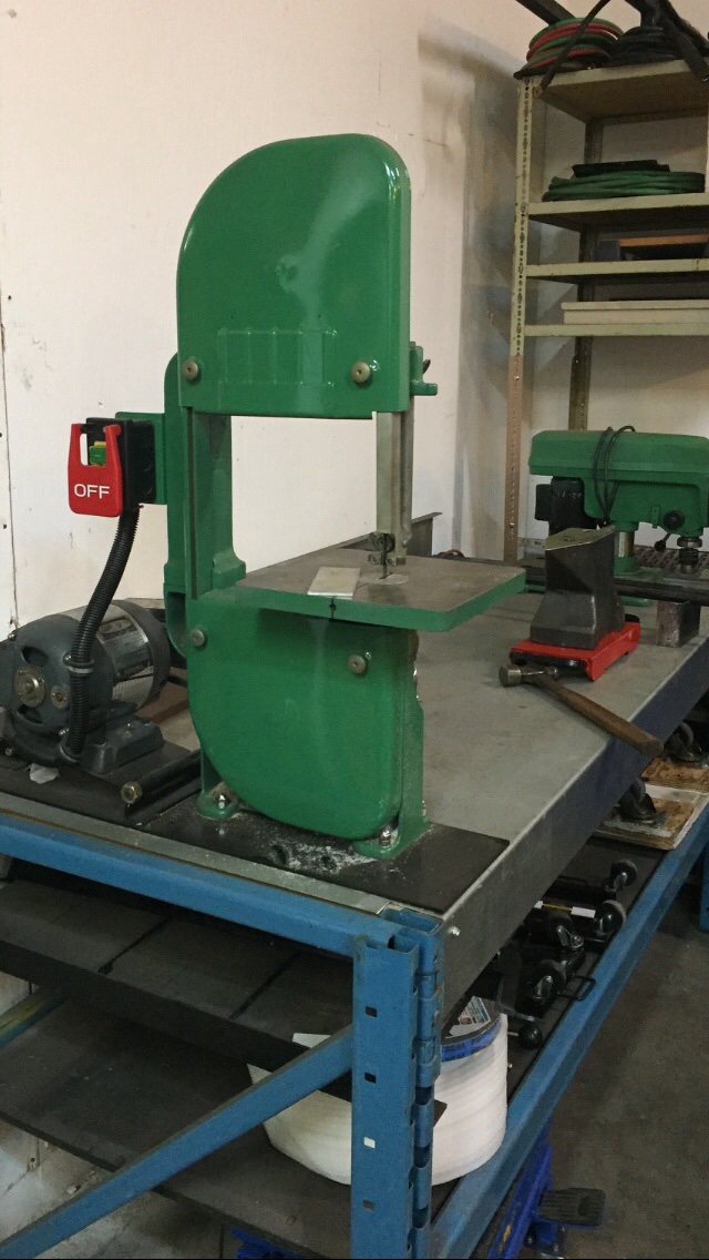

I've had my 7x12 import saw for 18 years now. I ditched the coolant system and get excellent results using a lube stick. Quality blades are important. I like Starrett.
I also added a reduction gearbox and bi-metal blade to a 14" vertical bandsaw for cutting steel.
And this little guy I keep at wood cutting speed for aluminum.

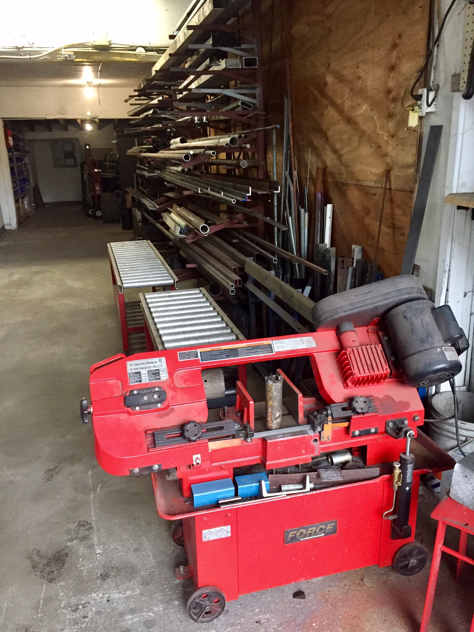

I bought a 7 X 12 from ENCO about 15 years ago and I love it.
I have never used the coolant system and don't figure I have ever needed it.
I have used saws with it and feel the mess isn't worth the difference.
I have rigged the horizontal table so I can insert or remove easily (no bolts or screws) and being easy to put on I use it about 50% of the time!
I will cut PVC or rubber or small wood with it too.
