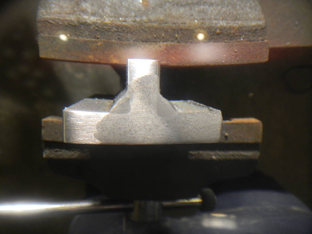

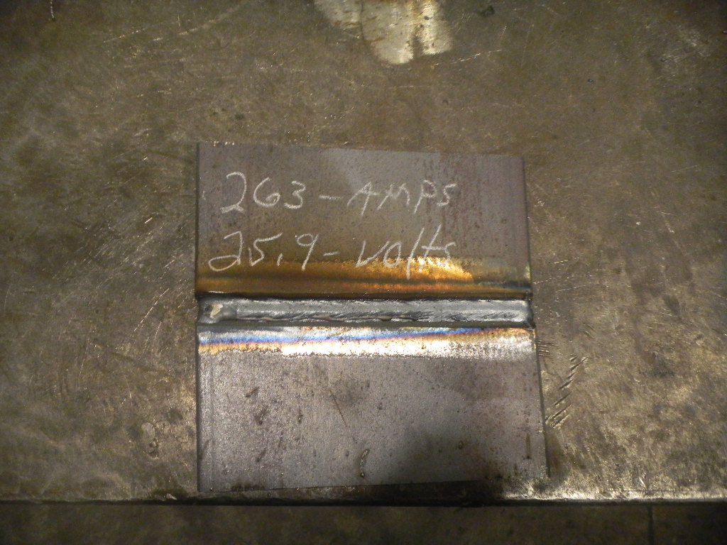

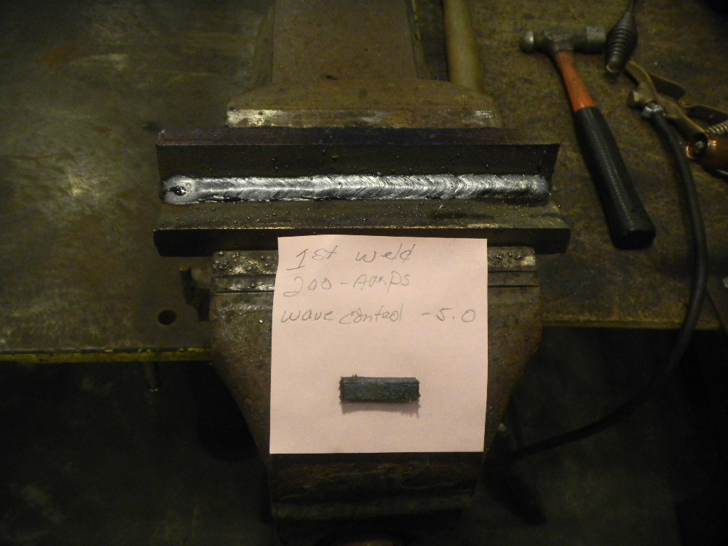

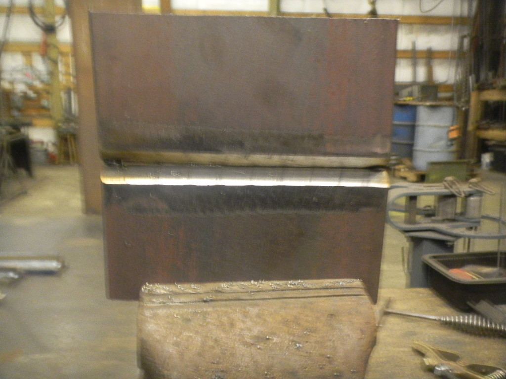

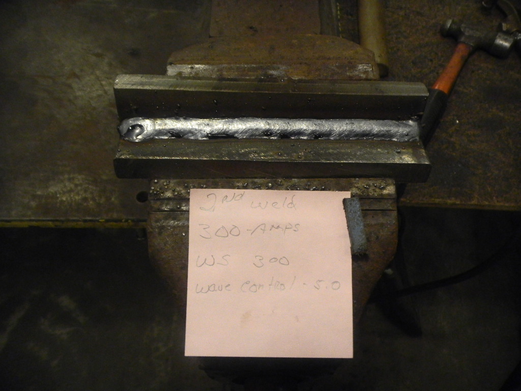

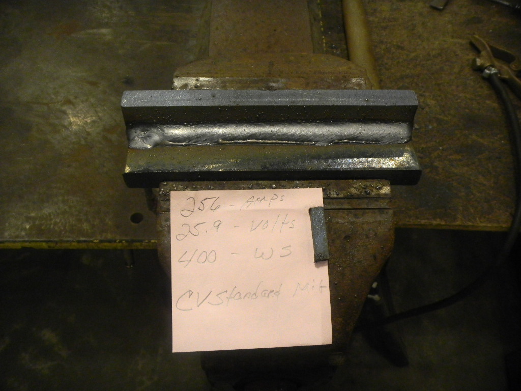

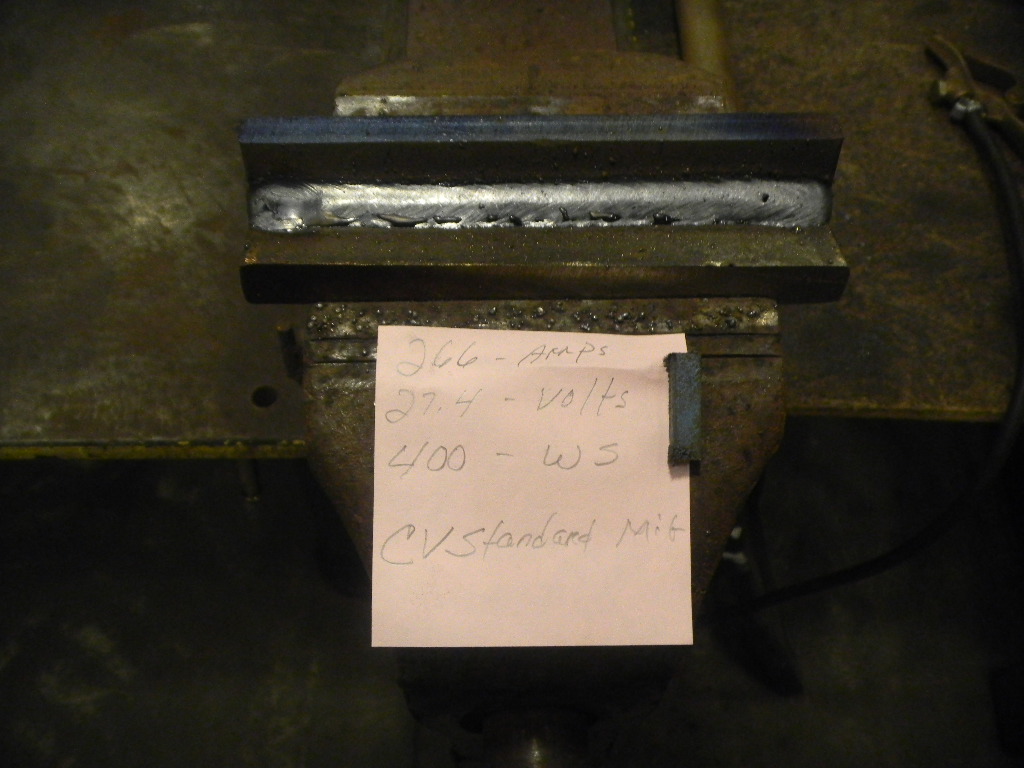

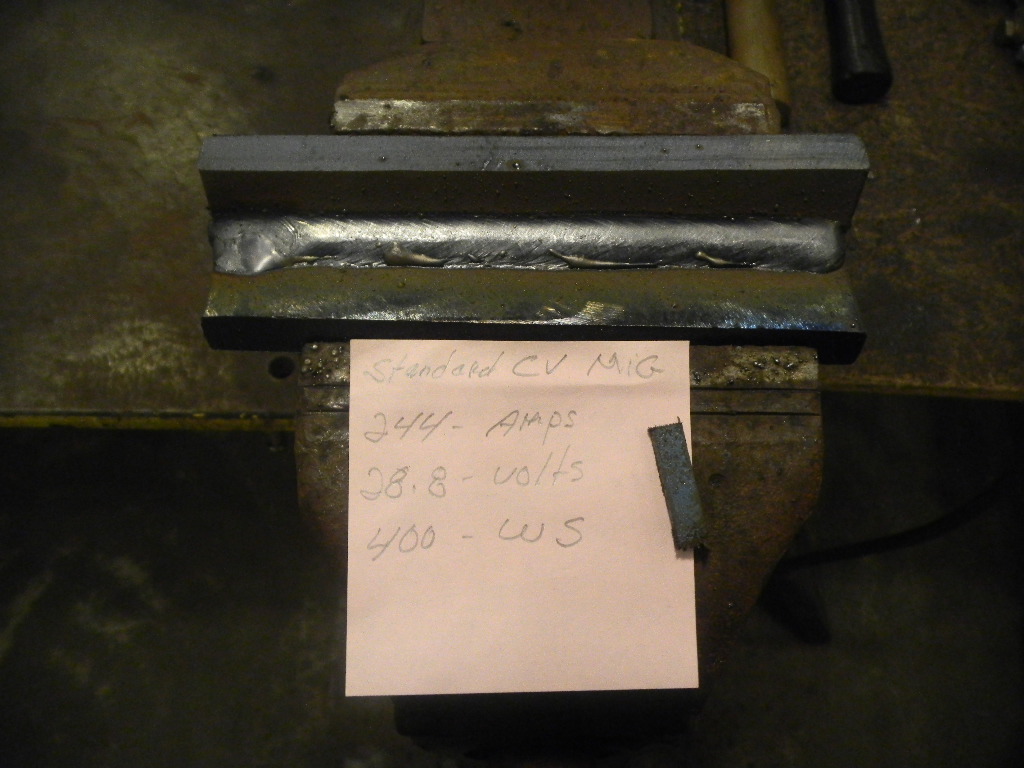

A member over on WeldingWeb sent me a roll of Hobart FabCOR CVN .045" Metal Core wire to play with:cool2:. I've never been around Metal Core before. Very fast wire. All I have for gas is 75% argon & 25% CO2. I under stand if you use 90% argon & 10% CO2 it's even faster. I started out with the V350-Pro set on Metal Core .045", but later switched to Standard CV Mig. I like that better. Does make a nice looking weld!:cool:

/ Metal Core. #2
Quick question are you pushing or dragging those welds
/ Metal Core.

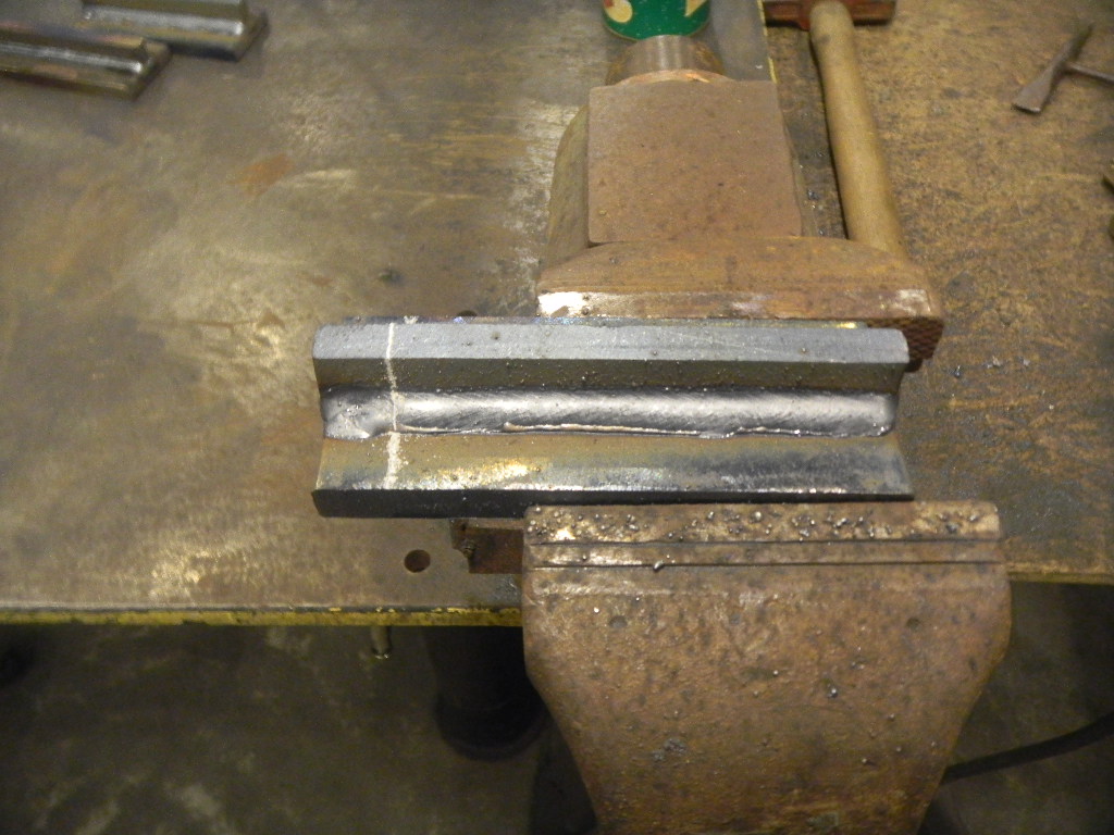

I pushed these welds. For some reason I was thinking there would be a thick slag over the weld like flux core. But the welds in the pictures I posted, weren't even wire brushed.
Generally I push with Mig, but some times you have to pull when building things.
Anything that produces slag, I drag.

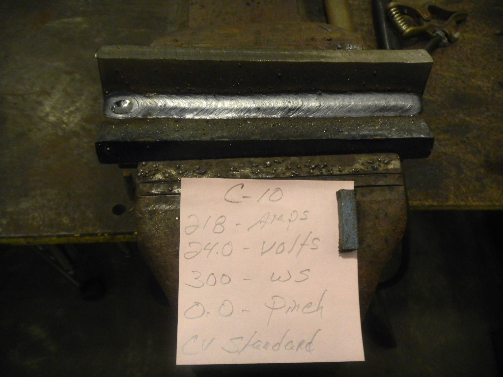

/ Metal Core.
Picked up a rental bottle of C-10 / 90% argon 10% CO2 gas the other day. This metal core sure makes some pretty welds. And very fast! This is how the weld looks, no wire brushing at all.
/ Metal Core. #5
Gorgeous! I hope my wife didn't hear that! :D

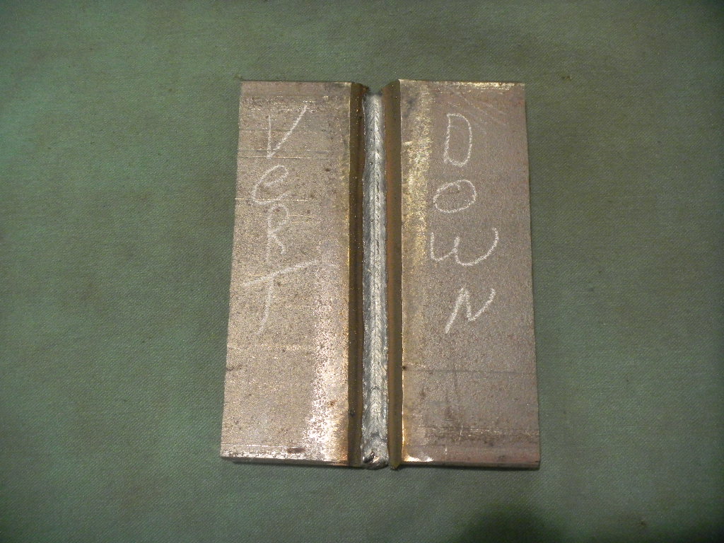

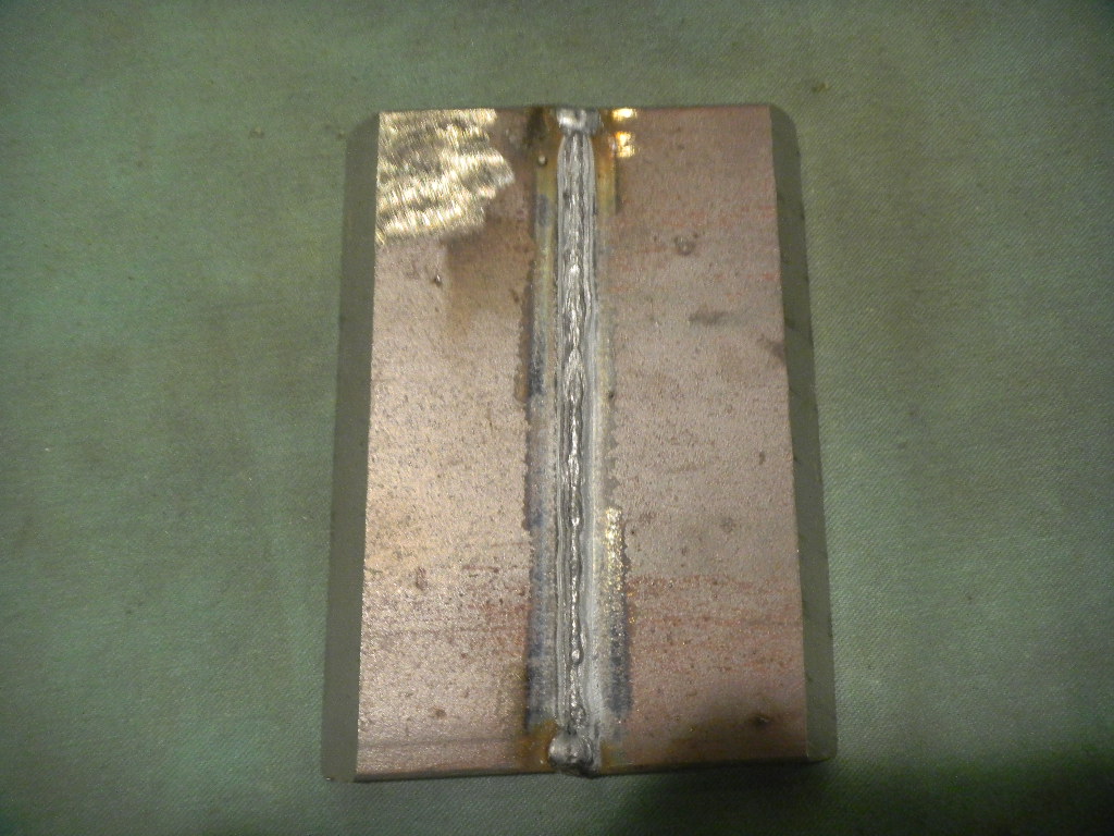

This wire does make some nice looking welds:cool:. Here is a vertical down hill open root weld I made with it. Still haven't figured out the proper joint prep.:D
None of these welds were wire brushed!

/ Metal Core. #7
Keep at it .. You'll get it!! As usual great job! I like how you always show good pictures with good descriptions.

/ Metal Core. #10
This wire does make some nice looking welds:cool:. Here is a vertical down hill open root weld I made with it. Still haven't figured out the proper joint prep.:D None of these welds were wire brushed!
If I didn't know you as well, I would call BS. The first pic looks unreal. U da machine... I mean, da man!
