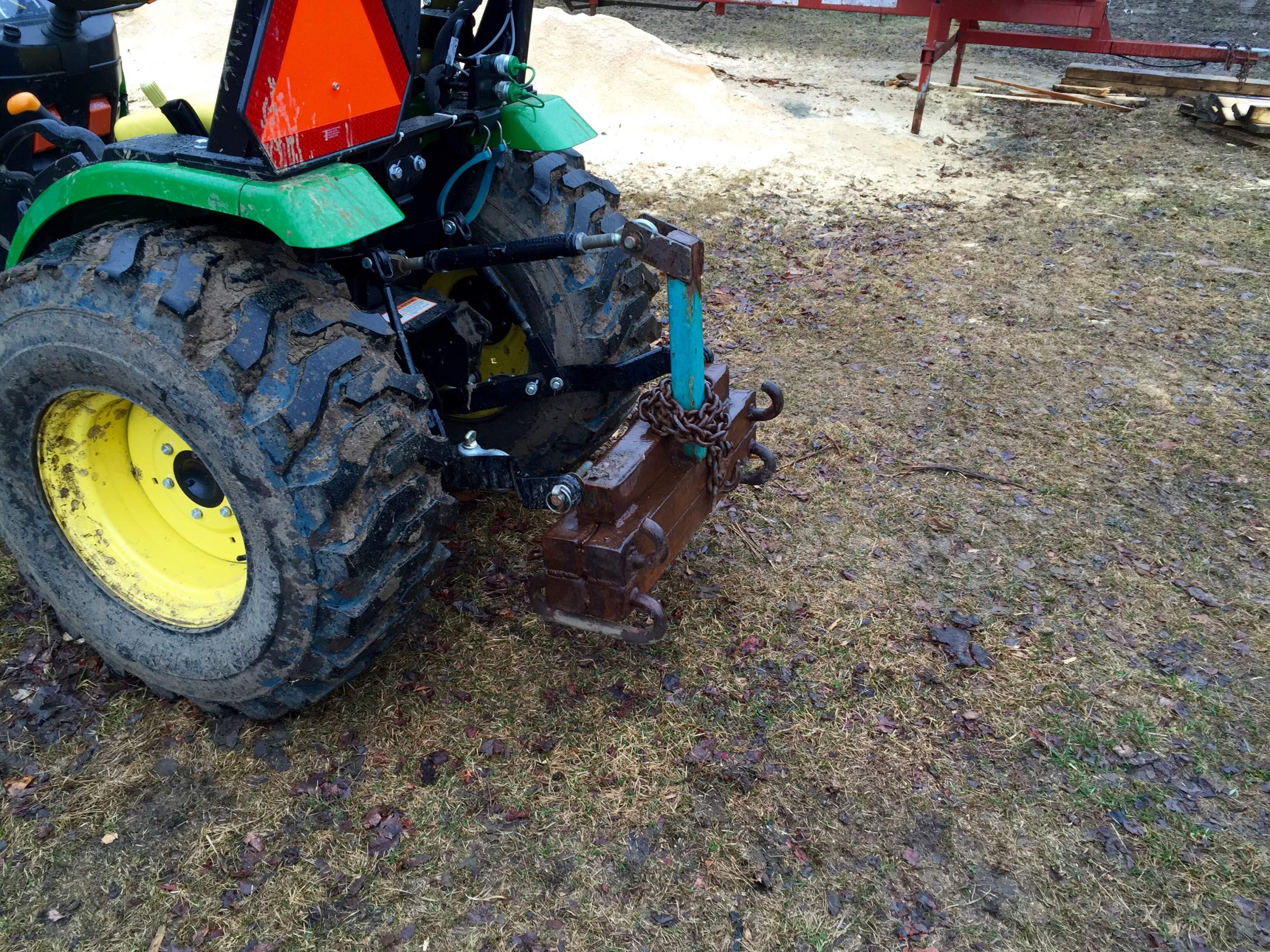

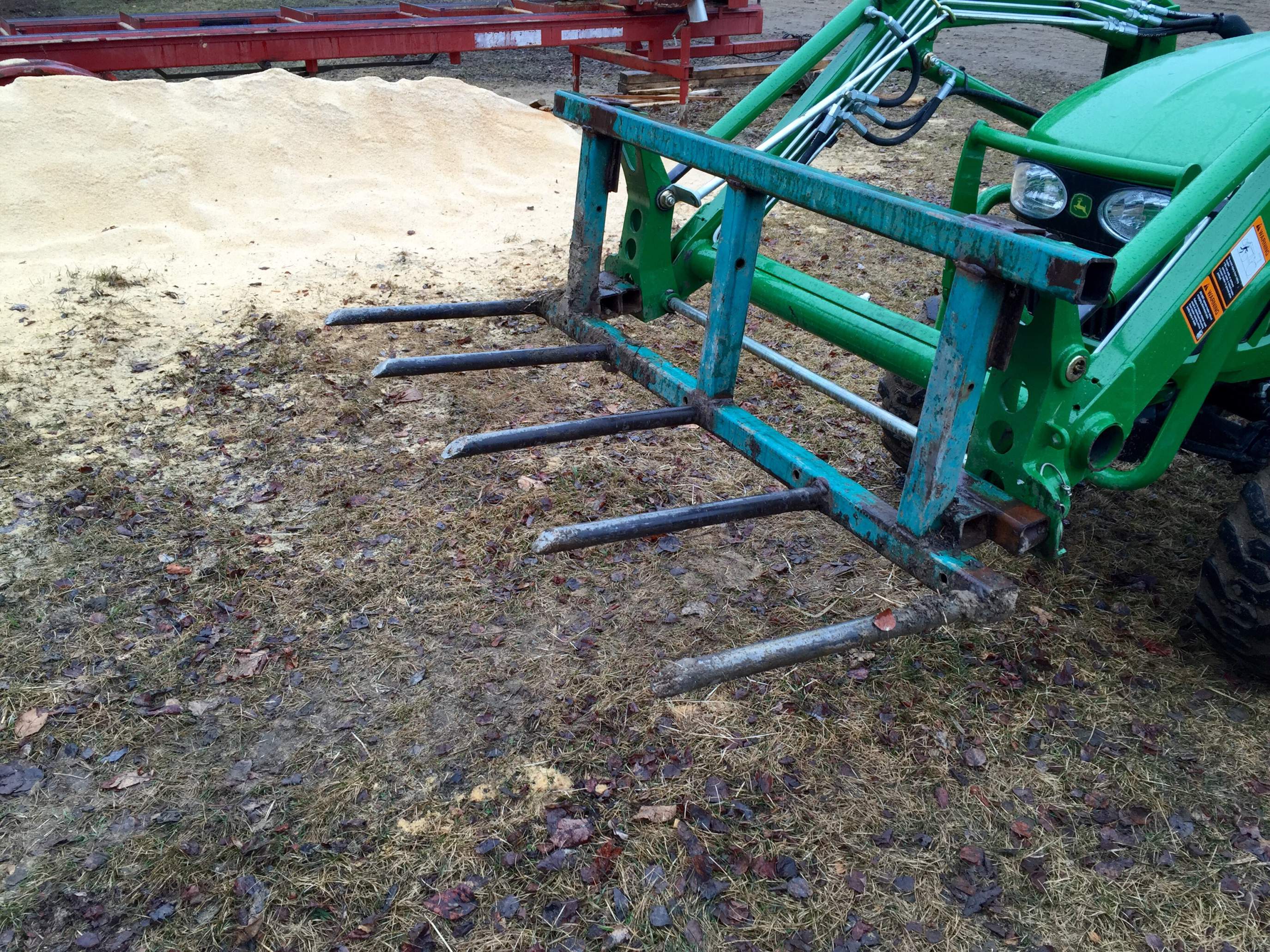

image.jpgimage.jpg My counterweight and brush forks. I use the forks probably 90% of the time, they are light enough I can pick them up with one hand and the abuse they take really surprised me. So far I've only bent the tines a little but that was using them as a pry bar with the loader to free up some frozen logs.

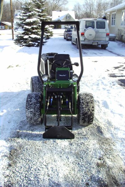

Power Trac wants close to $700.00 delivered for a new Rop's.
I figure since I have an old tractor anyway I will make my own and cut that price in half.. Figured I may as well put it under this old thread I started years ago. My question to any of you has anyone already done this ? And would one of you be nice enough to measure out from the side mount of your Rop's to the edge of the outer bar. I would appreciate it.. I was thinking around 6 inches extended out on each side. Thanks in advance ..
   / Members home made attachments / improvements #267
mine is welded right to the frame.....so it only extends the width of the 2" pipe on each side........Jack

Thanks Jack !
   / Members home made attachments / improvements #269
Not at home right now... don't know if this picture from the front will help you or not, but it can't hurt! :D
#270
Yes it does on the angle thanks ..
