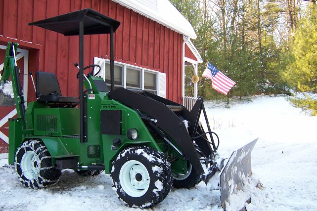

thats interesting.......mines straight up and down with no angle.........Jack
   / Members home made attachments / improvements
#272
Jack,
I'm guessing yours is straight up and down because it is mid way between the front and back wheels on the tractor. Little chance of anything getting caught between the tires and the support.
The 422 / 425 Rop's is curved upward by the front tire so nothing can get caught between the tire and the bottom of the support then flairs outward to give you more roll over protection.;)
Unfortunately the one I am now building will not have the flair just a straight 5 inch elbow.. So I'll have to be extra careful .. I may decide to change the design and bring it in closer to the machine after I test it and see how well it does.
   / Members home made attachments / improvements #273

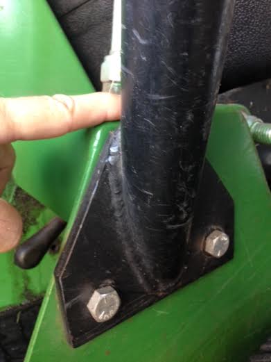

BarryH, here's the picture of the angle of the ROPS attached on my 2001 425.
As mentioned, my front canopy height is about 68" and the rear is about 66.25" for a slop towards the rear of about 1.75".

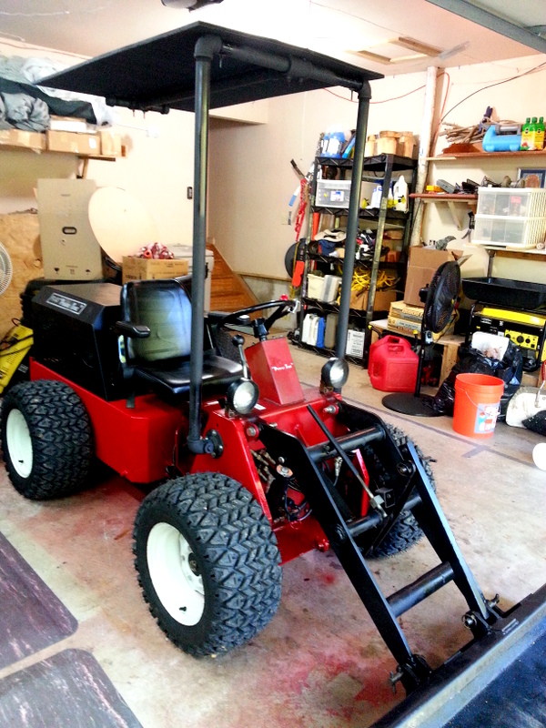

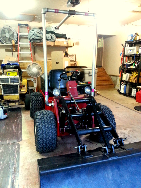

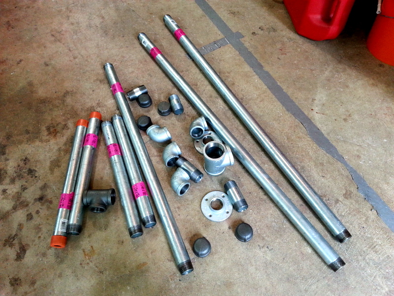

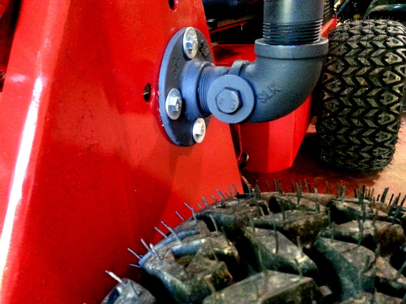

Got started on a Rop's for little Red. I may still buy the original PT Rop's in the spring but for now this will do..
I still have a more to do to it. But the basic's are there. I plan to put a frame around the sides along with a hard plastic top for water proofing. The top is 3/4 inch plywood and I'm sure it will take a hard hit no problem.. You really can't see it in these pictures but I added a T on the back tube to help stabilize the top.
I made it about 7 inches taller so I can get in and out without hitting my head on the top. And I may decide down the road to put in a suspension seat on. The frame is 1-1/4 galvanized steel pipe. I used Red locktight on all the threads along with pins so it is rock solid. I plan to buy some grade 8 bolts for around the flange next week.
Should be plenty of roll over protection and when I get done, should help keep the rain and branches off of my head. Priced a new one at $687.00 delivered. So I saved myself some change around $300.00 doing it myself. Good enough for my old tractor anyway.
I have a new set of lights for the bottom and will be ordering a brighter set for the top. So now I've got a place to mount the lights and a fire extinguisher. ;)

   / Members home made attachments / improvements #276
As a sunshade frame that looks great but I've never seen a ROPS fabricated with black pipe and I wonder if it is engineered to withstand a roll over. It looks tall and thin for a ROPS.
#277
Going by measurements given to me on the forum.. It's only 7 inches taller than the original by design. I could have went with the 2 inch pipe but the 1-1/4 inch piping has very thick steel walls.
The pipes are plenty strong the only part I might question is the cast flange but IF they gave way on one side. I feel it would still stop the tractor from roll over. Who knows by spring I may decide to get the original. This will do for now and keep the snow and rain off of me through the winter.
I'm a pretty good judge, after drilling through it and working with it.. I'm more than confident it will protect against a roll over. The Pt only weighs in at 1300 pounds even with 600 pounds of rocks in the bucket I would feel safe.. The tractor is also low to the ground.. Now if I had a taller heaver tractor .. I would have went with something heavier duty... ;)
   / Members home made attachments / improvements #278
I agree it will prevent a roll over but while a normal size ROPS can do that and survive, I'm thinking yours is a one timer. Much, much better than no ROPS and as you know how to build them you could just make another if it is damaged.
#279
Yeah .... It feels plenty sturdy I'm not too worried .. I'm really more concerned about rain snow or a large tree branch coming down and hitting me in the head this will take care of that fine.
I'll probably just use this one through the winter and get the real deal this spring. Money's a little tight right now working and putting it into house maintenance. Was trying to save a little..
