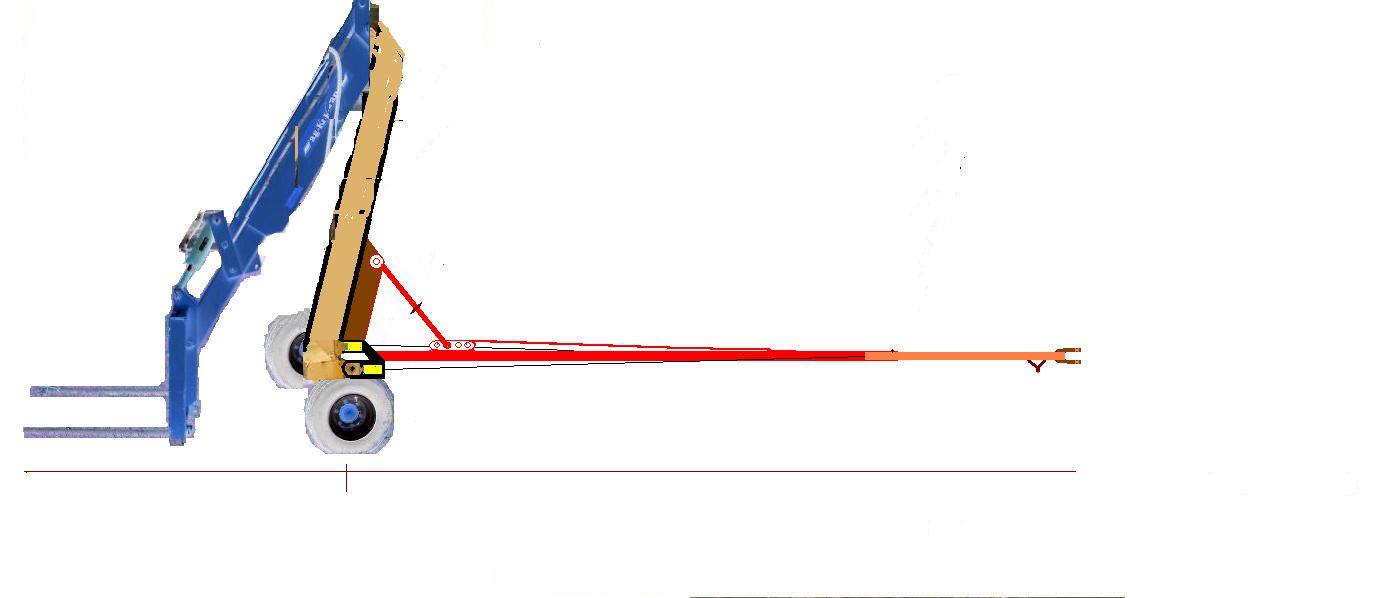

That Forkster looks interesting. I have often thought of making one much like it out of an old forklift front. But I came up with this thing first. Here is a crude drawing that might give you an idea of how I intend to design this ag lift thing. It will be designed to unhook and still readily hook up to a large tractor. The tongue may need to incorporate some kind of weight brackets. Also I only need to idiot proof this thing for me not the worlds public market. Thanks Guys for your interest, thoughts and ideas.

Stray - Way cool.
So, how good are you at pulling / pushing a trailer with your PT. Frankly I am terrible but my skill sets are not that of other peoples on this group. The whole tongue thing is what throws me.
Second, that is going to be a lot of force on that tongue.
Finally, the trailer idea fails for me because you cannot push the device into anything. I am not sure what you are picking up, but even when I am just grabbing up pallets of stuff I have to use some grunt to get the forks under (usually from being mis-aligned and lazy).
