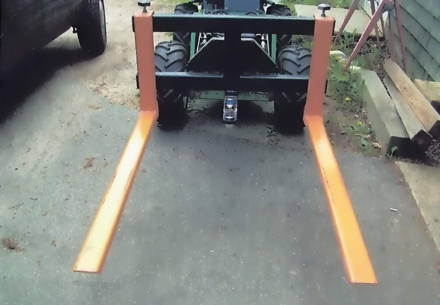

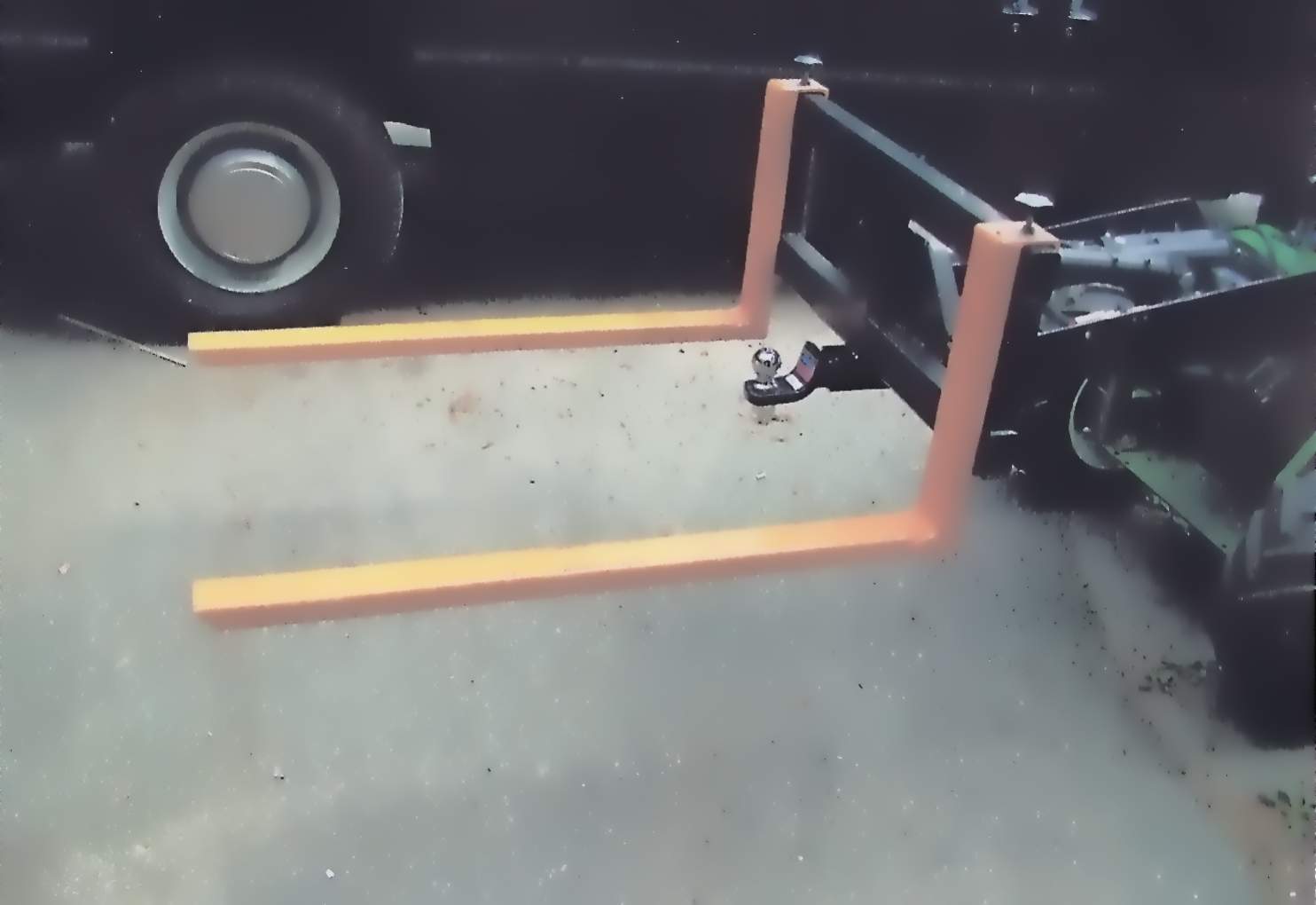

Here's a few pictures of a set of adjustable pallet forks I welded up.
The frame was welded up using 2x3" 0.125 wall tube. The forks are 1.5"x3"x 0.187 steel tube with 1/4" C-channel for the forks sliding and support brackets.. It was a fun and easy project.

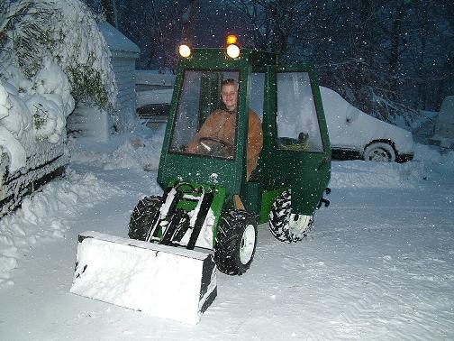

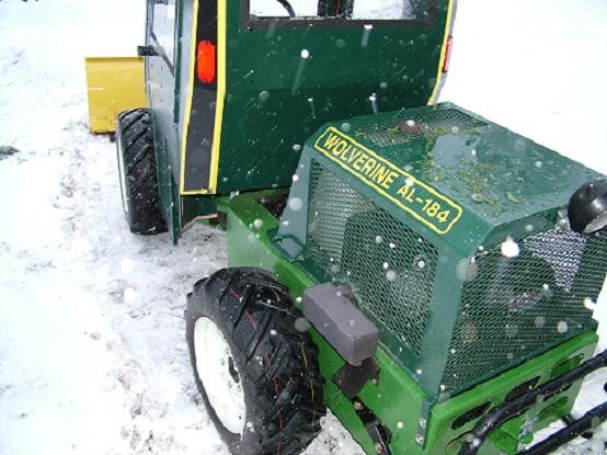

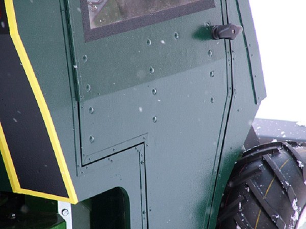

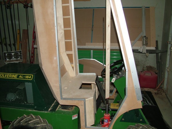

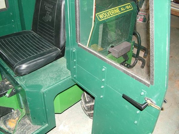

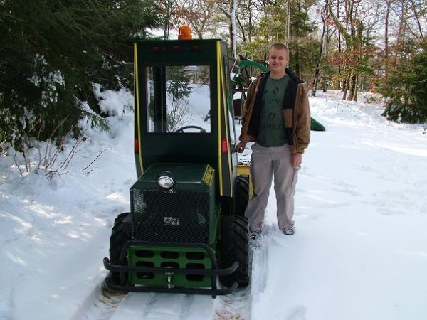

BRING ON THE SNOW !!

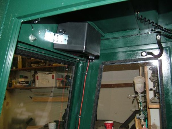

I hope not..... because I sold the PT a few years ago. The winter cap was a fun project.
It took a lot of head scratching to build, But I was happy with the results.

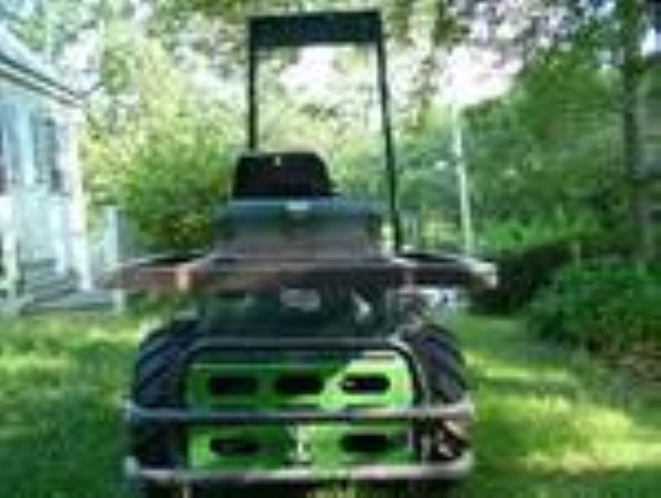

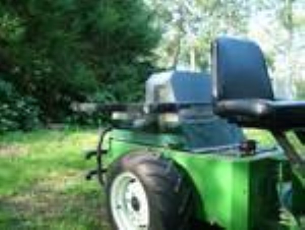

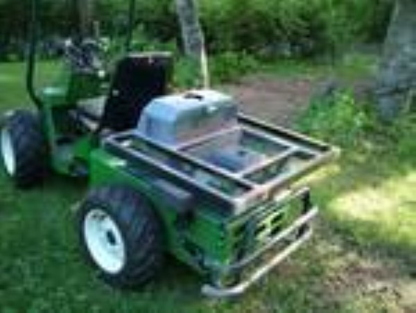

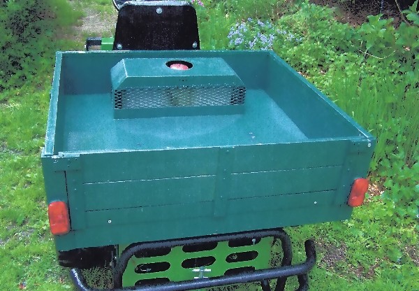

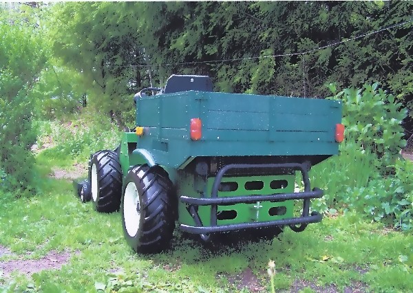

PT CARRYALL
While I'm on a roll....Here's another project from years past.
*** The picture resolution is not very good.

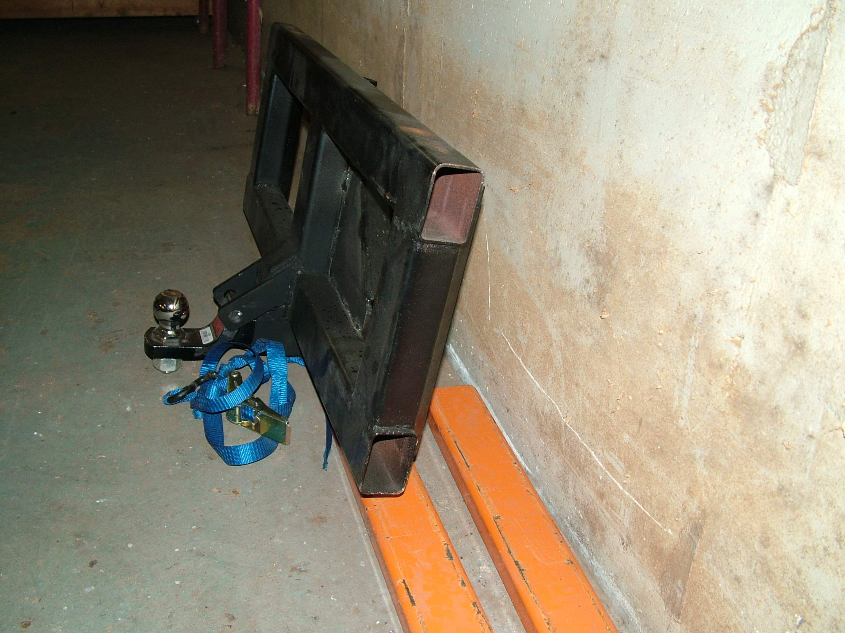

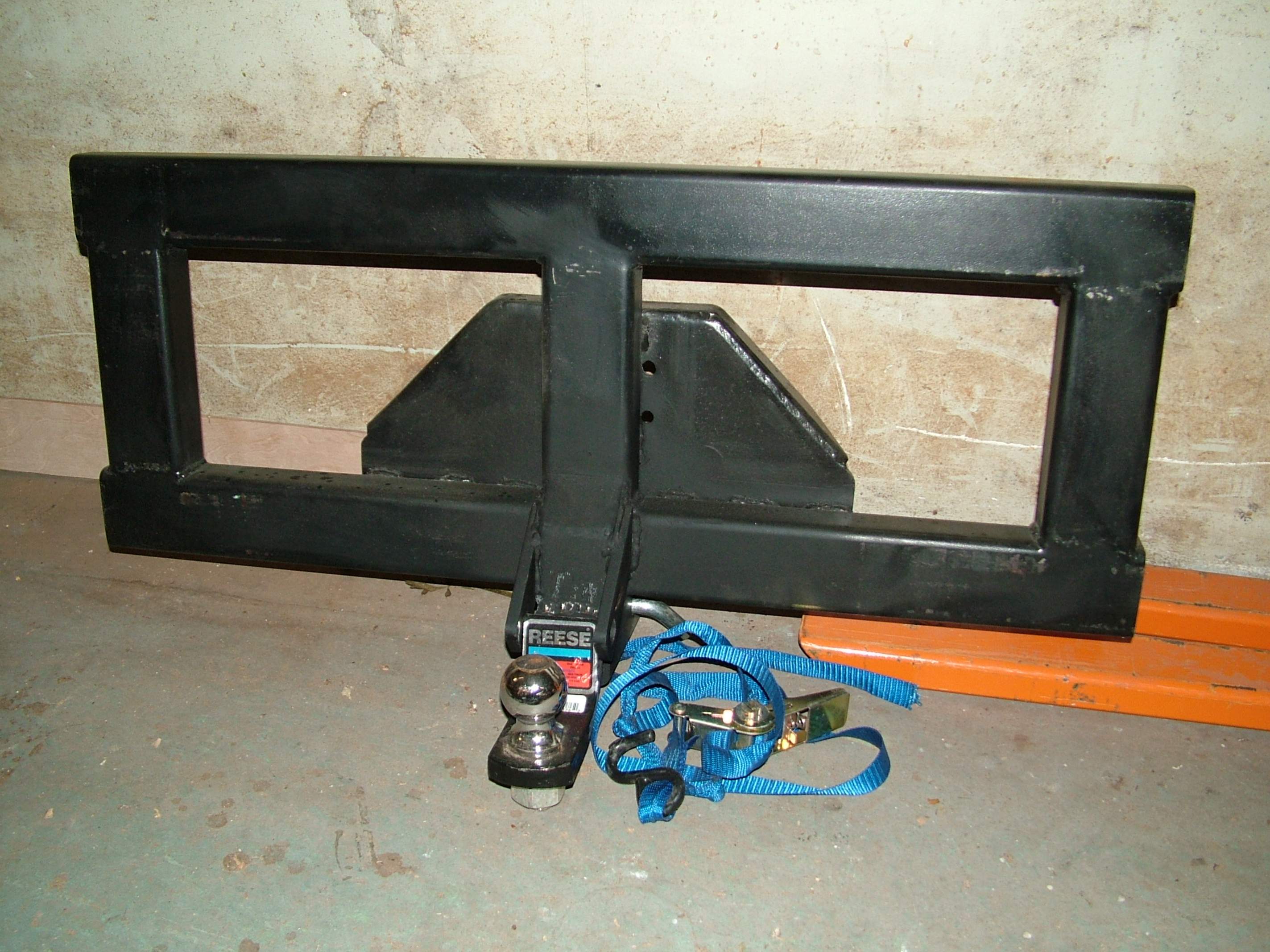

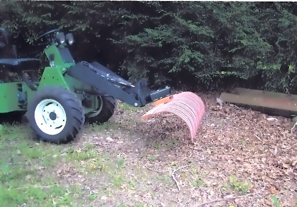

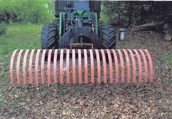

Here's a Quick attach mounting assembly I welded up for my York Rake.

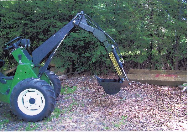

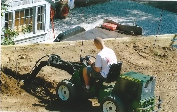

   / Members home made attachments / improvements #229

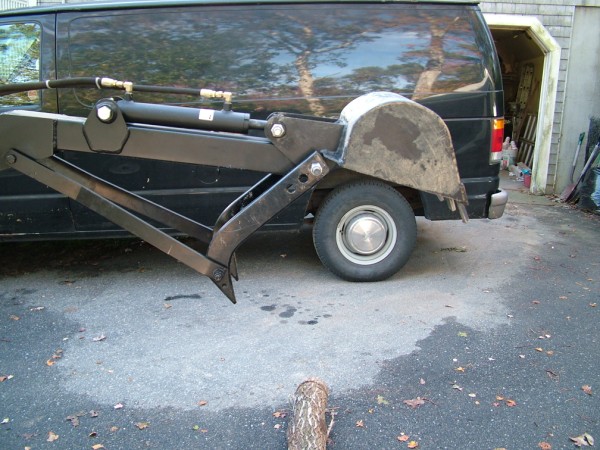

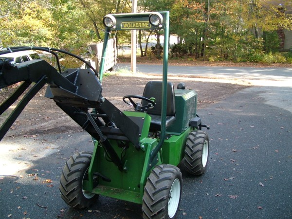

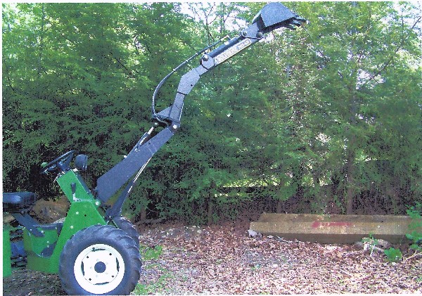

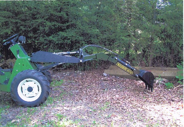

The Folks at PowerTrac said it could not be done.
It is possible to build and mount a MiniHoe on the PT180 !! :thumbsup:

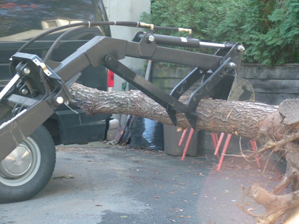

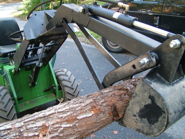

PT180 MINIHOE THUMB
Here's a simple light duty thumb attachment for my old 180 minihoe.
