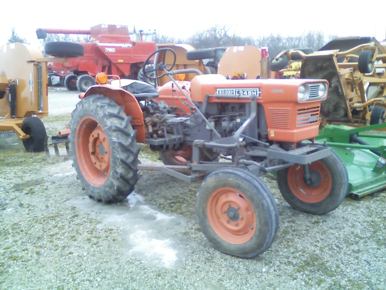

personally, my favorite cultivating tractors are the high wheeled kubota's we have two of them with mid mounted toolbars. one always has the basket weeder and the other has sweeps that we can constantly adjust if need be. here is the website and there are some pics of the machines. greenviewfarmri.com

I like the offset - similar to a Farmall Cub?
Thanks for the link!

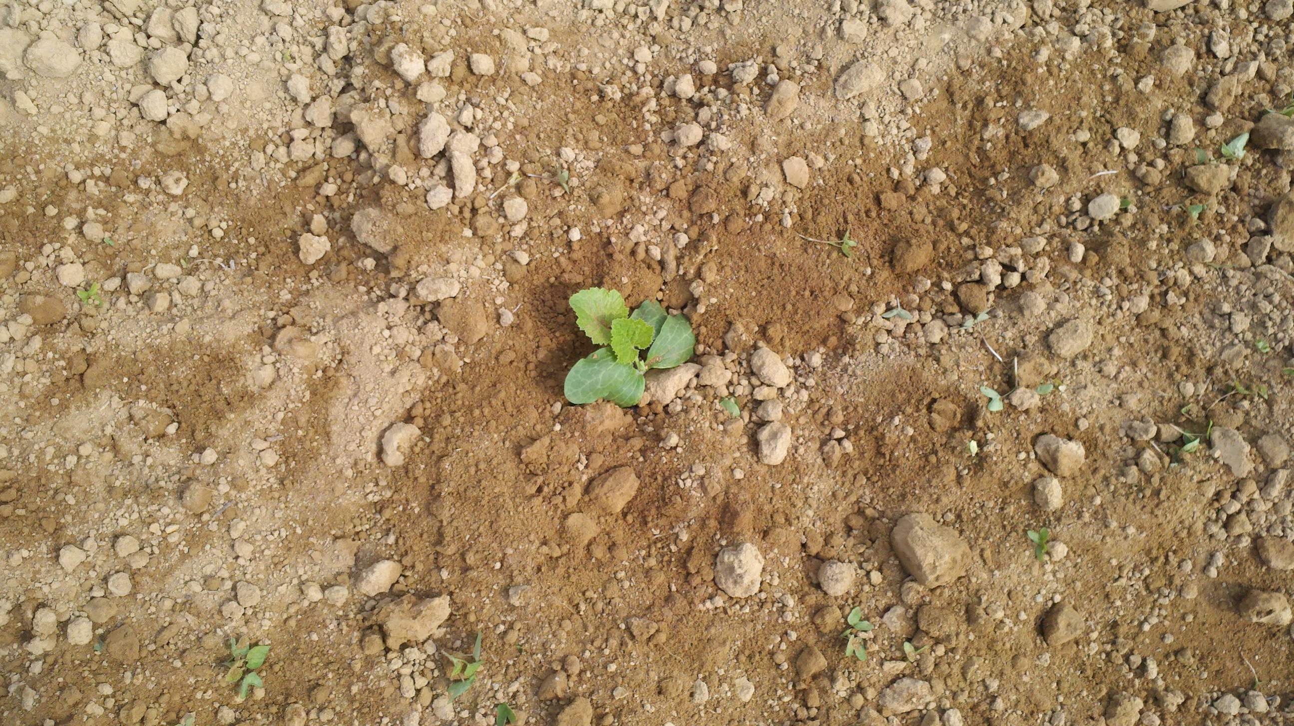

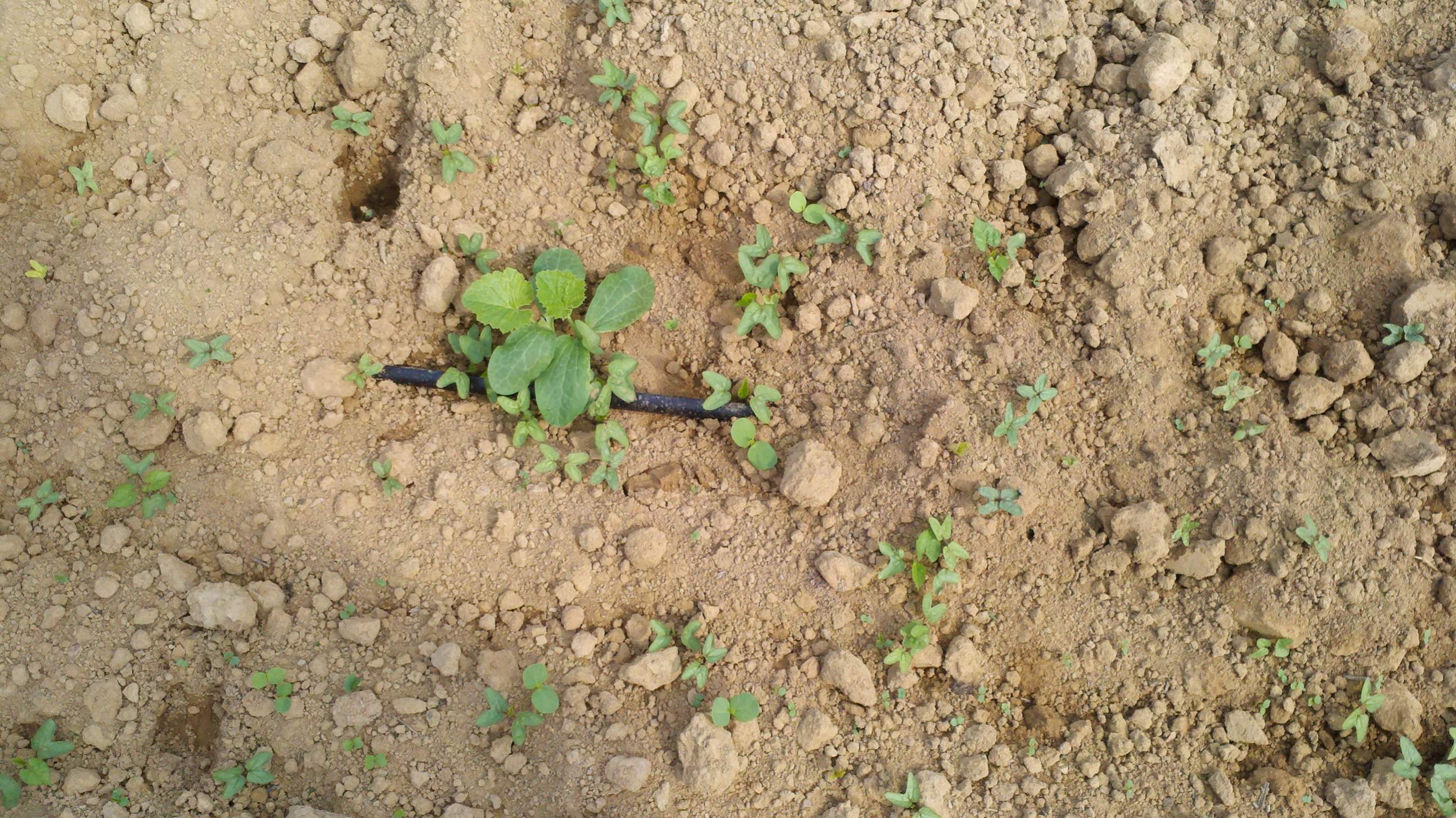

Here are some pictures of the result of manual cultivation.
The first one is of my 83 year old grandfather on his Farmall 140 cultivating sweet corn.

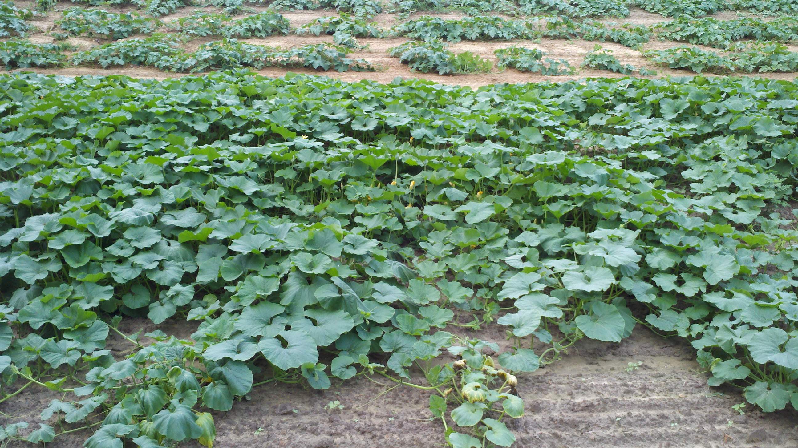

I have also included some pictures of the pumpkins that we are currently growing.
There is a before and after picture of a pumpkin plant and morning glories. I manually cultivated with a hoe. Then plowed with my Farmall 140.
They key to cultivation is to do it often and when the weeds are small. Then to cultivate just before the crop gets too big. I cultivated these pumpkins when they were just starting to run and the vines covered the ground before the weeds could germinate again.
I do plant Round-up ready field corn. The season is too long and the weeds have too much of an opportunity to come up in cultivated corn that is left to dry in the field. JMO

yes, they are high wheeled and offset for better visibility.
