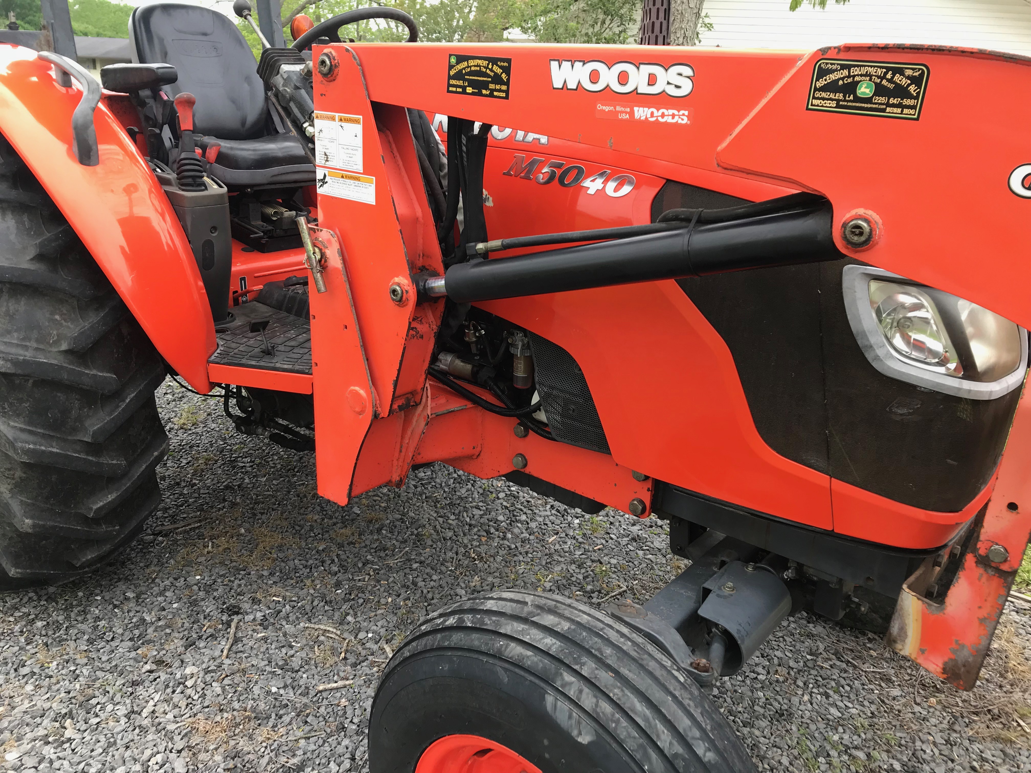

maybe upgrading from a M5040 to a M7060 cab
/ maybe upgrading from a M5040 to a M7060 cab #21
You'll like the M7060. I've found that mine gets a good bit better fuel economy then the MX5100. I'm sure it's a combination of more efficient tractor and doubling the cutting width from 6' to 12'. I love the A/C, quieter operation, & radio!
