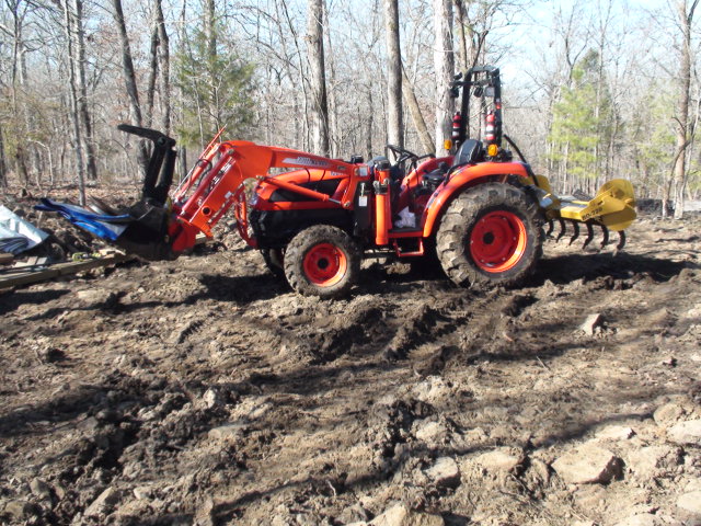

My tractor as configured weighs ~ 7500 pounds, has 45 HP and a 710# rollover box blade. My heavy clay, rocky soil is not hardly touched by the box blade unless I break it up first with the scarifiers. Same thing goes for the bucket with a tooth bar added.
