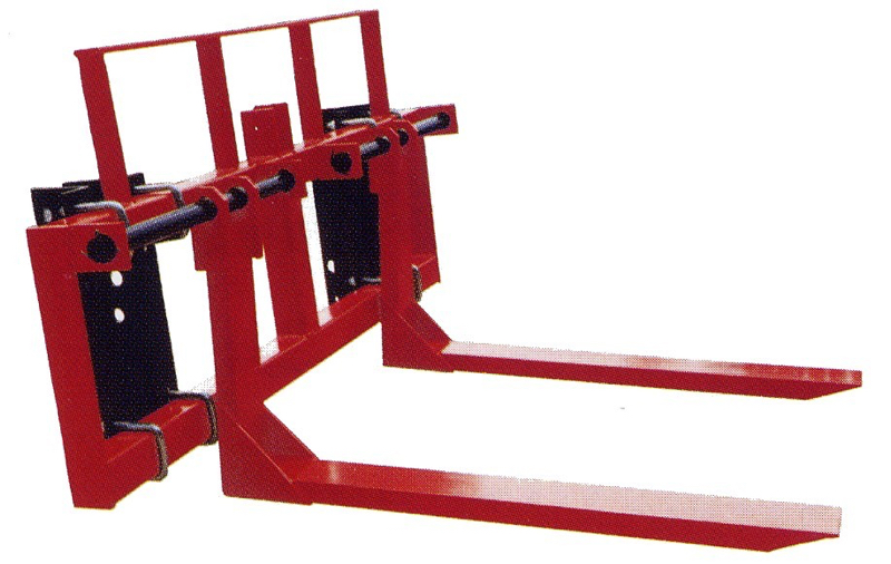

I still haven't been able to find these forks, except for this picture. Anyone know anything about them? They look like they adjust for different loaders and pin on and also mount to the three point hitch.
I did a google picture matching search and they showed up several places, here is one: Paladin Attachments - Pallet-Forks
/ Max 28 XL Loader Quick Attach? #22
Be careful with some of these, concerning weight. Our smaller tractors, although stronger than some others, are still limited in the fel lift capacity. I couldn't find the weight of that paladin forkset but it looks like it might be heavy.
I recently took delivery of these:
Titan 46" Pallet Fork Attachment Skid Steer Quick Attach Mount 26�� lb Capacity
229 lbs, not much different than the weight of my bucket, very inexpensive and very well made.
you can read my review on the link.
eta:
oops, sorry, I just noticed you needed a pin on set. The weight issue still applies.
Maybe this would work. A lot less than what your dealer wanted. There are a couple others on the site as well.
Pin On to Skid Steer Quick Attach Adapter w/ Spacer Brackets
then you could get the forks I listed !
