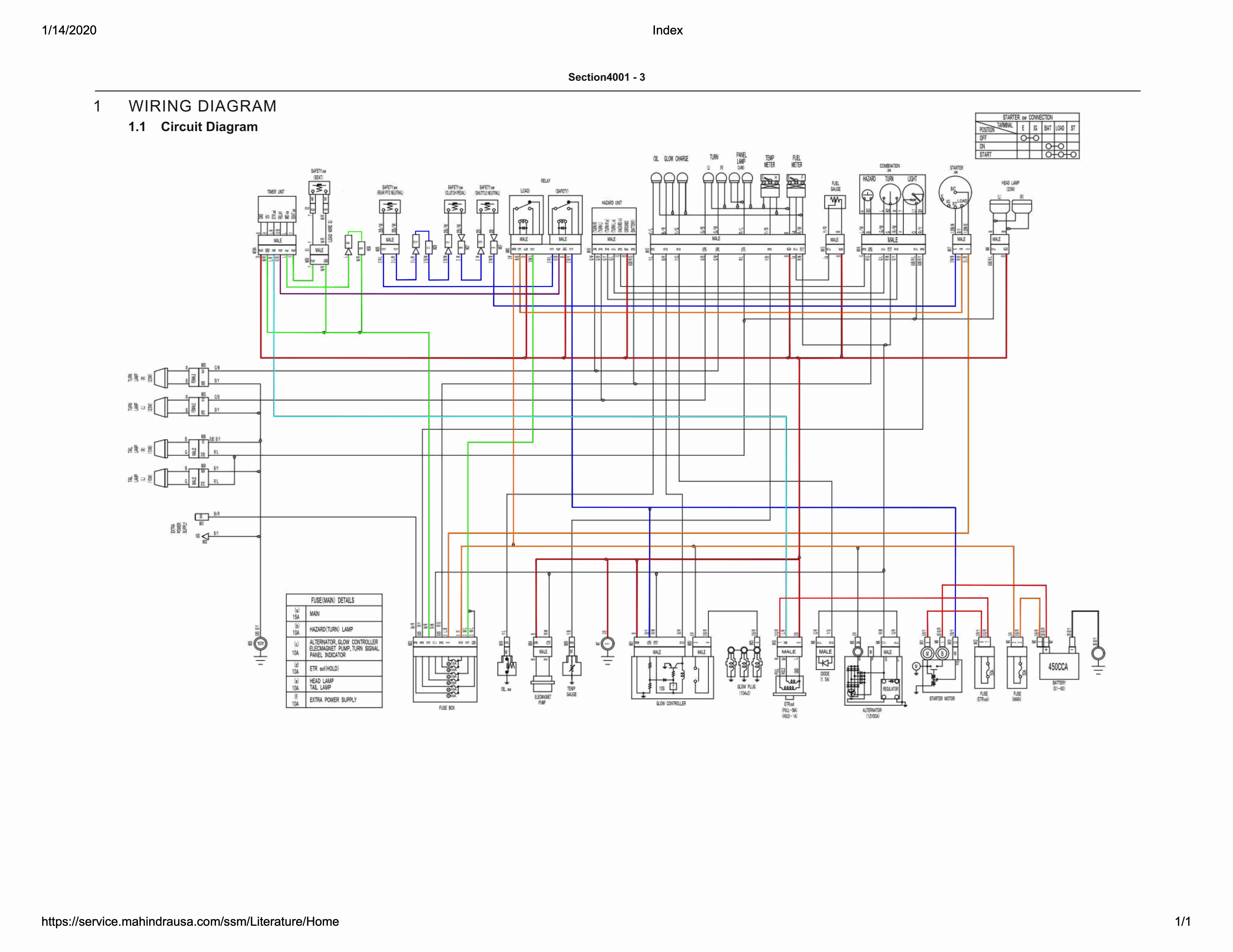

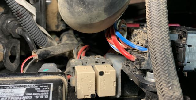

You very well might be correct. However, looking at the diagram you posted it appears to have a safety relay. There is two relays next to each other on the diagram, one for load the other for safety. Have you tried swapping these? They may be easier to find. If the safety relay is bad, swapping would allow starter to work.
I am wondering if on some models they did not use the timer. Another thing to check, if you haven't already, is the fuses.
The reason I keep questioning the timer is those timer relay units are fairly common on many things but rarely give problems.

I've installed new new Load and Safety Relays to eliminate them as potential issues.

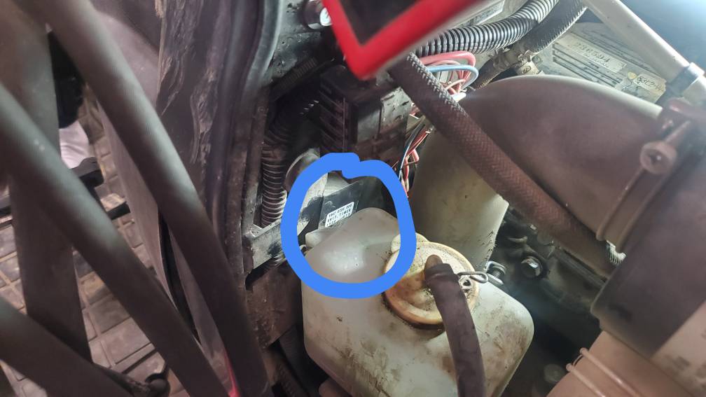

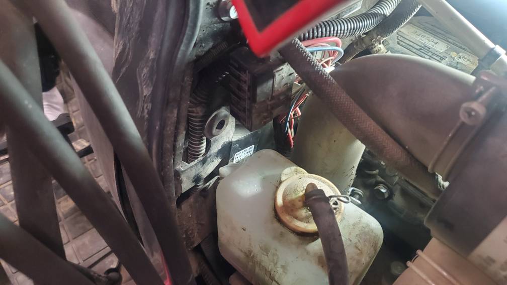

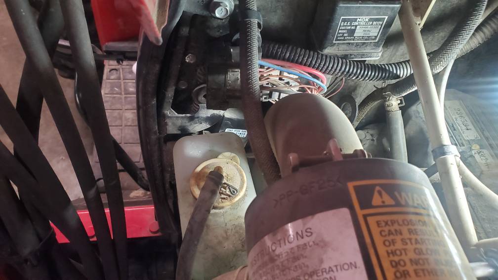

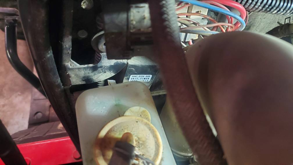

   / Max 26xl just stopped while I was driving... #37
On my Max 26xl. You can even see the part number on the unit. 20200201_114307.jpeg20200201_114323.jpeg20200201_114513.jpeg20200201_114513~2.jpeg

   / Max 26xl just stopped while I was driving... #40
Maybe the mechanics didn't reinstall it in the correct position when they reassembled the tractor. It should be somewhere nearby. I can't imagine that the wiring harness would let it be very far from the original location.
