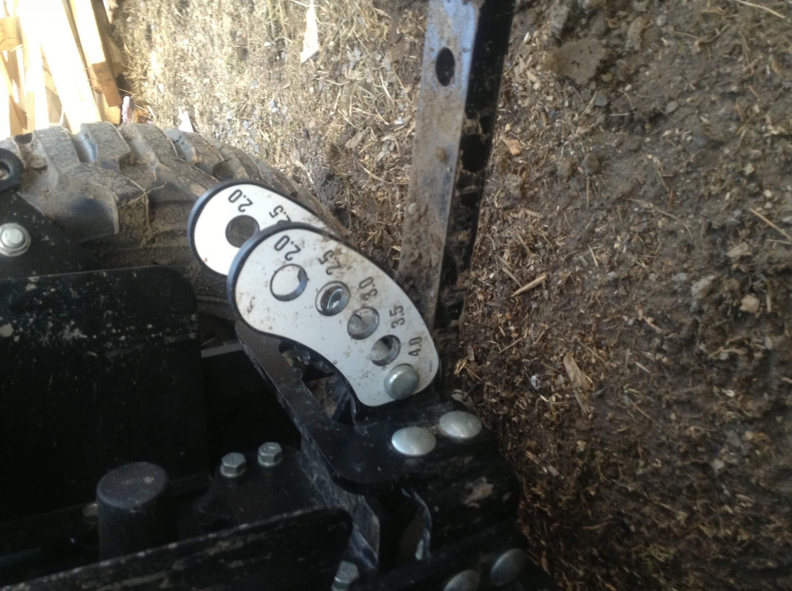

I've had my mmm on and off dozens of times and have (had) it down pretty good. The problem as stated in my original post is that there is no height adjustment bracketry anymore as it was replaced with a different drawbar and bracketry for the BH.
For those that have both: (roughcut,robio11,jimpen) Can you post a picture of your drawbar and height adjustment setup? Do you still have the upcurved bracket and height pin type drawbar? What is there that the mmm rear tension rod links to that will raise and lower it?
I always remove my FEL (as I also will also the BH) when I mow so I don't care about that. I only ever mow my grass in the top (fully raised position) anyway but the mower has to attach at the rear somehow.

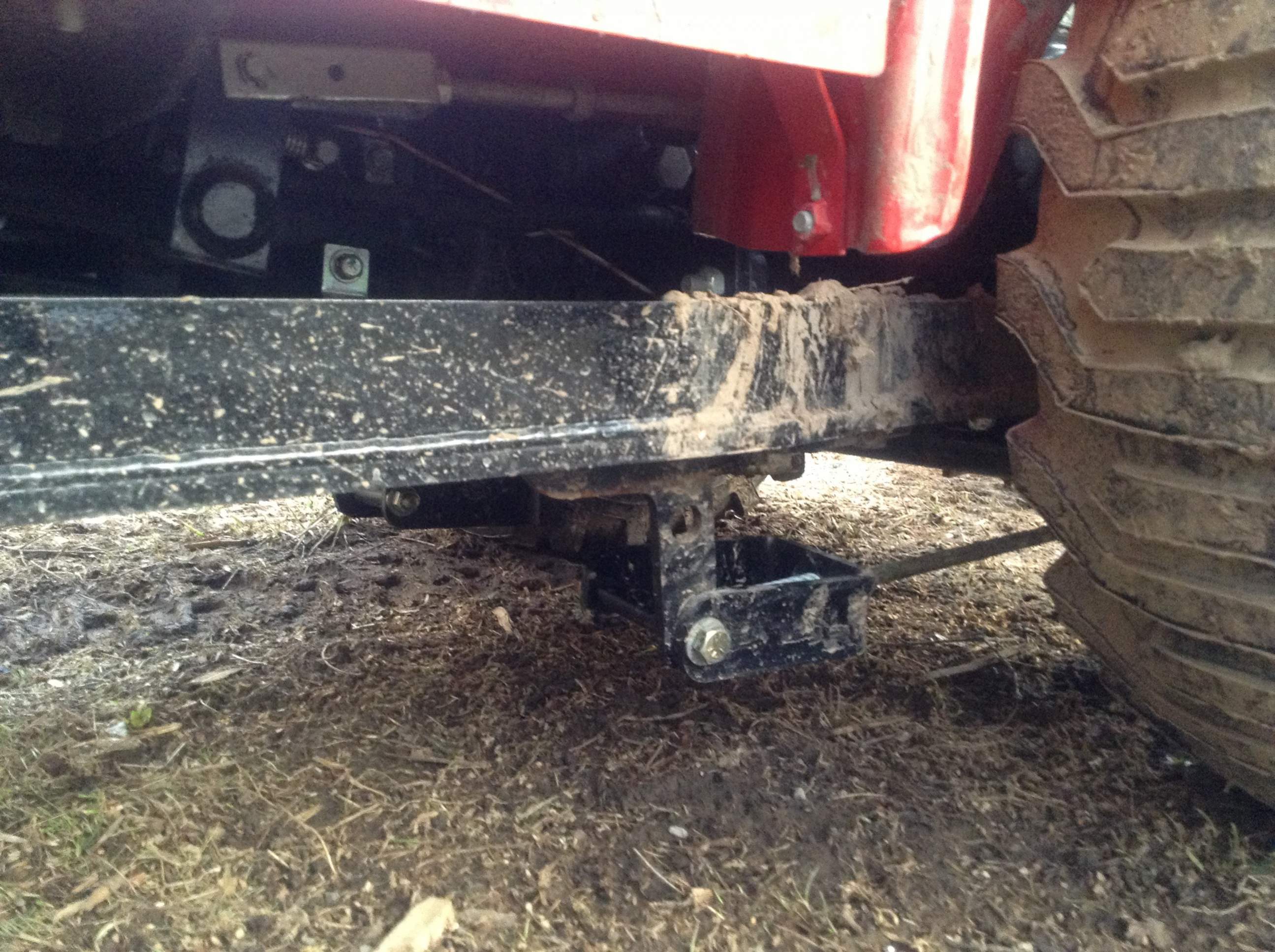

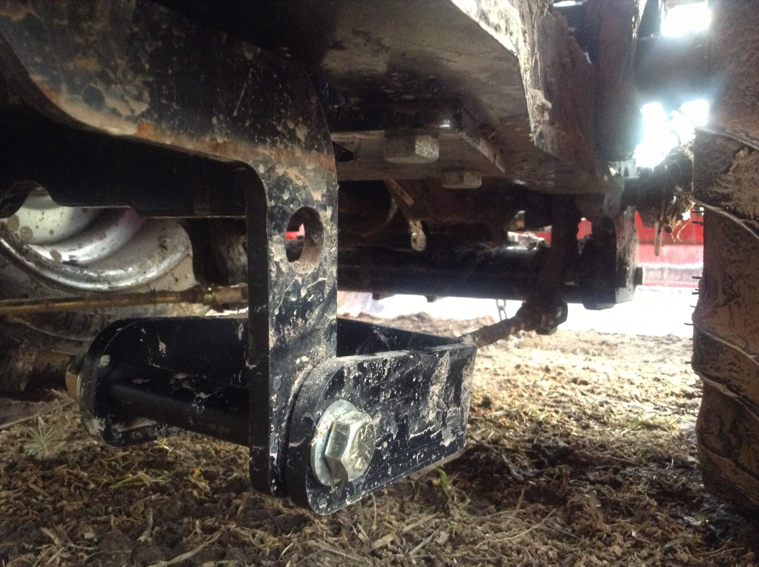

No. Its a dealer installed Mahindra MB60 backhoe with the quick attach. Its not the mounting of the backhoe that's the issue. That all works well. It's that I have nothing to attach the tension/height adjust rods for the MMM to anymore. I will post pictures.
/ Max 25/28 MMM with backhoe subrame? #14
here are the pics

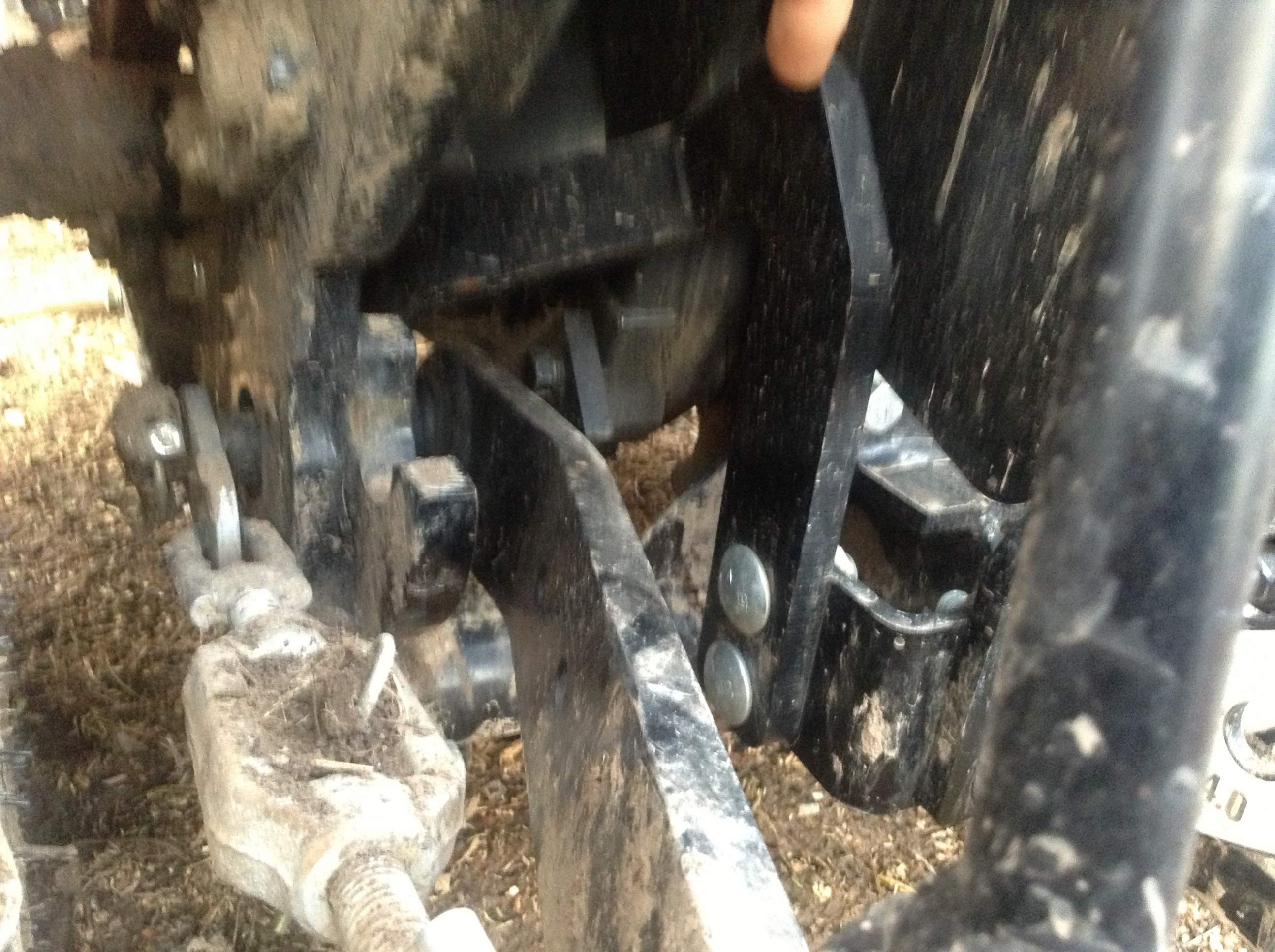

/ Max 25/28 MMM with backhoe subrame? #15
My finger is pointing to lift assy attached to the rods
#16
Most excellent! Thank you for the pictures Robbieo11. That is definitely helpful!
That is definitely not what I got back after the backhoe install. In conclusion: All the hardware for the MMM in the rear was removed when they installed the subframe for the BH- back to like how it would be if I never had a mower without all of the lift assy brackets you are pointing to and height pin bracket. All that stuff in a pile of parts in a bucket handed back to me. In hind-sight, I'm not really sure why it was removed. Perhaps it just didn't make sense to the technician how it went together when the subframe was installed and therefore left it off.:duh:

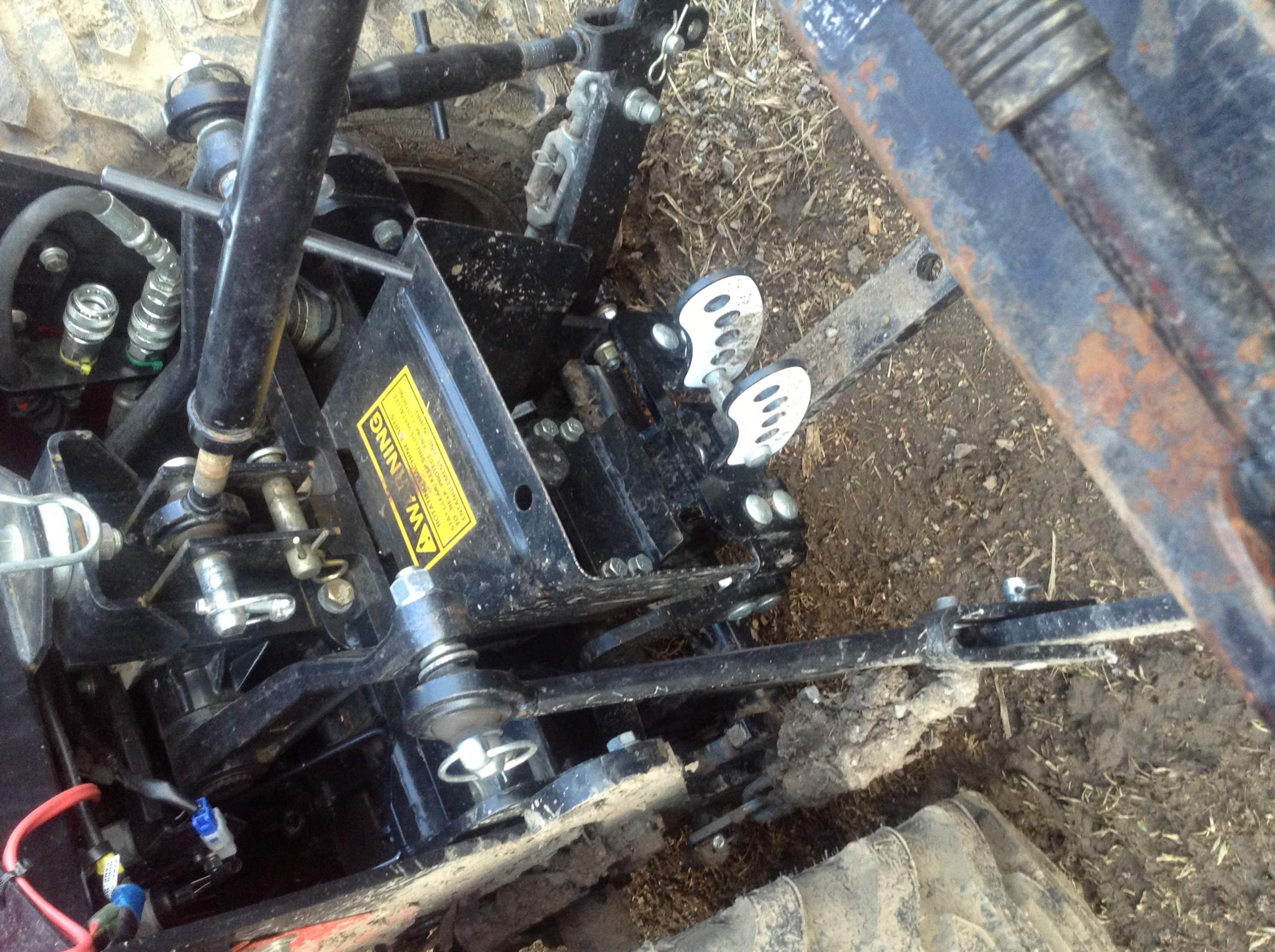

I'm a little "puzzled" how it will all fit on there with the new receiver hitch and the lower 3-pint arm, but I guess I will tackle trying to figure it out myself. The lower 3-point arm is in the way when the BH is installed so it has to be raised out of the way. So those two vertical braces that connect the upper and lower 3-point arms, are removed and the lower 3-point arm is connected to the upper lift arm by the anti-sway chain instead of the two braces. Is that the correct configuration when you want to install the BH? That is how it was configured when I received it back from the dealer.

No. If you have the BH mounted, technically you are supposed to pull the drawbar and then the turnbuckles go along the base of the BH subframe.
Once you drop the BH then you are supposed to put the 3PH arms on, remount the drawbar and reroute the turnbuckles as well. I just hang the turnbuckles from the top lifters and then use the MMM.

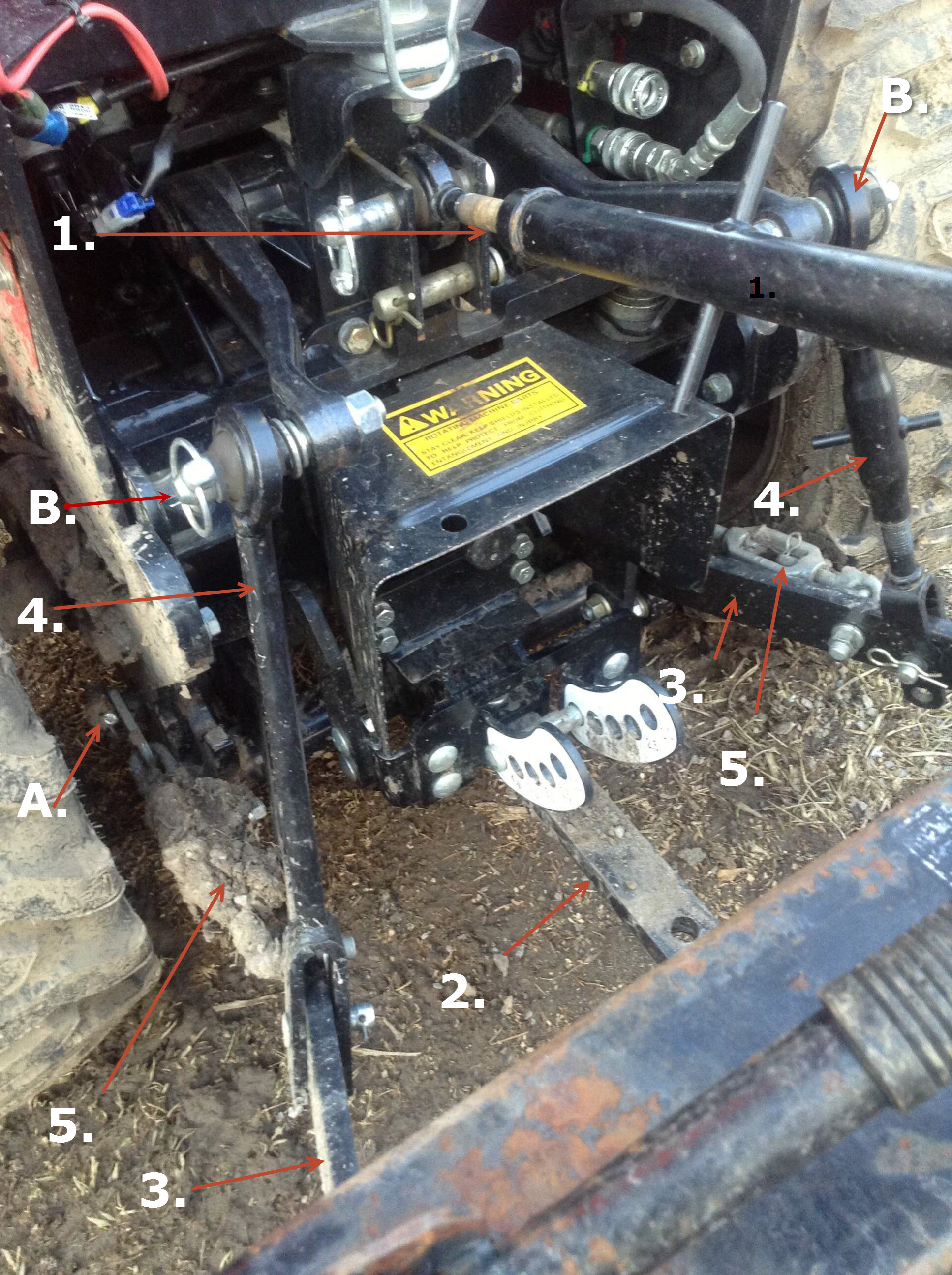

I find it odd there are differences you guys are stating that is to be removed and configured. This is how I understand it according to photo (Courtesy of Robbieo11).
Tractor Configuration:
1. Top 3-pt turnbuckle- Removed completely
2. Drawbar (hitch)- Removed completely
3. Lower 3-pt arms- Fixed (not removable).
4. 3-point connector arms- Removed completely.
5. Anti-sway turnbuckles- Detached from point A. and attached to point B. 3-Pt is then raised to highest position.
Connect to Backhoe:
